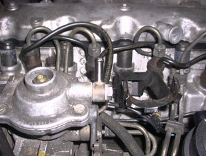

Where does the connection to the boost input on top of the injection pump come from (XUD9TE engine, bosch pump)? Anywhere in the pipe between the turbo output and the intercooler, or the intercooler and the inlet manifold, or before the turbo (I presume not).
Here's a pic of the spigot in question (just about in the middle of this pic)

The pipe you show is on the extra fuel device on the pump, the purpose of which is to increase the fuelling in response to boost pressure. Without it the engine gets no benefit from the boost as the turbo is simply pumping loads of air into the engine and the fuel is the same as for no boost.
On my BX TD (Roto-diesel pump) the pipe runs to the front of the intercooler (looking at the engine - its on top). I suppose the pressure can be sensed anywhere between the turbo and the engine, certainly not elsewhere.

The pipe needs to be connected to the pressurised side of the inlet, anywhere after the compressor will be fine, the line is also where your boost gauge needs plumbing in.

if you use the xant manifold but not the hoses, you will need to tap the manifold and put screw tail in there to get a pressure feed for the pump. You could also put a feed anywhere in one of the post-turbo hoses. A little advice though, when you do put the boost guage feed onto the manifold, at idle or small throttle (ie no boost) the guage flickers like mad and rattles annoyingly (like mine!)

I dont think Wookey is talking about fitting a boost guage, more where the pipe is meant to go to/from!
The input you have runs through a pipe about 8 inches long and attaches to the plastic pipe that comes up from the turbo to the RHS of the intercooler (looking from front of the car). Again i'll try finding the picture in a minute or get some at the weekend!

Ah Ha
Right this time where interested in the Pink Circle!
The BIG plastic pipe funs accross the front of the engine to the intercooler. The rubber pipe coming off it runs to the fuel advance. Under that cap is a diaphram that adjusts the fuel added!
Lying on the top of mine is a random un connected pipe. Wookey please ignor ethis, it was the original fuel return pipe for the NA diesel engine, but i used the Xantia ones in the end!
