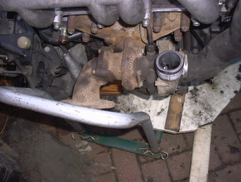

This one shows the back of my engine:
As you can see it's all the opposite way round and the turbo-to-exhaust piece is completely different. I have no idea if the end ends up in the same place and the TD downpipe will fit. It's 50 quid for one so I could certainly try it.

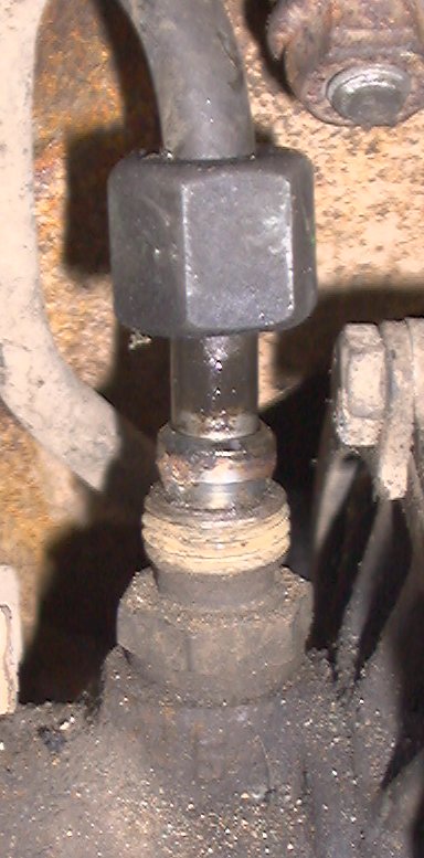

Whilst on the subject of turbos - the oil return pipe has a funky union thing (7 on the above diag). The pipe going into this nut is quite loose, and leaking oil. It remains loose when I screw down the union nut quite hard. That almost certainly isn't right, but I'm not sure if its the pipe or the union that is knackered or if I have a seal missing. Again - here's a pic - you can see where to oil is getting out and that the bit the pipe goes into looks a bit flared - do you think that's been bent and should be snug?
Any clues? Now I've seen the assembly diag it makes more sense and I suppose I should just try disassembling it.

The leaking pipe/union is the feed from an oil gallery into the turbo. The connector in diagram V 06/97 ZN 03L10A which has the number 7 should be tight with the seal number 8 stopping it from leaking.
I have encountered a leak like this before on turbo charged vehicles, and have had to replace components numbered 6,7,8,& 9.
I have found the seals damaged (no 8), the pipe can get damaged (no 6) the pipe actually has an olive on it, and that can get damaged.
Note, on the same diagram it shows "P" clips, one has a number 15 and the pipe has to be secure to prevent leaks.
Pipe 4 on this diagram is the return oil feed to the sump.
The leak appears to be O.K. from the picture.
It's a high pressure feed, and if it were leaking badly then the oil would spray everywhere.

The triangular bit that bolts the turbo to the block apears to be upside down on the Expert Block.
If we assume that the turbo mounts in about the same position, then the exhaust outlet is in a very similar location. Have you actually tried fiting the engine into the bay yet? It sounds like you might have been doing a lot of choping and changing to get the engine to exactly match what the Pug is supposedly meant to have! Given PSA make pretty universal engine bays i'd suggest you try actually fitting the engine in before worrying that something isnt quite right.
To me the oil feed pipe looks pretty clean in that picture. SOME residue is perfectly fine and acceptable, if there was a problem it would more than likely gush rather than trickle.

Sorry, I thought you had meant that the turbo was the wrong way round on the xantia engine you had bought! My mistake. You have to wonder why then that the same turbo is fitted in a different configuration on the master? If is for clearance issues then you might have to get the right 'master' manifold (like in your pic) and downpipe and install it the way it should be. As vanny says, I wouldnt look too much further into this and go buying things untill the engine is being fitted. At a guess, I would reckon that the turbo is mounted that way to allow all the air pipes, to and from, to be routed on the left of the engine as you look at it. That would mean none of this silly 180deg bends in the inlet hoses just before going into the turbo that all the zx/xan/405 have as standard, a very restrictive design.
Theres nothing you can actually do about the welds inside the exhaust. Just try and make each section that you weld as flush as possible to keep the weld from seeping through too much. The weld itself will rust slower than the rest of the exhaust, the problem is where the bumps in the weld make nice little holes and pools for rust worms to live!
PS. dont be tempted to use the n/a manifold which is easier to get hoses around. I did this and popped two of them. They look sturdy enough, but arent.

OK. I understand now. In fact it is the exhaust manifold (and oil pipes and turbo-to-exhaust pipe) that change - the turbo is indeed the same model. As vanny says 'the triangle is upside down' is the bit that gives it away. I had managed to confuse myself on this point earlier.

Presumably PSA had a good reason for fitting the different turbo layout with all the parts sourcing and manufacturing difficulties this brings - particularly from the point of view of the turbo outlet that appears to point downwards. Your best bet might be to contact one of the turbo overhaul companies and see if you can exchange your Xantia unit for an appropriate Expert unit - this will get you out of both the non-standard exhaust and air trunking problems. Might cost though!
Wookey
- (Donor 2019)
- Posts: 258
- Joined: 28 Dec 2004, 08:43
- x 12
I think the layout is just more sensible this way round (for a front-mounted intercooler and nearside-mouted air filter). The turbo itself is not a problem - it it's the manifolds before and after it (and the oild feed and return). Turns out that on a boxer the NA and turbo manifolds are the same - it's just the expert where they are different. I can get the correct manifold from any boxer or a TD expert. But not from 806/synergie/ulysse as they all(?) have an extra EGR spigot, which implies a whole load of other bits I haven't got.
I am inclined to think that my life will be made a lot easier by getting the right manifold so I can use standard bits. I just have to find a suitable donor vehicle, but they aren't particularly common. Good job I'm not in _too_ much of a hurry. I think I'll just cash in the tax for Feb....
