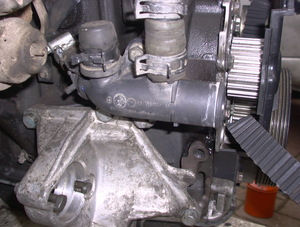

That's this bit (looking form the back of the engine)
The long pipe round the side of the car comes into the RH end. You need to be sure before going shopping whether the hose has split where it joins or this plastic thing has broken. Normally this plastic thing only breaks if it gets belted or crushed during engine removal.
To get access to this area to see what is going on, take the (offside front) wheel off, jack the car up, remove the trim behind the wheel and you should be able to see what's what quite well. Pour some water in the top and youll see where it comes out.
