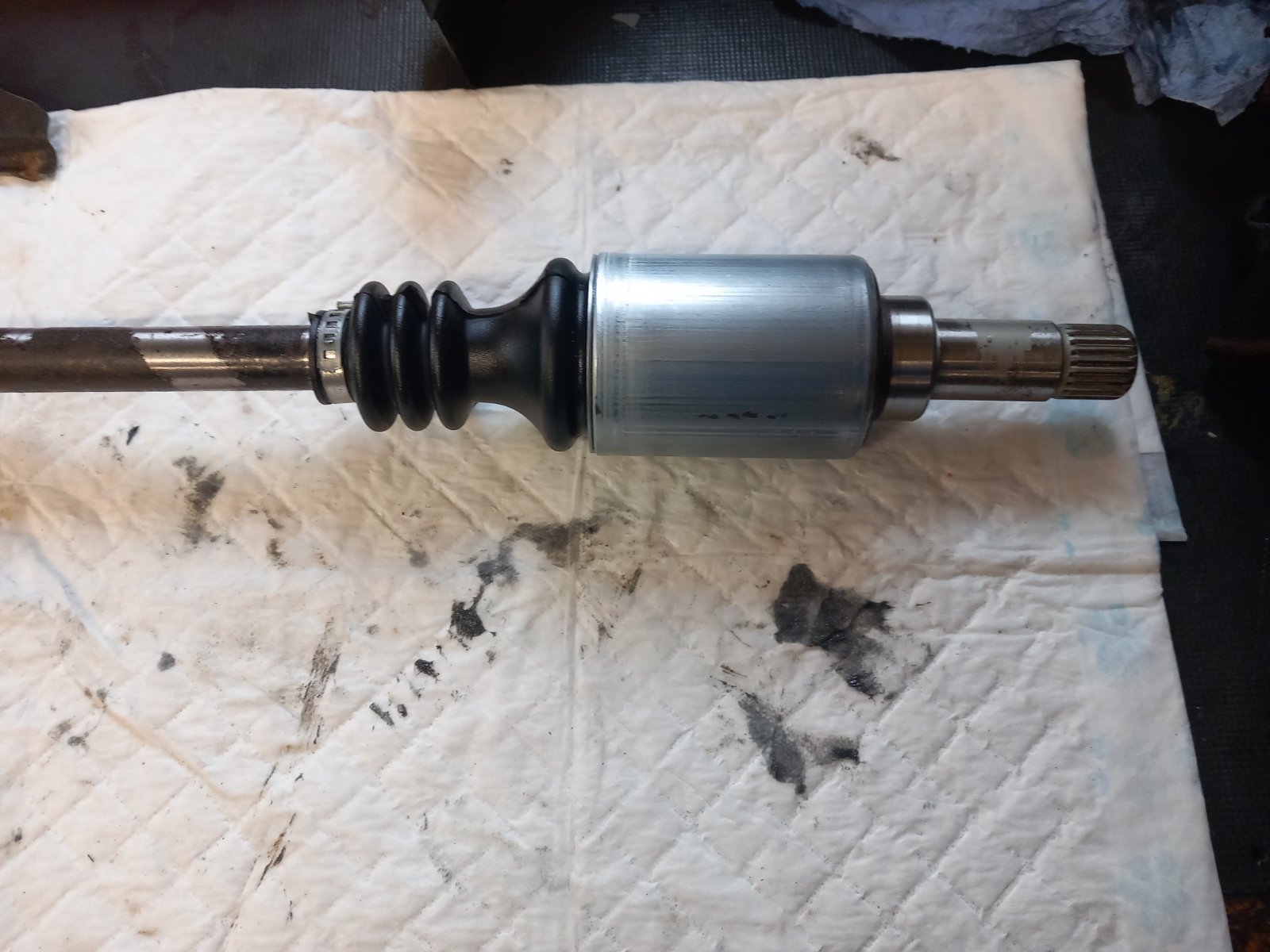

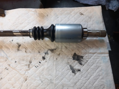

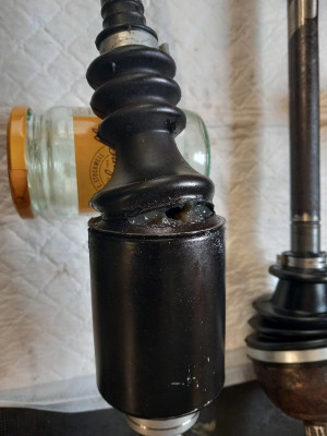

After parkrun and getting some domestic stuff done - always a load when I've been away for a few day, I could crack on with a bit of Strawberry flavoured activity
I've rebooted her spare driveshaft...
And all done with the end of the can peened over...
I've given the underside of the car a good clean and got rid of all the old grease that sprayed out of the old, damaged boot...
I'll swap driveshafts tomorrow after Junior parkrun...
It's good to be back playing cars again

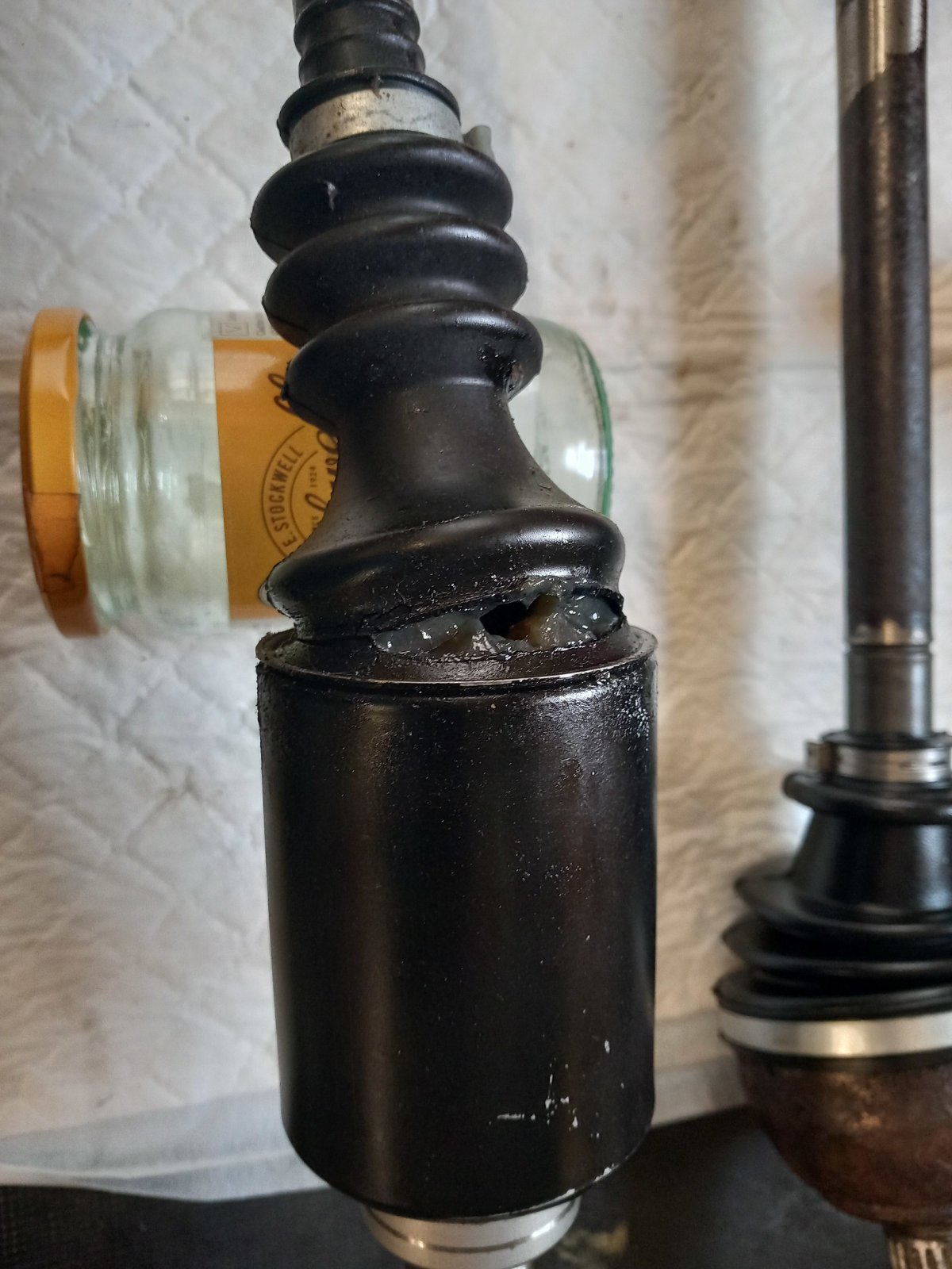

After a very noisy, lively and fun Junior parkrun I cracked on with replacing Strawberry's driveshaft
It's an easy enough job in an AX although the hub nut was biblically tight... An extended breaker bar was needed...
I carefully drained the gearbox oil as I guessed it was recent'ish as that driveshaft was not that old. It ran out perfectly clean and clear so I reused it...
Likewise, the shaft oil seal was not leaking and looked in fairy new condition so this time I felt no need to swap it...
The boot on the old driveshaft was well split!
Inserting the newly rebooted shaft I saw how this may have happened as if the shaft is not adequately supported, the inner joint can move to an extreme angle and stress the boot.

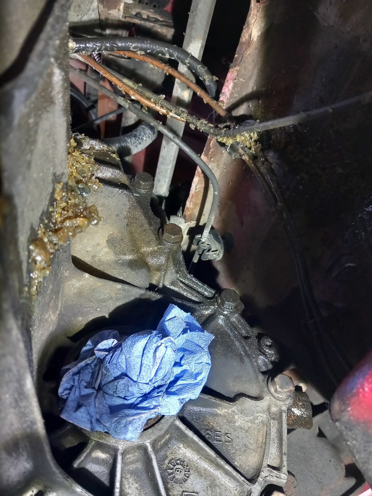

The split boot made a right old mess and some time was spent cleaning it up...

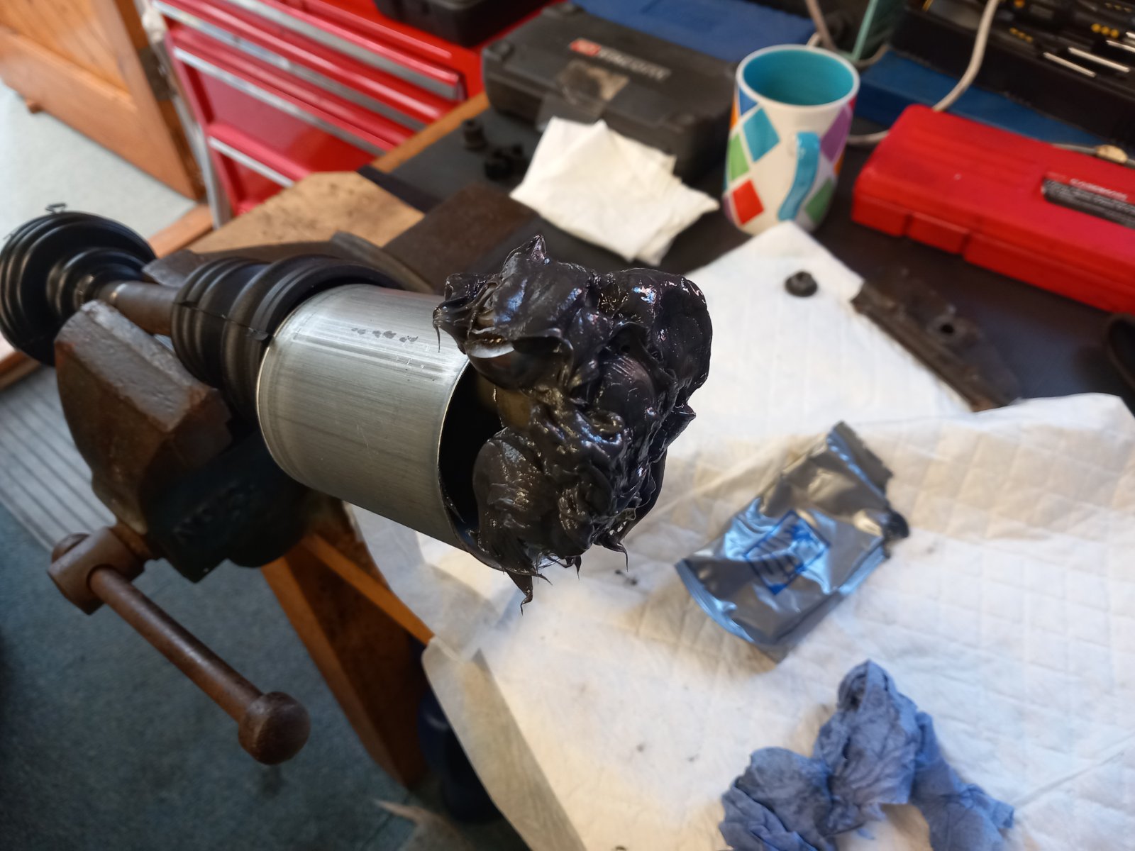

Interesting to note this joint was not filled with moly grease. Looks like just ordinary grease. Maybe a cheap bargain-basement driveshaft or a cheaply reconditioned one? Moly grease is essential in this sort of joint and if I refurbish this shaft I'll also check what grease is in the outer joint... I suspect the wrong stuff...
All seems good during a short test drive and automotive continence in all respects appears to have been restored
