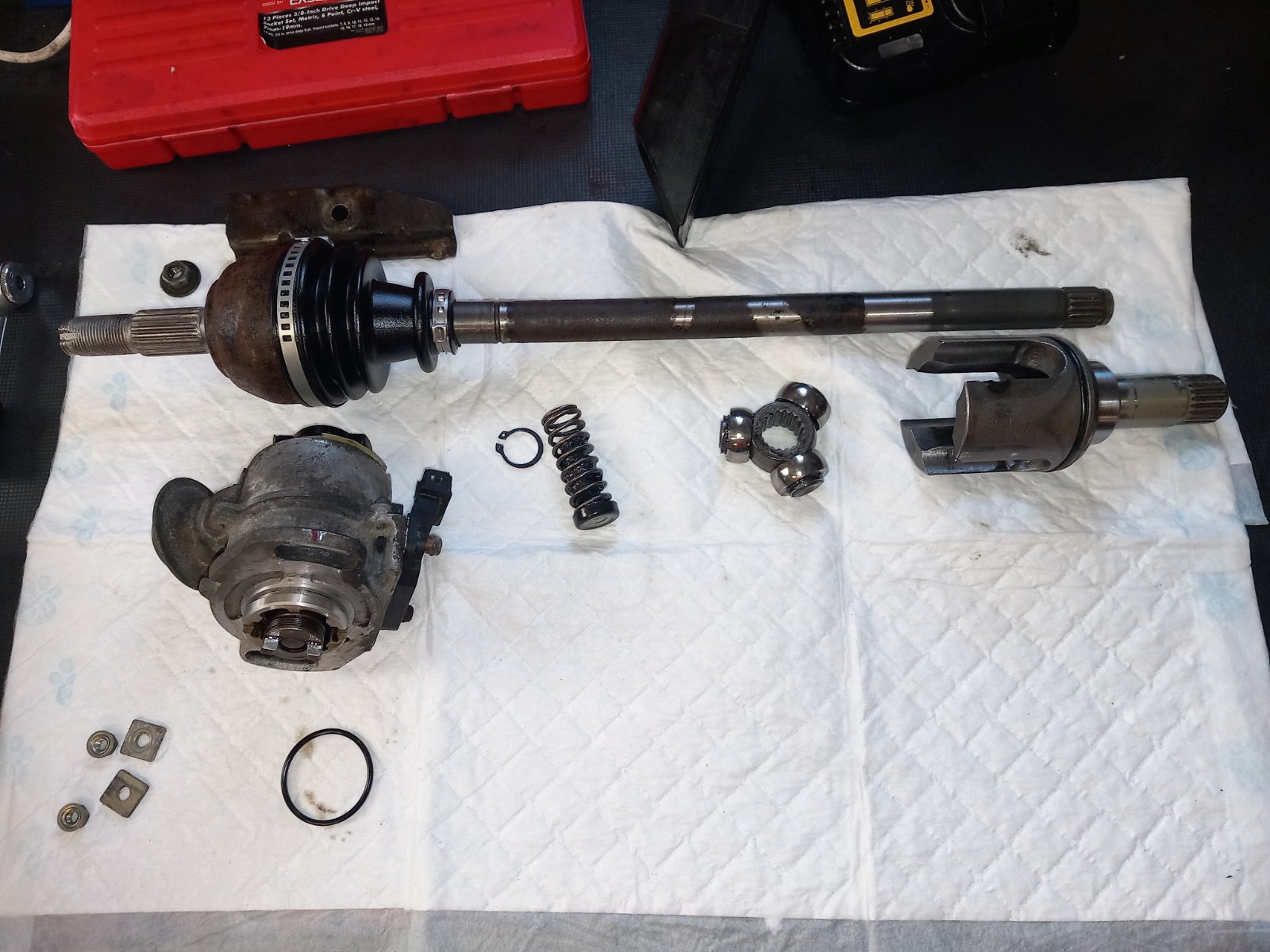

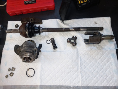

I've checked the spare driveshaft I have for potential use on Strawberry. It's in good condition and just needs a boot and reassembly. The boot is a partly a metal cylinder and a rubber bit on the end...

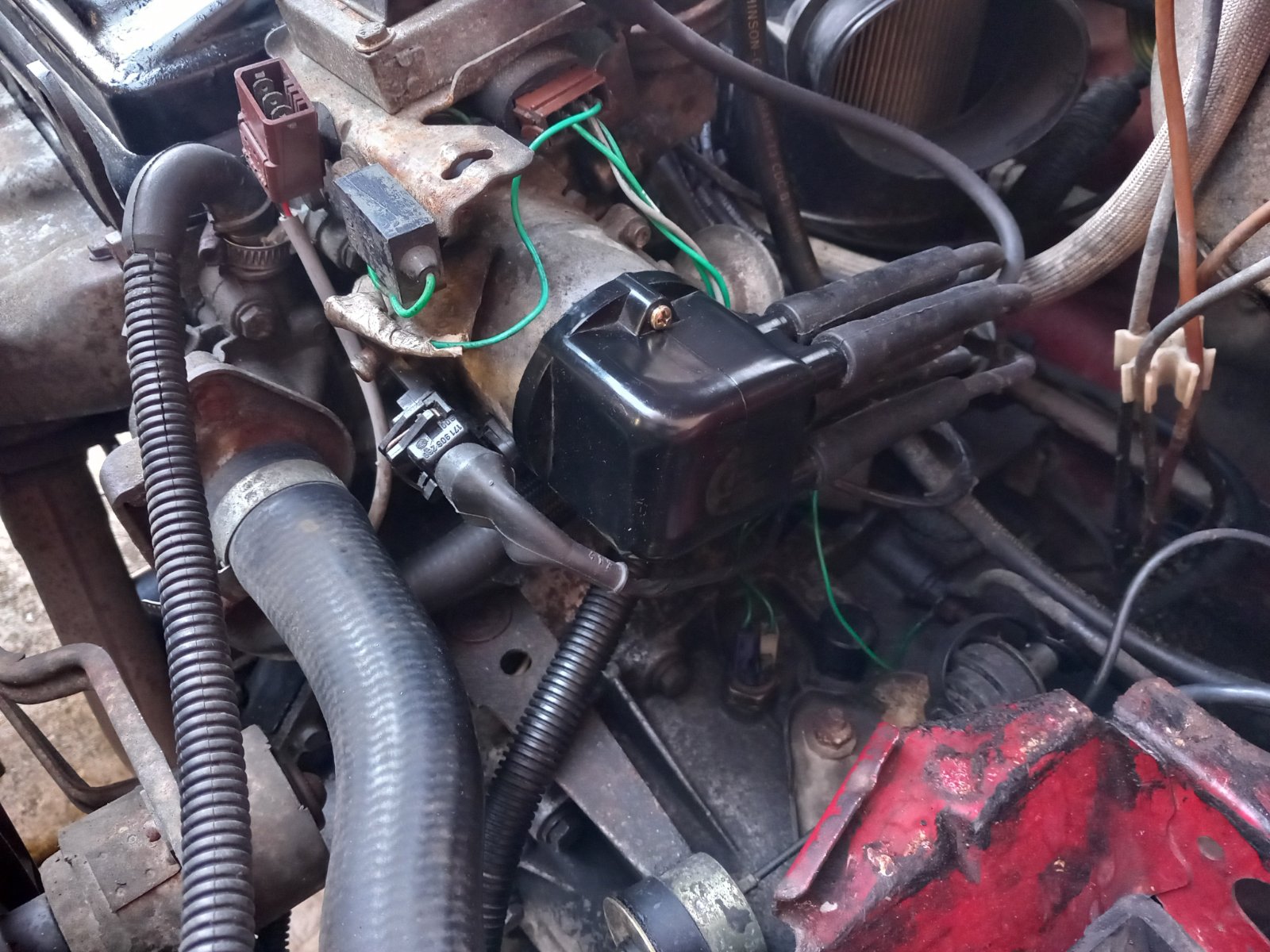

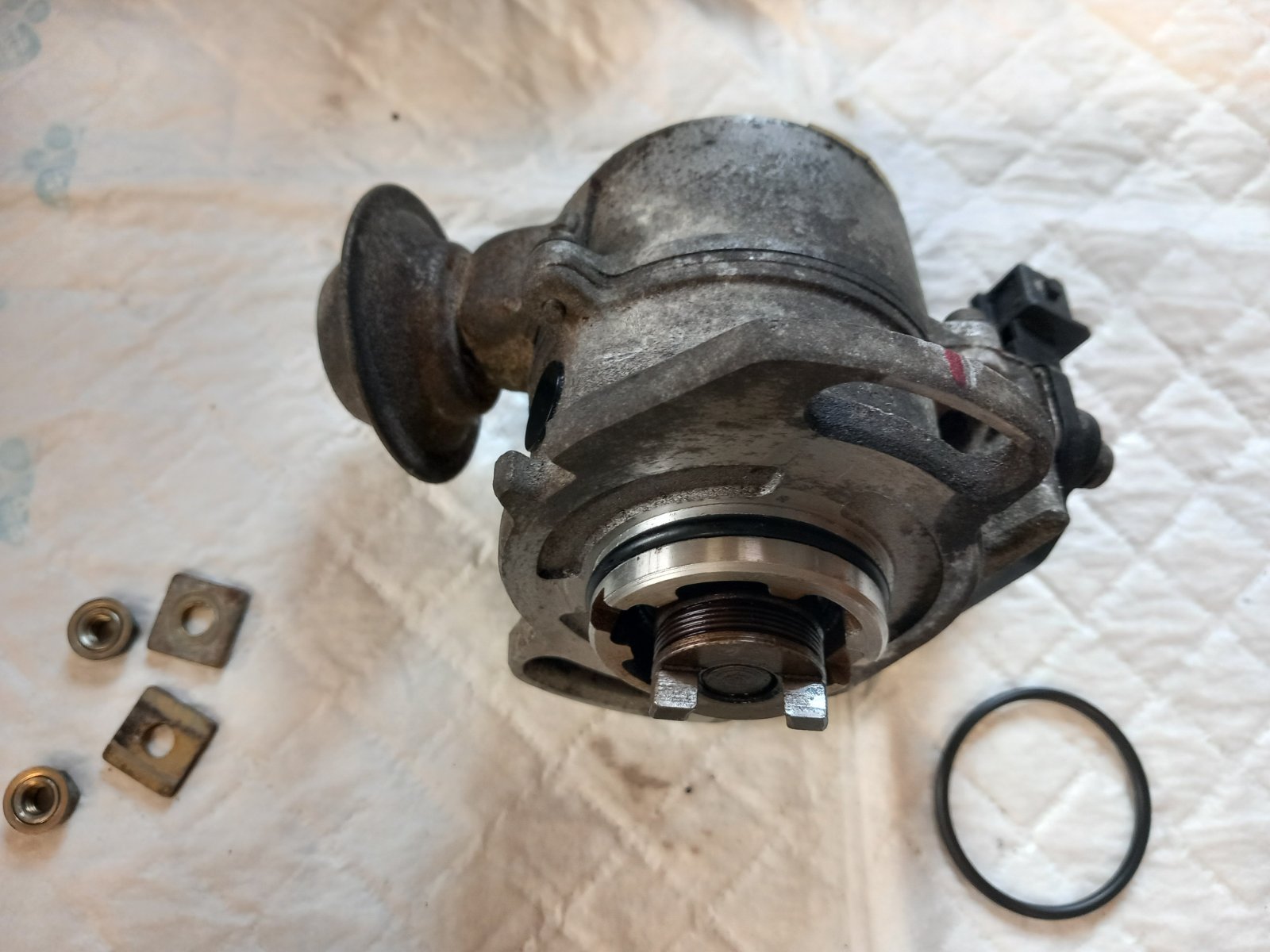

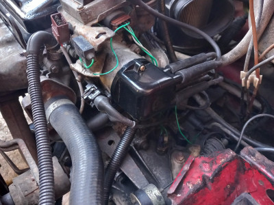

I've also popped out the distributor and removed the O Ring ready to source a replacement - I don't have one in stock...

What size is the 'O' ring Jim, I have a fair stock!
- Posts: 55116
- x 8407
Saw this just 2 minutes too late Mick! Just ordered a couple, along with a couple of CV boot kits...
Size is 37mm ID x 3mm Cross Section...

Interestingly I only have 36mm x 3.5 or 38mm x 3.5 from my stock set but I would think the 36 x 3.5 would have done the job!! Got CV boots too

36 x 3.5 may be a better fit Mick
Could I try one please?

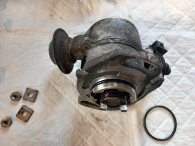

Fingers crossed, Strawberry now has an oil-tight distributor again...
Mick lent me an O Ring yesterday so that I could 'select on test' the best fit... His was a 35mm ID x 3.5mm Cross-Section. It fitted beautifully snugly:
Unfortunately, it was a bit too thick to actually allow the distributor boss to slide back into its housing in the cylinder head
Just about the time I found this out, the postman delivered the O Rings I'd ordered via the 'bay...
The 37mm ID x 3mm CS was a good fit and seems to have done the job. Time will tell...

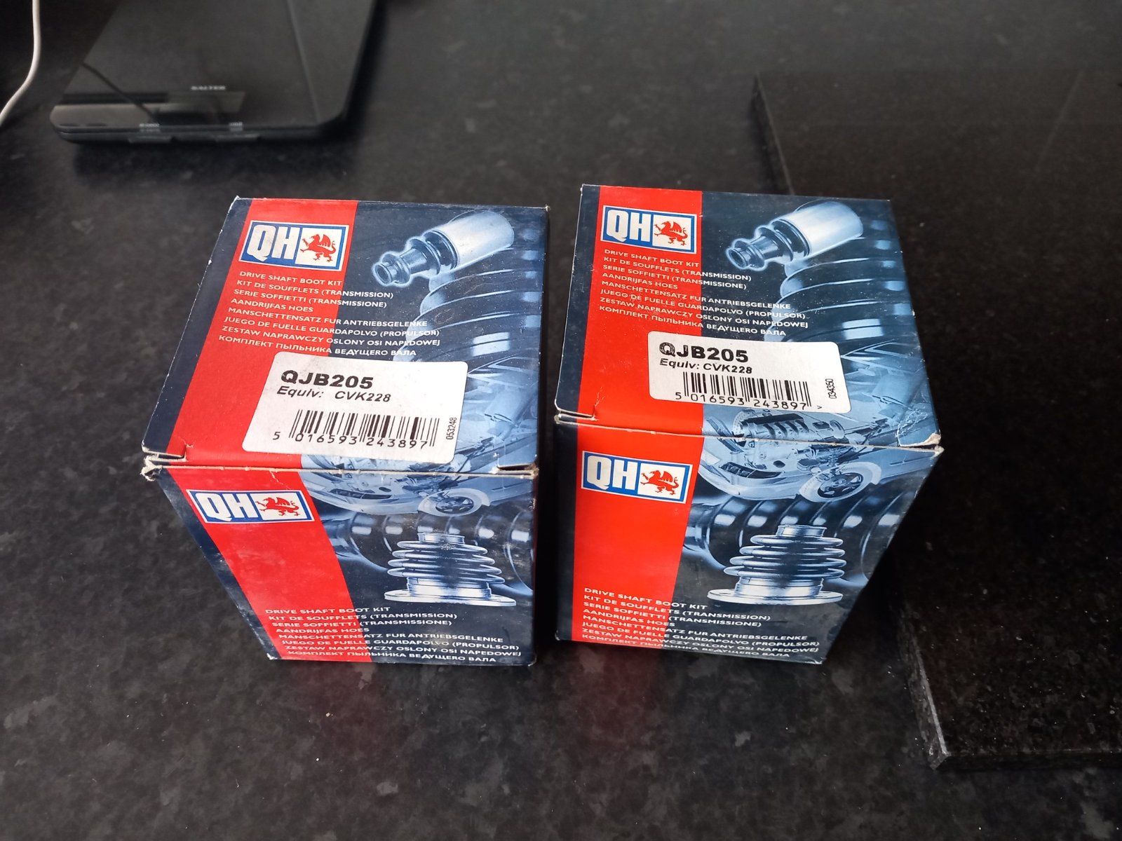

When I got home from the New Forest, I was pleased to see my new CV boots had arrived
Nothing done with them yet...

Today I've trial fitted the boot kit to the shaft and all is good
For a fiver each, those kits were the bargain of the century...
I thought at first there was no grease with them but I found it hiding in the bottom of the box... Before I found it, I checked to see if there was anything magically special about CV grease and if Castrol Moly Grease, of which I have loads, would be suitable. My research suggests CV grease is generally just ordinary moly grease* and any good quality moly grease will do, especially for inner tulip/tri-ax joints as these are...
It was interesting to read up on how moly grease works and why it's good for CV joints but not so good for wheel bearings...
