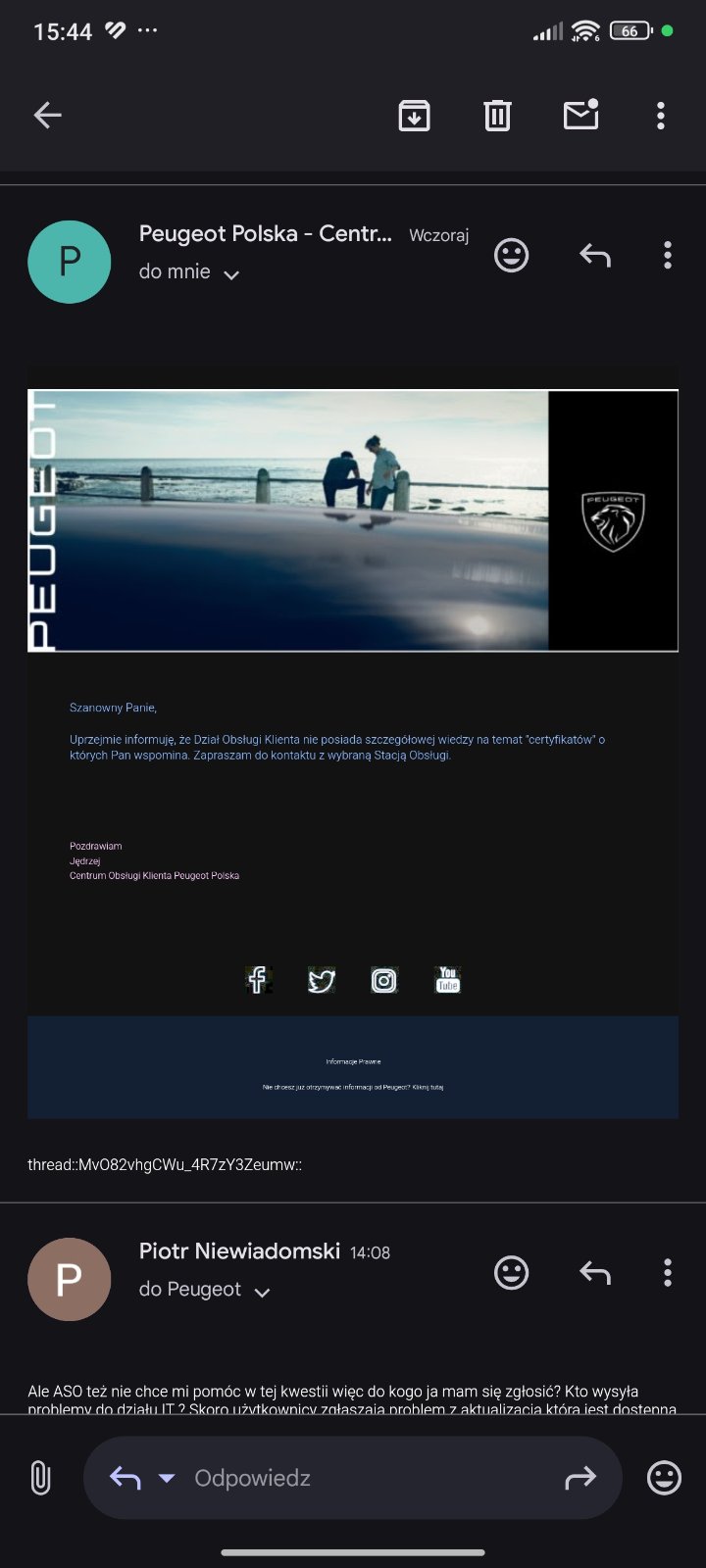

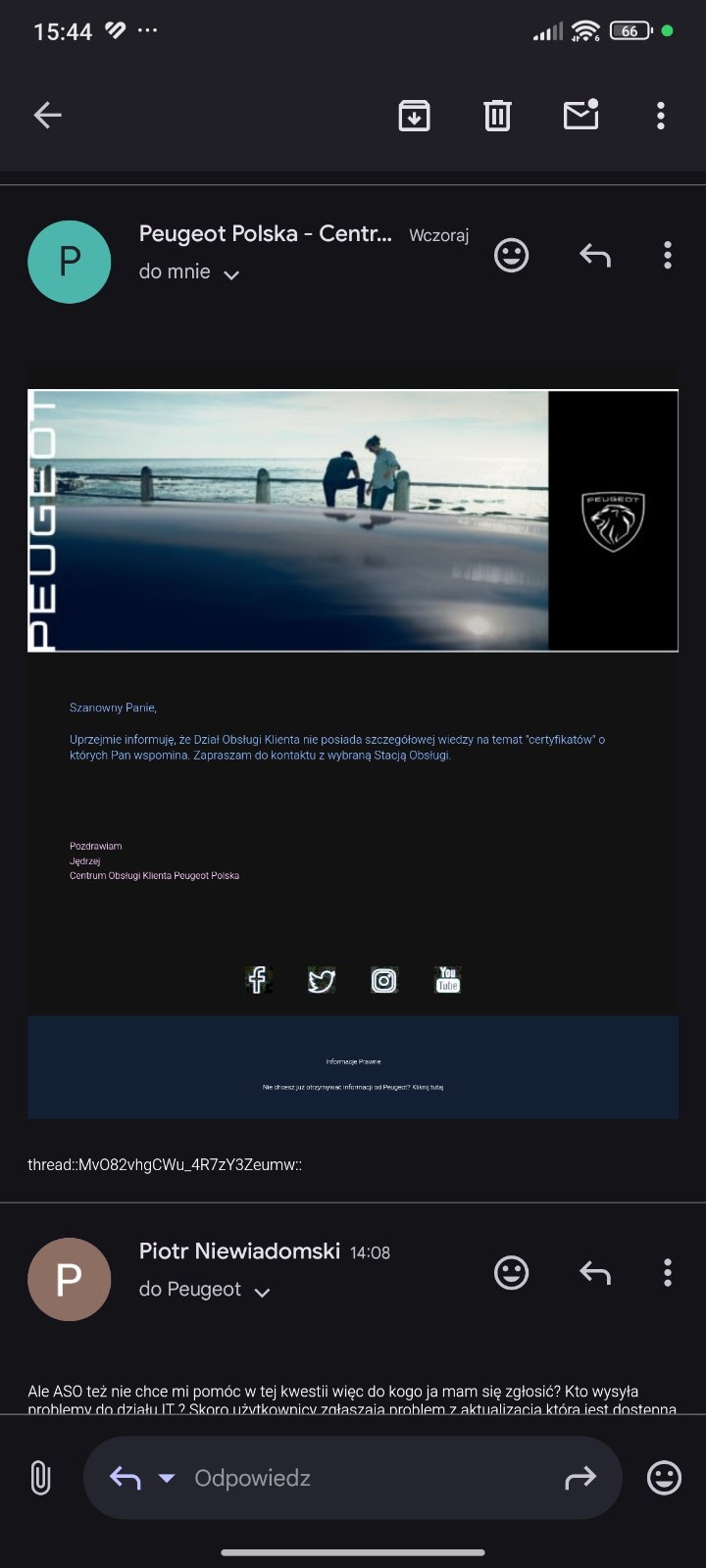

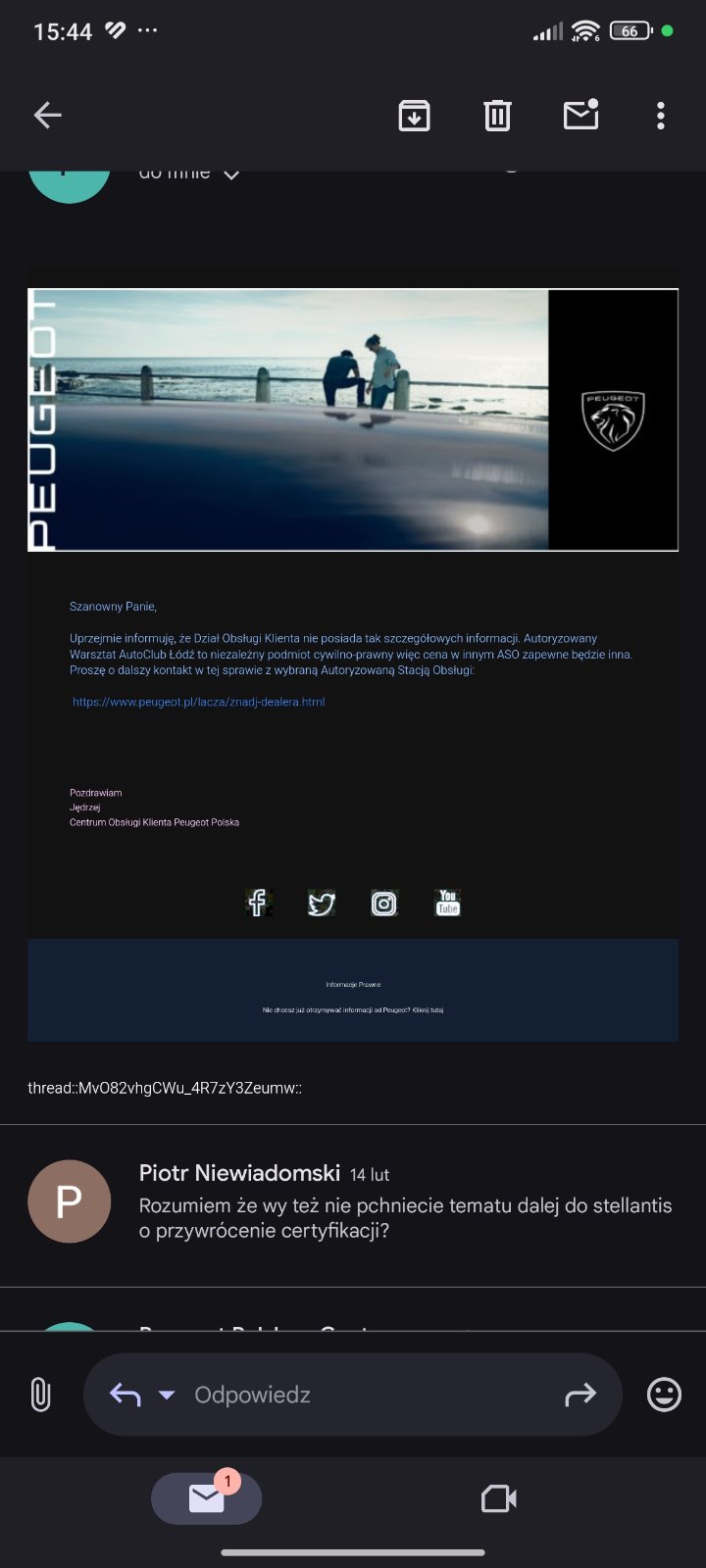

In Poland, in the city of ?ód?, there are two Peugeot services. Both services supposedly know nothing about problems with NAC updates, they just keep inviting you to the service to connect the diagbox. I also wrote to Peugeot Polska and they also keep putting me off. Even writing about certificates that the problem is on their side, they reply that they know nothing. I am attaching screenshots, only in Polish.is there anything else I can do or solve my problem in another way? where else should I write?

Re: PSA NAC RCC Updates
Hi, so you may have to contact Peugeot Head Office (Stellantis) in Poland, which I believe is in Warsaw (+48 22 444 22 44):
https://www.peugeot.pl/
Tell them you have been in contact with the dealership and they are clueless! Tell them the update tool is informing you of an update yet it will not install - tell them they should know of the outdated certificates that have expired, preventing the firmware from installing and that this is beyond the scope of the dealers to assist with as it is a Peugeot / Stellantis issue. Tell them you are not going to pay a fortune for a Diagbox diagnostic to update the firmware that customers are able to do using their own App! It is a Head Office issue.
