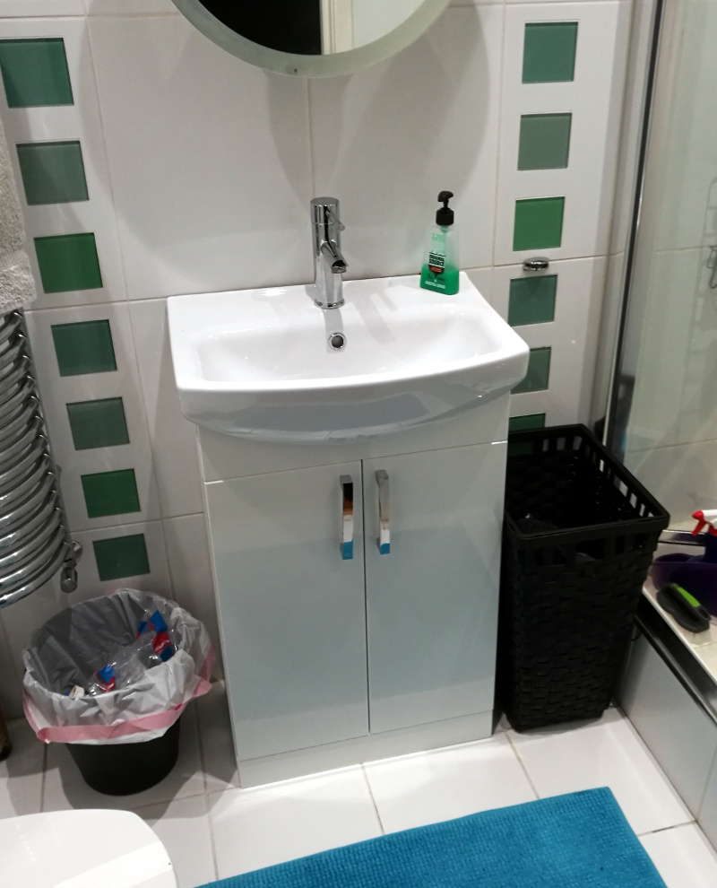

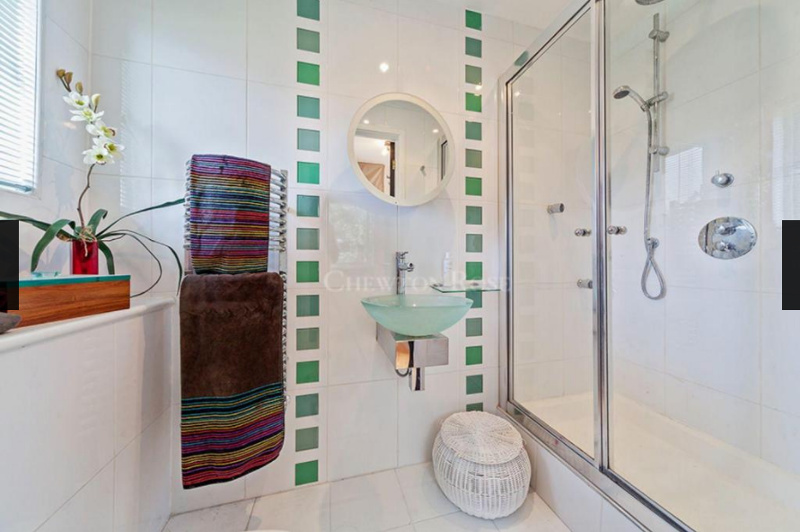

Had a quick rummage around my PC and I can't track down the photos I was looking for of the en suite bathroom, so I dug out one from the original property listing when we were looking at the place. Some major fish-eye distortion going on, but you get the idea.
Problem with the thing is that there's no lip around the edge, so as soon as you put more than about an inch of water in the bottom, as soon as you put your hands anywhere near it, it just sloshes over the sides. Plus there's absolutely no way to get to the last couple of millimetres between the bowl and the shelf it sits on - so there's always gunk in there that you can't clean out - but can see through the bottom of the bowl, because it's glass! The plumbing all crammed into the tiny space under the shelf was a complete and total mess too. The complete lack of a vacuum breaker was a pain as well as it meant that every time you drained that basin, it would suck all the water out of the trap in the shower.
Now there's an actual sink in place, with proper plumbing and some storage under the base.
Replaced the trap with one containing a vacuum breaker as well so the water no longer gets pulled out of any of the traps. The actual waste pipe that goes through the wall will need to be changed at some point (the old one is very cheap chrome plated brass), but because there's no access that will be a pretty major project...so that's going to wait until I've got more time available...My choices are basically to drill through a bunch of tiles to make an access panel on that side (they're a non-standard size, so if I break any of them I'm in trouble), or to remove the bath tub on the other side of the wall...neither of these exactly sound like fun!

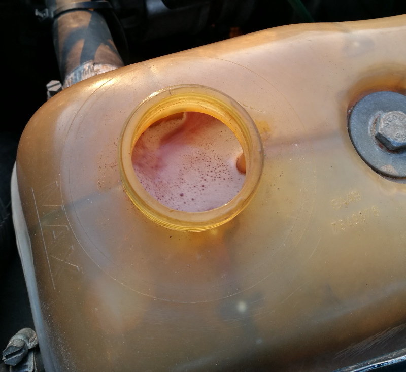

Had a closer look at the Saab today, and it definitely looks like something is amiss.
It's hard to tell if the system is being pressurised by squeezing hoses as this is one of those cars which runs the system at quite a high pressure anyway. However revving the engine with the cap removed results in the froth you can see in the attached photo appearing.
Also looks like there's oil weeping out of the head to block joint at the rear end, though that's been there since I got the car - and to be honest could well be coming from the timing cover and just getting into the groove there, it's hard to tell...Let's face it, it's a Saab engine, so there are more places it leaks oil from than where it doesn't!
Don't worry about the tiny surface cracks in the expansion tank that you can see, they all do that - however new ones are north of fifty quid and I can't remember ever hearing of one failing.

That washbasin looks absolutely gorgeous Zel but yes, I can appreciate all the problems with it, especially in the hideously hard water area we live in
Just keeping normal sanitary ware clean and good around here is a nightmare... With my household OCD and need for 100% cleanliness it would have driven my potty by now!
The basin sadly is form over function; the new one you have installed is far better, practical and looks good too...
That is not looking good on the Saab front
Bubbles and froth in the coolant is never a good sign.
How much of a job is it to do? Hopefully easier then doing heads on transverse PSA engines leaning way back in the bay and having lots of barely accessible bolts around the back around the turbo...
