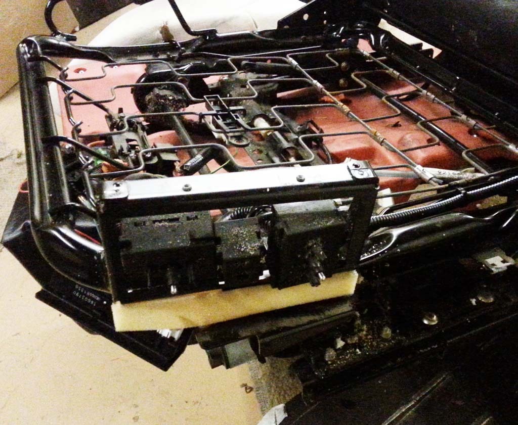

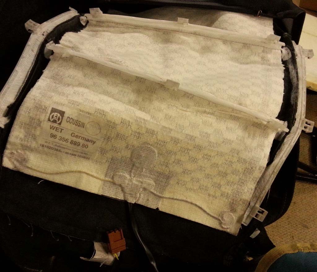

more seating images.
Note the heat pads are sewn onto the leather....ummmmm
Note the "problem" switch box

Ahh! there's the problem.. It's German!!!! Wet German at that....

German build quality strikes again [emoji15] [emoji12] [emoji23]

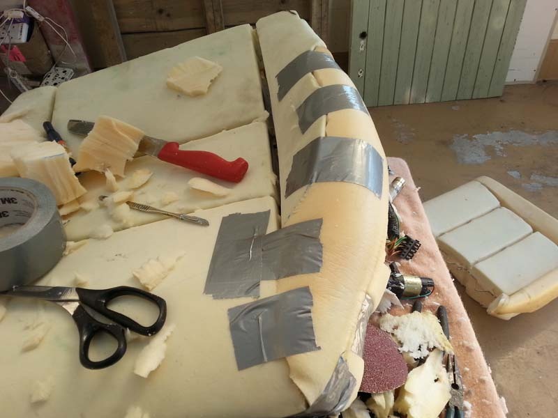

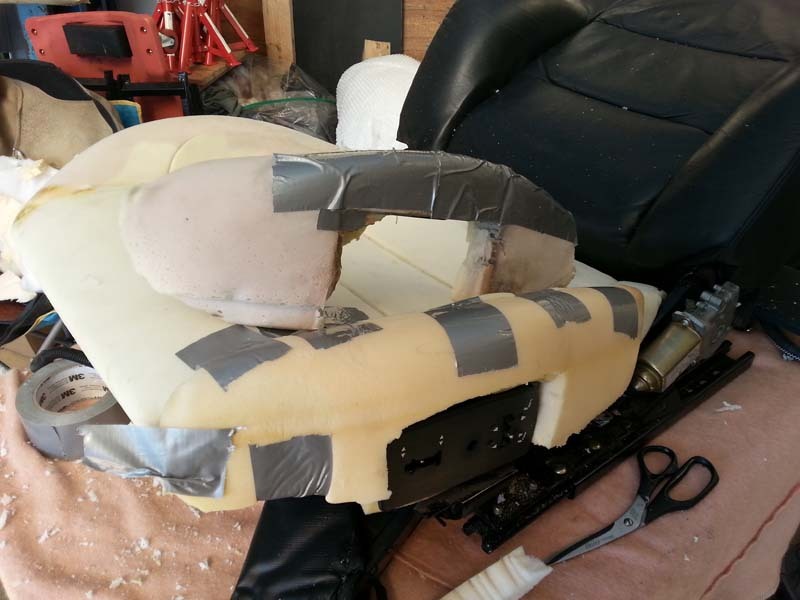

Well I got a foam section from a rear seat squab, I shaped it and applied with 3m spray, taped for 12 hours to fully set.
Old section as a pattern
taped and left to set up ...messy job

Looking good Alasdair
