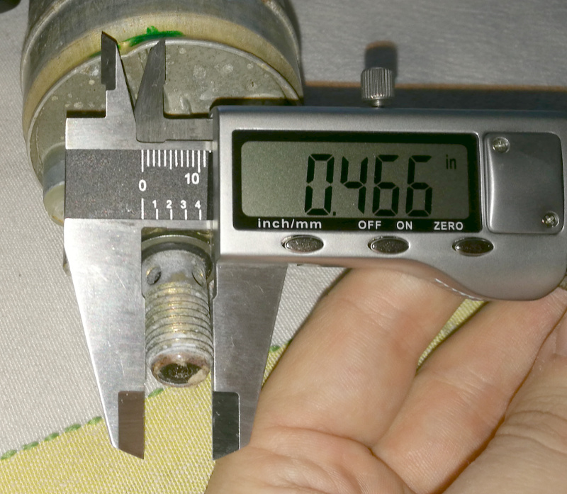

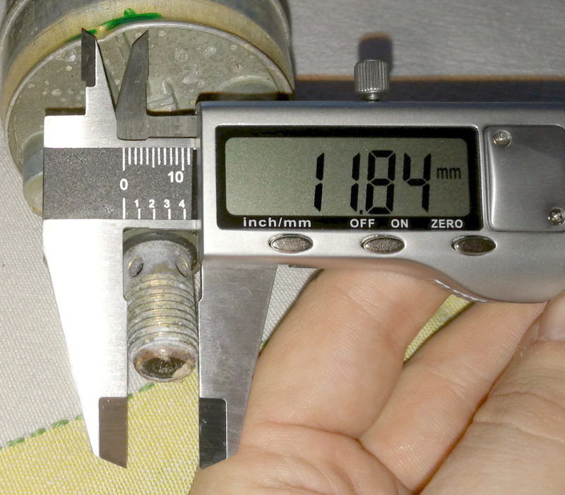

Okay, question of the day...What thread is this? Thought it was M12 based on judgements originally made with Mk I Eyeball, but it's not as an M12 cap nut won't screw on.
Photos show measurements taken just now. Actual thread spacing looks to be 1.84mm between the peak of the threads - or 0.073" - could that be actually 0.075" I wonder...
I've got a suitable banjo fitting and washer, but I need a cap/dome nut to go on the end...but before I can get one I need to figure out what size it is.
Thought I had one in the parts box, but it's standard M12 so won't fit!

Being a Banjo Zel, it could be something like BSP - British Standard Pipe or BSW - Whitworth!
More likely though it's a UNC thread...

Wish my thread gauge hadn't gone walkabout...
Reckon this may be another case of "go wave it at Pirtek" unless anyone has better ideas...Just annoying to find a larger project held up by something so small...

Zel, I have a Zeus book here with some very comprehensive thread dimensioning tables and I've the measuring kit to go with plus a selection of thread gauges...

The closest common thread seems to be 1/2" UNC (13 TPI).

Many thanks to Jim this afternoon.
With a set of thread gauges, micrometer and the wonders of the internet he quickly identified the thread on the outlet of this fuel pump to be M12 X 1.5mm.
Looks to be a pretty simple matter to pick up what I need now! Certainly not something I have rattling around in a parts box here sadly though.
