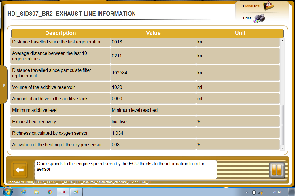

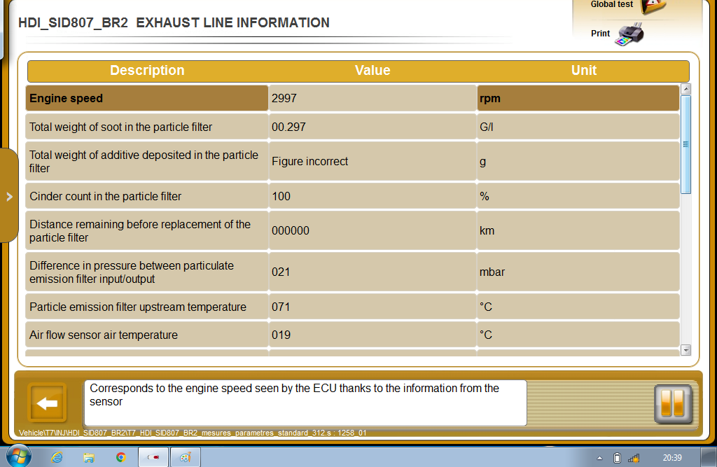

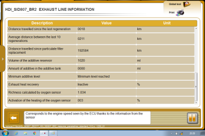

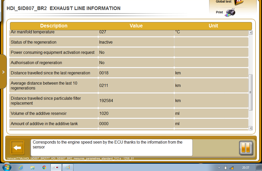

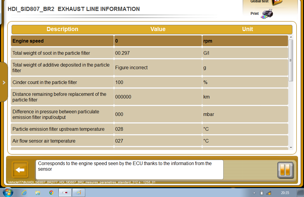

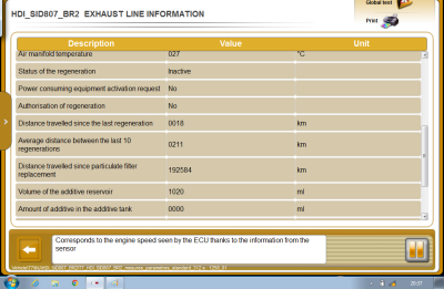

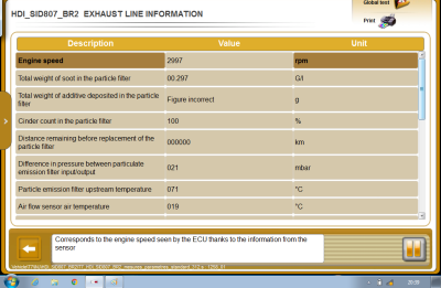

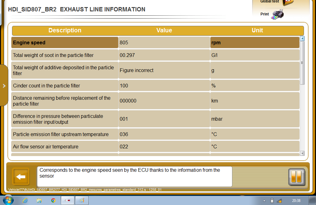

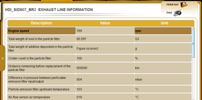

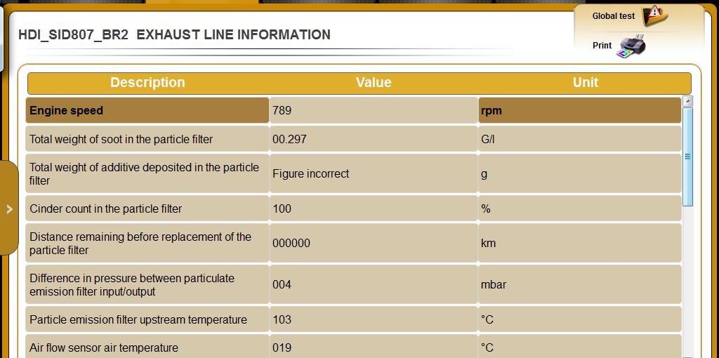

Will update with the differential pressures shortly but all are low.
Just note down the sequence of menus:
Fault finding
Injection/ignition
Repair
Pack repair
After sales particular emission filter repair operation = no.
Replacement parts
Replacement of the particle emission filter
Warning: carry out this operation only after replacing the particle emission filter
Switch off the ignition
Switch on the ignition
Process done!
From the replacement parts menu also completed:
Filling of the diesel additive adding reservoir
Which part way through states:
Don't forget to do this in the additive ECU menu!
That will be what I did the weekend but didn't do this in the engine ECU menu!
Posts: 5338
Joined: 25 Apr 2022, 09:03
x 2356
Unread post by MattBLancs »

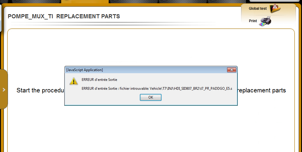

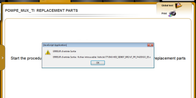

From the multiplexed additive ECU menu
Repair
Pack repair
Replacement parts
Fill additive tank
Message States complete this procedure in the engine ECU menu, clicking the tick it thinks for good while then pops up with the error message. I'm not sure if it is attempting to move me across from additive ECU menu to engine ECU menu?? Stops it anyway.
Posts: 5338
x 2356

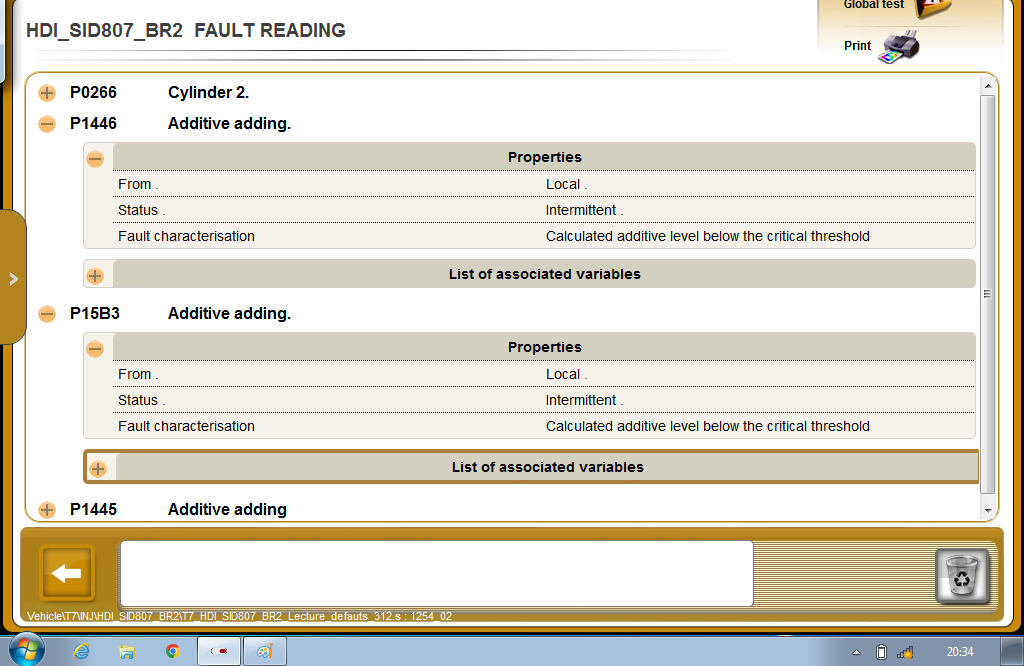

From additive ECU, fault reading
Now States no faults found.
Back to engine ECU menu and the faults cleared.
Back to main menu and global test....
Posts: 5338
x 2356
No faults! Disconnecting the laptop, very quick test drive then off to bed!
Posts: 5338
x 2356

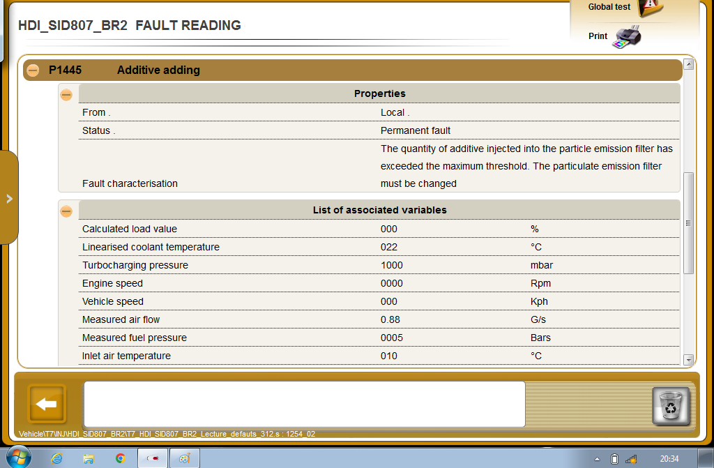

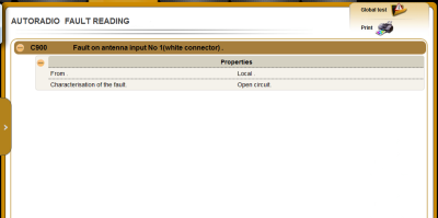

Quick drop of the print screens commentary to follow.

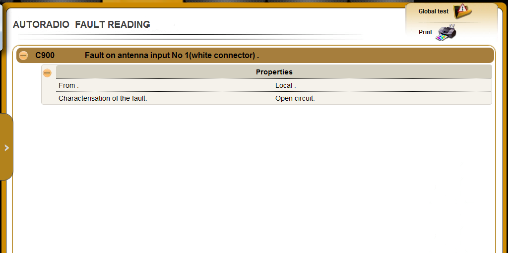

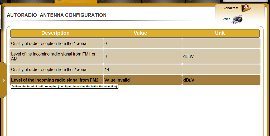

One fault remained on the radio ECU. Parameter measurement on the aerial page suggests something up there. Another day's job!
:-D

That's looking better Matt :) Looks, on the face of it, like the radio can have two aerials... Is the radio fully functional?
Be good to see how the DPF behaves now over a period of time...

CitroJim wrote: 13 Mar 2024, 04:56 That's looking better Matt :) Looks, on the face of it, like the radio can have two aerials... Is the radio fully functional?
I think it's one aerial/ external unit, but there's something like a signal amplifier involved - I remember reading something on the C5 stereo types and they have some with one connection, some with two. From memory it wasn't sat nav related, just radio. 308 SW could have built in sat nav, but despite being posh Allure spec, this doesn't have it.
Yes, I'll keep this updated with performance updates good or bad.
Will try to remember to get some more DPF differential pressure readings in a few months, also see what the "average time between regens" figure changes too (hopefully a lot nearer what your C3's data shows)

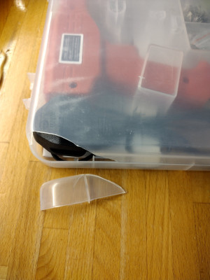

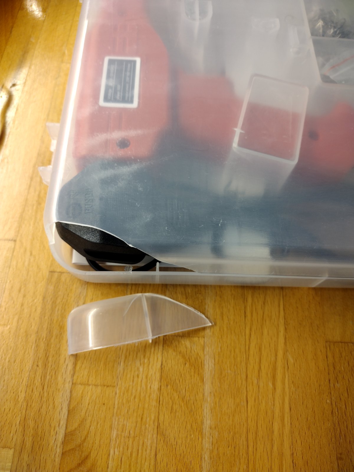

Staplers has arrived, and even better than that...
Spoiler: show
it's come with a free plastic welding/stapling job to practice on!
Hoping the tool is more robust!
:roll:
Posts: 55131
x 8412
The box is broken deliberately Matt, it's your practice piece!
x 3565
Mine arrived a couple of days ago - you did better than me, Matt, as I don't even get an unbroken plastic box - I just get the carboard box it came in :bigcry: I can, however, say that it works rather well and as a bonus feature - the fuse is actually electrically wired in in the plug so it's less unsafe than a lot of the other imported tat available on ebay :lol: I have downrated it to a 3 amp though :wink:
