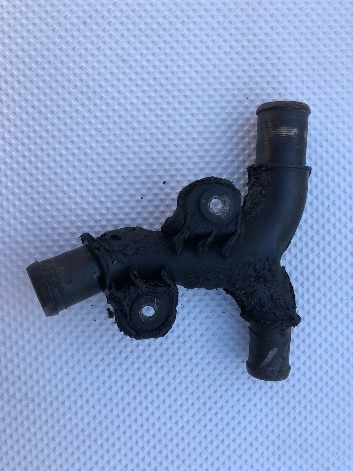

Thanks Richard

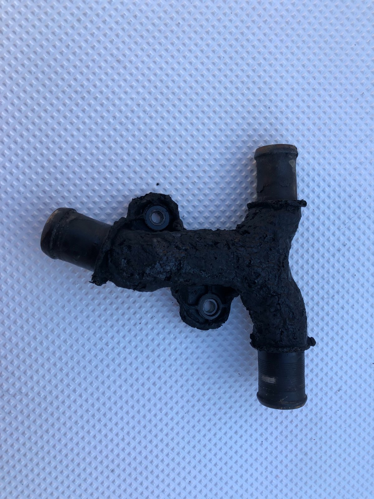

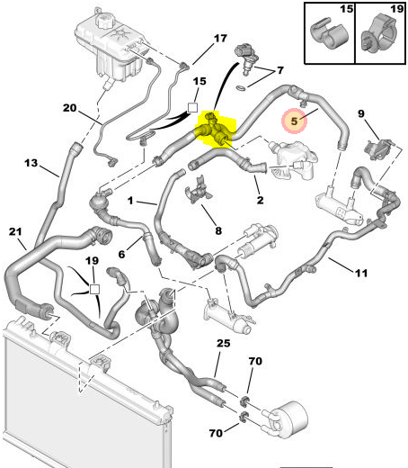

I seem to have a plastic T tee that is not on the diagram (at least that I can see) - see pic
It goes between the water inlet flange 1336Y2 (via a rubber connector hose to the bottom of the T).
The top piping - one side goes to the top of the engine (looks like pipe #1 in your diagram) and the other side seems to go down into the engine (maybe to the oil cooler) - hard to see
cheers
cheers

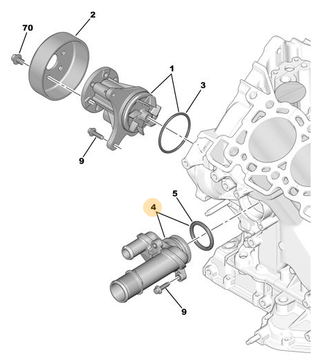

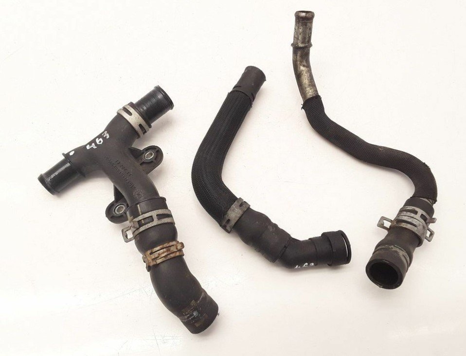

The diagram you posted is not the correct one for your vehicle, unlike the one Richard posted up.
1336Y2 is the engine water intake tank (4):
The only slightly similar part from your photos above might be something like the one highlighted below, which is part of the radiator water inlet hose (5):

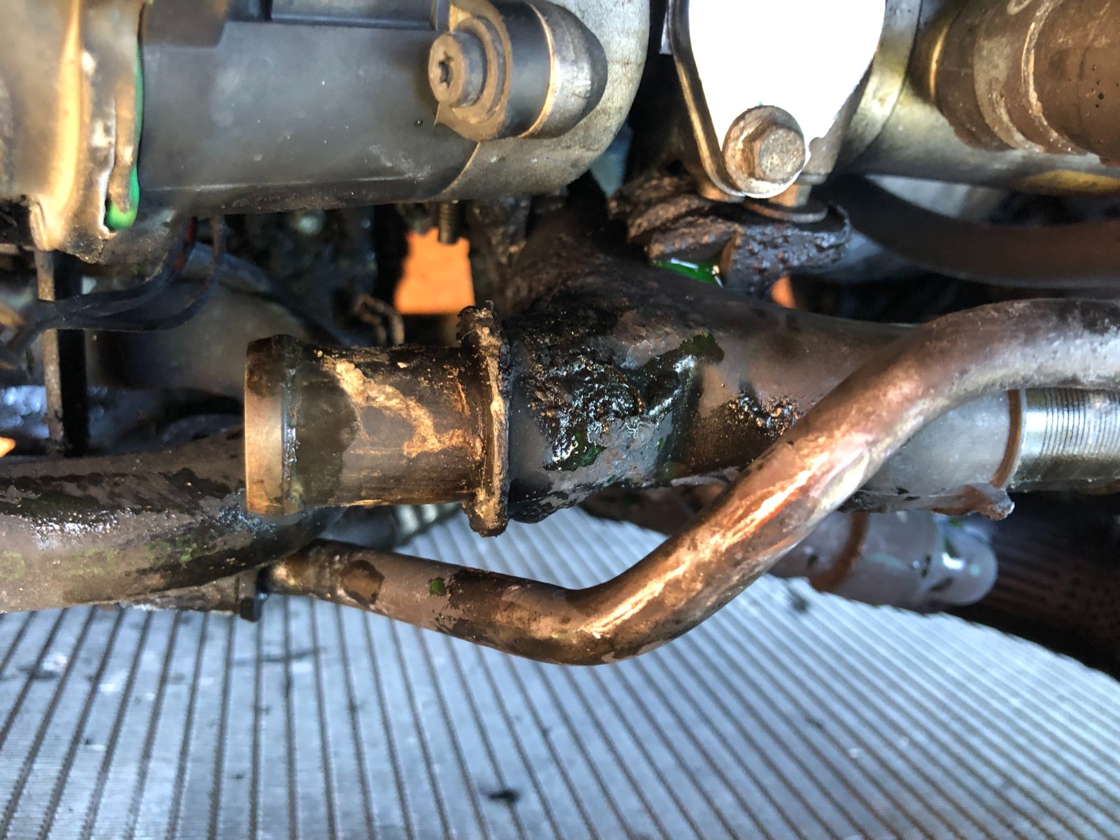

Thanks Marc
I have taken Richard's diagram as the bible yet my parts exists
and no, its not the part in yellow
If it helps the build code is 10896 - maybe it has some extra heating options (not that you would want them in Australia)
The bottom of the T part goes into 1336Y2 (into the small pipe) via a rubber pipe connector.
Its also bolted on to the front EGR (two nuts).
See photo of where it is on my now dismantled car (thanks for the procedure)
I've managed to pull the whole radiator / condensor forward so that I have enough room to work without degassing the airconditioner (but did have to remove the front collision bar - only 8 bolts).

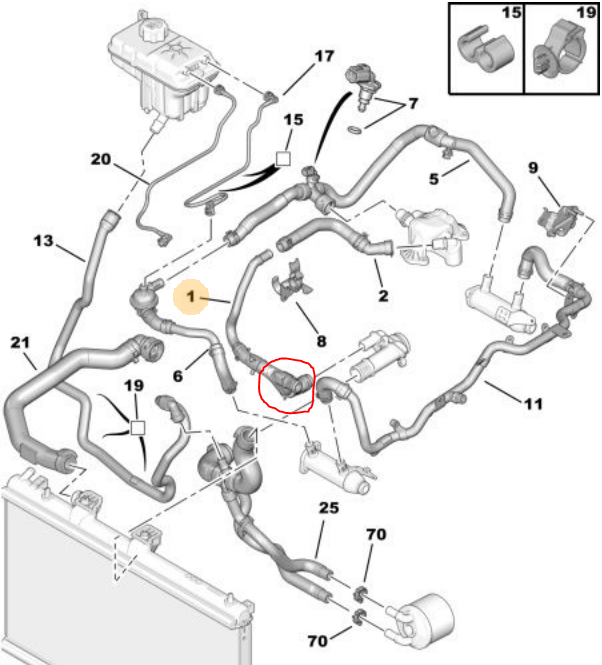

That's why we ask for the VIN as we don't use 'generic' diagrams - only the live Peugeot data and specific parts fitted to the vehicle (Richard and I use the same live data from PSA).
Unfortunately at this time neither of us can see the specific 'T' piece, but as I mentioned, it may be part of a larger hose and not available as a separate part, which is why it may not be shown. I've checked the EGR Cooler and it's not shown their either. I've also checked your spec. sheet and it has no 'additional heating' system fitted that tends to be only for Nordic countries.
I will keep looking though...
The only other thing I can see is that it is part of hose (1) Radiator Outlet Hose where I have circled in Red as this is the only pipe that attaches to the top of the outlet tank. So if it is part of hose (1) it is part 1323J0, but is no longer available from Peugeot, which is making me wonder if that is the reason it has previously been replaced with a bodged part from another vehicle?

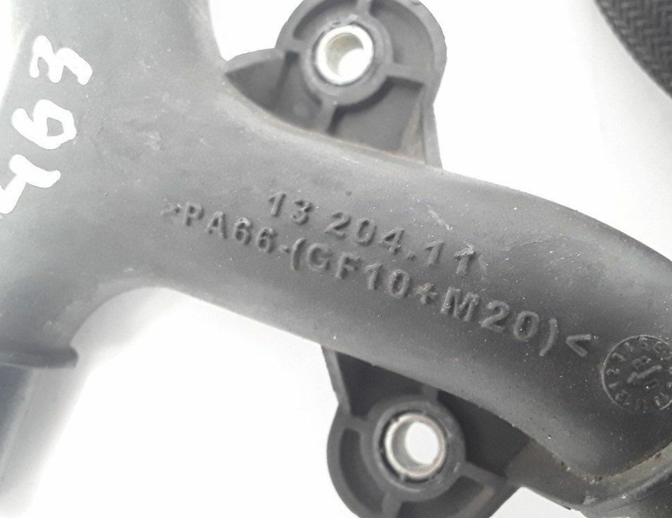

seems its part 13204.11
These pics are said to be off a 2009 607 2.7 HDI but I guess the hoses need to go somewhere
I do suspect some work was done on the car before (some bolts and nuts are missing) but it all seems to line up
now to get the part as mine as mine is stuffed
- x 6945
Ok, so just to confirm that part is not a valid PSA part number, but is available at plenty of other places. So this confirms why it's not being shown up. Best of luck, mystery solved

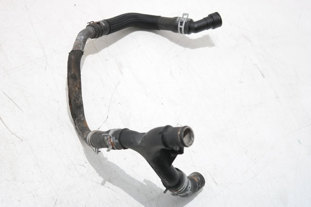

It looks like it is not supplied separately, if you google the part no for item 1, 1323J0 then lots of pics come up which show the tee part as part of the hose assembly. e.g.
It may well be used on other variants, but as it's not a sep part no difficult to tell. If you can get it supplied off the part no embossed on it, then seems to be the way to go!

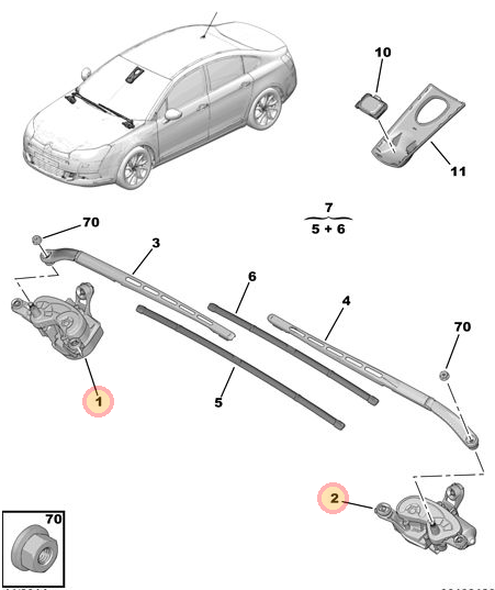

Hi Marc,GiveMeABreak wrote: 18 Feb 2023, 21:19 Hi Tim
Here you go. The right and left side motors are different. The wiper motors are the same for ALL Right Hand Drive Models, but Left Hand Drive Models are different. So make sure it is a RHD vehicle and make sure you get the left or right side as needed.
(1) Wiper Motor Right, part: 6405LA, £417.17
(2) Wiper Motor Left, part: 6405LE, £417.17
These are hard to come by second hand, any way I've had someone get back to me to say that they have a drivers side but the part number on it is 53570912 not 6405LA would this be right?
Cheers
Tim
- x 6945
Hi Tim, 6405LA is the PSA part number, but 53570912 is the Valeo part number for the right side motor, so yes.

Tim1968
Cheers MarcGiveMeABreak wrote: 23 Feb 2023, 15:55 Hi Tim, 6405LA is the PSA part number, but 53570912 is the Valeo part number for the right side motor, so yes.
If you ebay on 6405LA without the space you'll also see some suppliers:
https://www.ebay.co.uk/sch/i.html?_from ... A&_sacat=0
Just wanted 'to be sure to be sure' as we say in Ireland
Do you know off hand what the Valeo number for the left side is? which seems to be the harder part to find.
Regards
- x 6945
Hi Tim, Valeo part: 53571012 for the left side one to be sure.

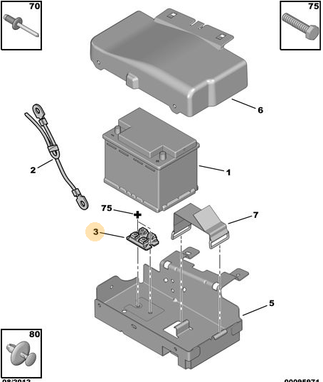

- x 6945

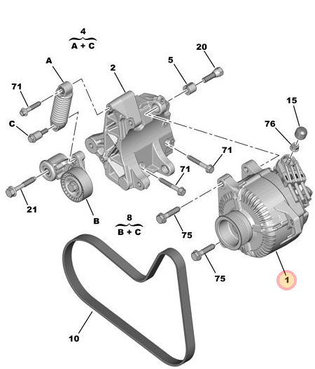

@kingjafad:
Here are the diagrams for those items
(3) Overload Diode
(1) Reversible Alternator
(3) Overload Diode
- Posts: 12596
- x 1489
Well found on that diode Marc, part no I posted was a different but, that part is 652419, also NFP...
