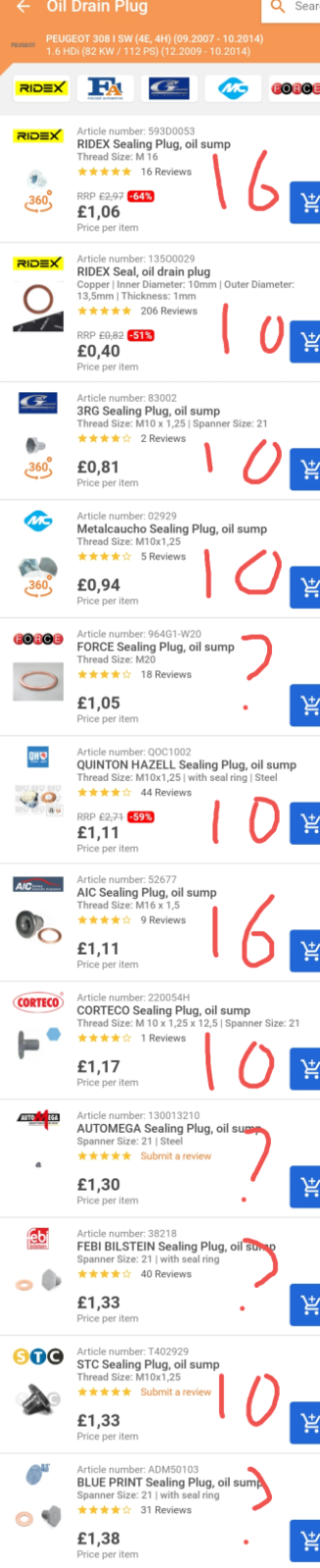

RichardW wrote: 15 May 2024, 09:51 I imagine the trouble with the sump plug is it has a 21mm hex, but only an M8 (?) thread, so it suffers from the gorilla syndrome problem.
M10x1.25 but yes, definitely!
It's a pretty weedy weldnut inside.
Interesting that "outy" one seems to be M16 too

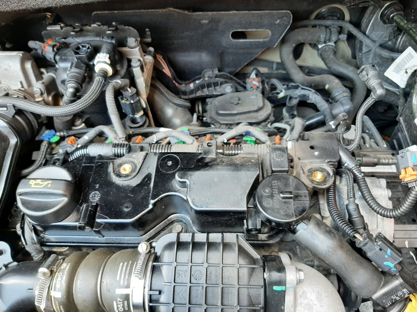

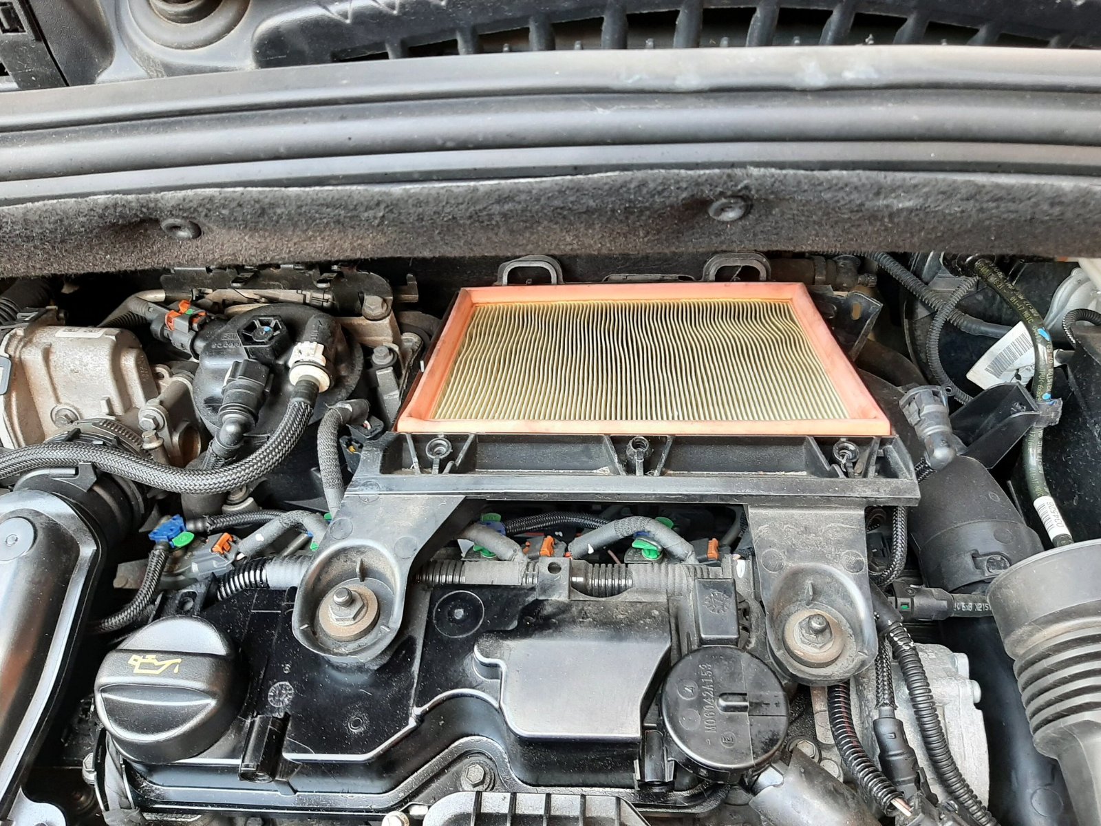

More good work today, I had the airbox off and checked the injector clamps.
All at 45 Nm which seems reasonable...

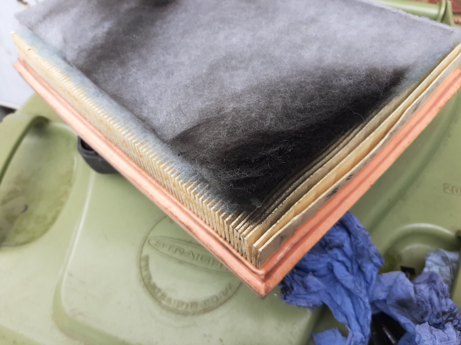

Intrigued by this dry sooty mark on one corner of the underside of the air filter element :confused:
Any thoughts?

CitroJim wrote: 15 May 2024, 19:10
Any thoughts?
Isn't that where the induction pipe enters the filter ? Maybe just re-circulated exhaust fumes via EGR ?

Skull wrote: 15 May 2024, 20:18
Any thoughts?
No, it's a way away from the EGR Gary... I have a theory after sleeping on it - and now having sooty hair :lol: I will discuss over lunch with learned friends and get a collective opinion...
Any thoughts?
EGR normally a good deal nearer the inlet manifold (on 16v DV6 it's on the right side of inlet manifold on the part integral with the cam cover)

Sump plugs about a pound on Autodoc (obviously the £8 p&p shifts the balance unless there's other things you need)
Mixture of M10 and M16 plugs listed (hence crude markup!) :)

We agreed, over lunch, the sooty patch on my air filter is brake dust - the air intake is in the inner wing and ideally placed to draw air in the vicinity of the brake caliper!
