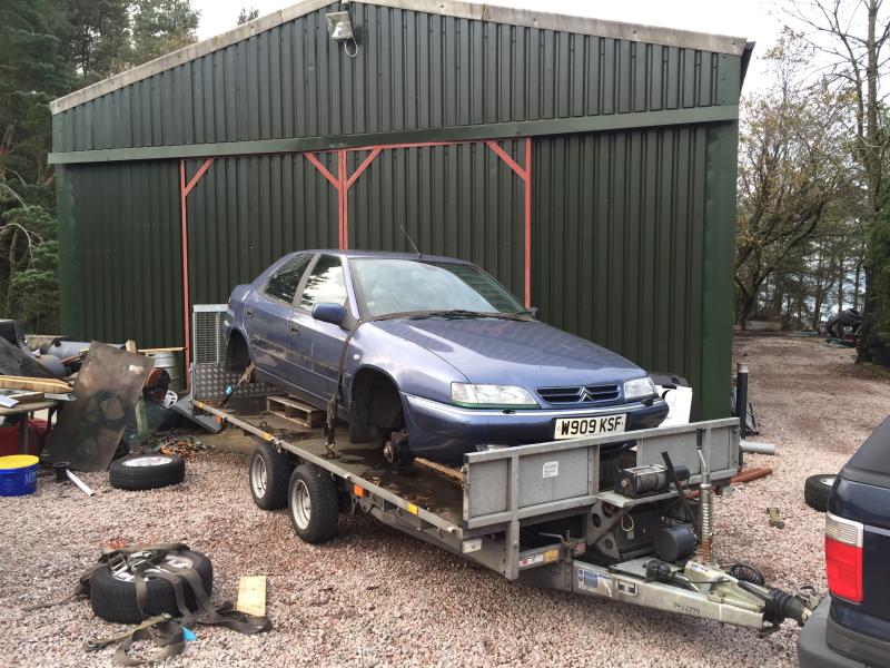

It was a fairly rare colour Mike. Unfortunately it had been badly resprayed down the passengers side of the car where it had been keyed. The colour match was never right. Unfortunately I didn't notice it when looking at the car originally, I only saw it as I drove home in the passengers door mirror. Jim was also telling me it had welding done for it's last MOT and apparently was going to need more for this MOT so when the hydraulic pipe burst when he had it, it was game over. He'd already removed a fair few things, interior, injectors and some other bits and pieces to name a few before I got it back.
Was quite sad seeing it thrown away today as it had been a good car in the time we had it.

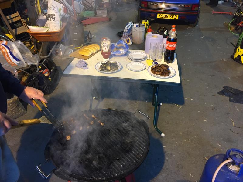

Well a great day was had at Glasgows French V6 HQ today...
Simon came down for a visit in his V6 Xantia and a friend of mine came to visit in his 205 GTi that has undergone a nut and bolt restoration and is currently running a Xsara VTS engine.
Simon managed to solve a couple of electrical issues he was having with it with the MAP sensor and Lambda sensors. It's a 306 GTi wiring loom and ECU connected to a Xsara engine and sensors so some of the plugs had been remade. Luckily it was just wires the wrong way around. The lambda sensor was odd, green went to red and red went to green, totally the opposite of what you'd expect.
We then got round to fitting the new exhaust to Simon's V6. The hangers were in the correct position on the back box but they weren't quite at the right angle. We heated them up with the oxy acetylene litany bent them the right way and fitted the exhaust. The new system was a perfect fit. It slid on nicely and the positioning of the flange on the centre to rear sections was perfect.
The lad who owns the 205 is also the same guy who does the detailing work for me :) As a result my Activa and 406 Coupe were given some much needed TLC. I'm pleased to report that both cars are now looking absolutely fantastic.
We even managed to have a BBQ at the end of November due to the unseasonally mild weather that we are having at the moment...
That's the Activa now in hibernation until Spring anyway. It's going in doors as soon as I've got a space for it, hopefully in the next couple of days.
Anyway, a great day was had by all as far as I'm aware. Can't wait to do it again now! :)

Ye gads. Coca cola, hamburgers, soft white rolls (wall filler) sugary tomato sauce and carcinogenic charcoal !
Total Geek food :shock: :lol:

There was no charcoal on sight... It's a gas BBQ with a cast iron griddle!
They were proper beef burgers from a butcher in North Wales and they were nothing short of superb!
Sugary ketchup... Yea, can't deny that one!!
:D
