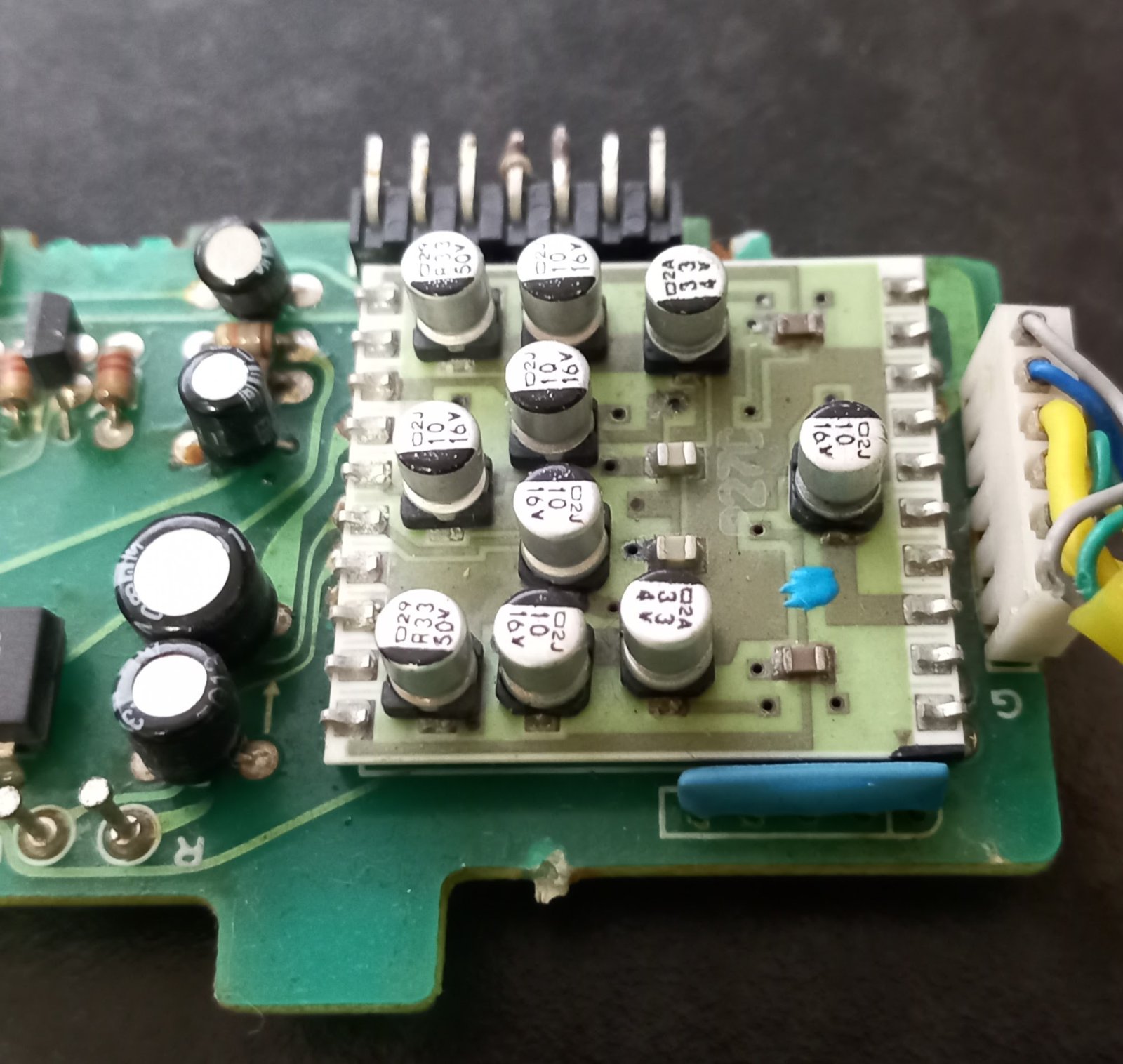

Very little progress on the XM radio today as parkrun and TT racing organisation work got in the way...
Parkrun was great fun and the TT work involved a meeting at the BikeBus Cafe - see the Pubs and Cafe's thread in OTCL - over coffee so very acceptable

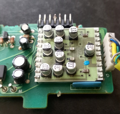

This is the Dolby and tape head preamp module in question:
This from another radio I've used as a spares source and test bed... There's lots of suspect electrolytics on the module and I can see at least one leaky one. Chances are these, known to be unreliable, are the issue. Trouble is, I need a proper desolder/rework station to properly deal with this module. Solder wick is not up to the job. I've tried and ended up damaging some critical plated-through holes.
Zel, I believe you have a good rework/desolder station. Can you advise details of it before I blindly go and buy one please? Open to recommendations too

You can't safely solder/desolder aluminium electrolytic capacitors using a hot air station, as they tend to explode with the heat.
The low thermal conductivity of air means that the hot air must be well above the melting point of solder, which is also well above the point where the capacitors can explode.
To solder those (safely), you need to heat up the substrate, either on a hot-plate, or with hot air applied from below. If there is sufficient room you can replace individual capacitors using "hot tweezers".
In the case of that module, the ceramic substrate has high thermal conductivity and maybe there are active components on the other side?
NB wear eye protection when heating those capacitors by any means.

I'm after a powerful vacuum solder sucker for this job Mike, not a hot-air rework apparatus. The module is more a thick-film assembly and those little electrolytics are on legs through the substrate that has tracks on both sides... It's not SMD in the conventional sense.xantia_v6 wrote: 17 Feb 2024, 20:18 You can't safely solder/desolder aluminium electrolytic capacitors using a hot air station, as they tend to explode with the heat.
Trust me, I know all about what an unhappy electrolytic can do, been there a few times! Likewise, little tants!
