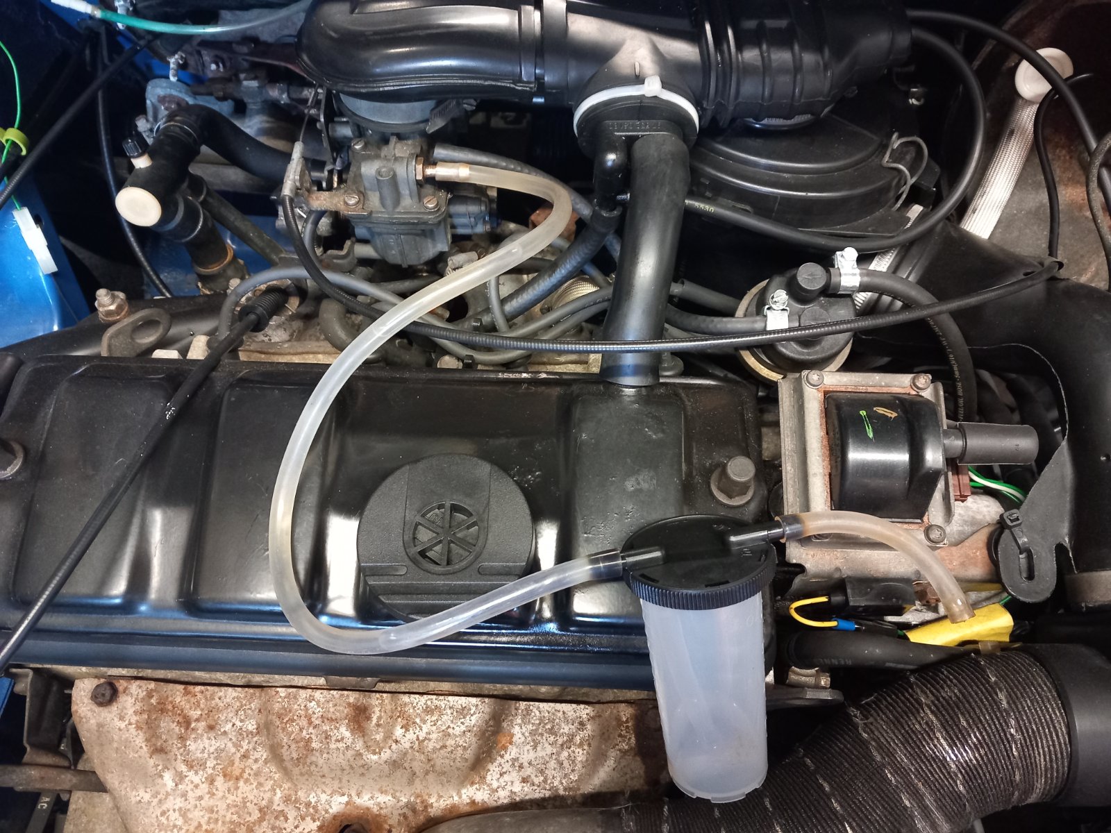

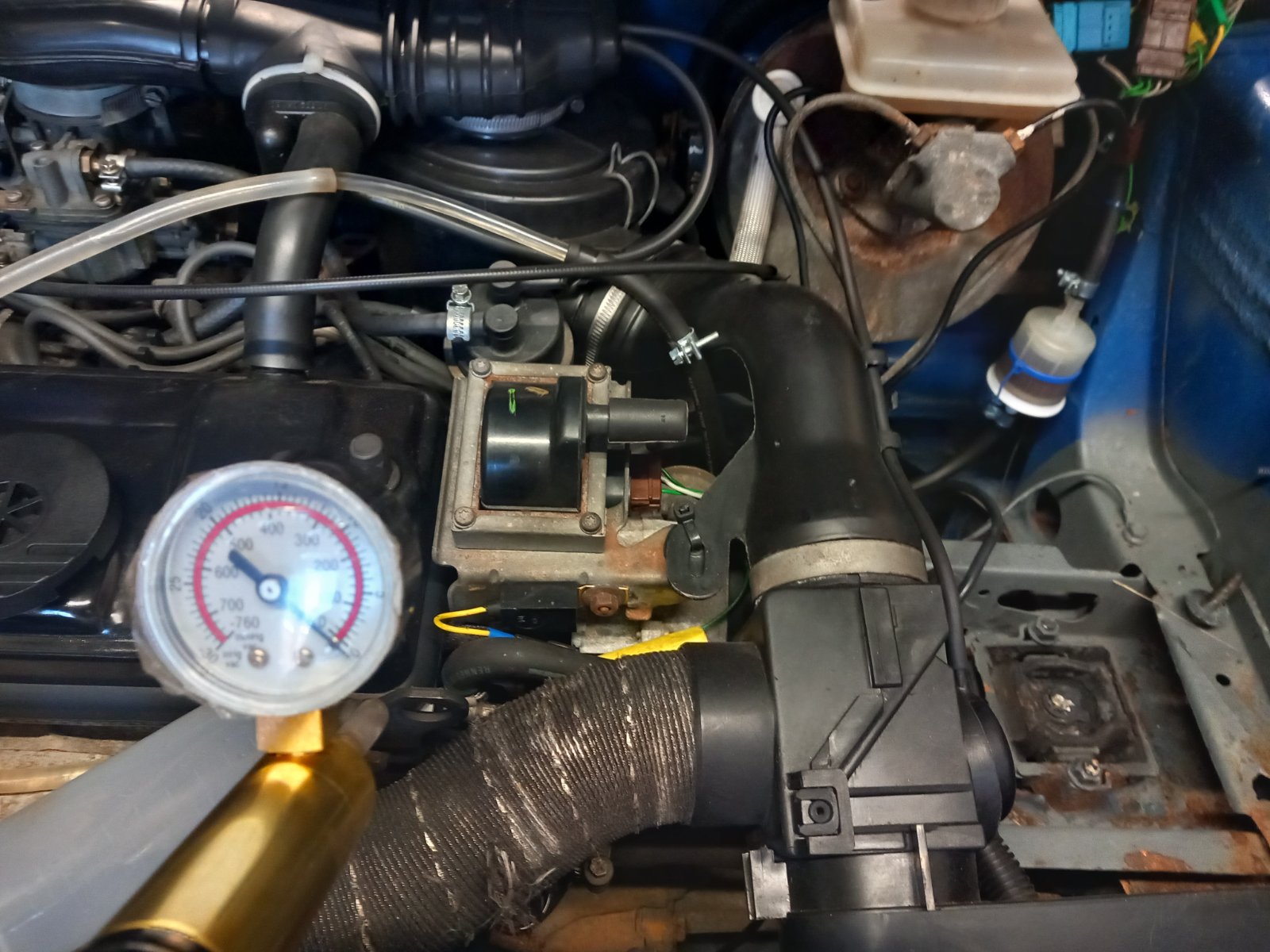

I reset Bluebell's clock to GMT and then prepared her for a warming run. When she's been standing a long time all the fuel in her fuel line runs back to the tank and thus she takes a lot of cranking to get fuel back up into her system.
To avoid battery and starter motor stress, I hit on the idea of using my vacuum tester to prime the fuel system...
Firstly, up to the pump (mechanical on the AX)...
That worked beautifully :)
Then I primed from the pump to the carb. and finally pumped what fuel I'd sucked up into the float chamber...
The pumping force for this was by mouth :)
Result... Instant start and running like a clock from the get-go :D

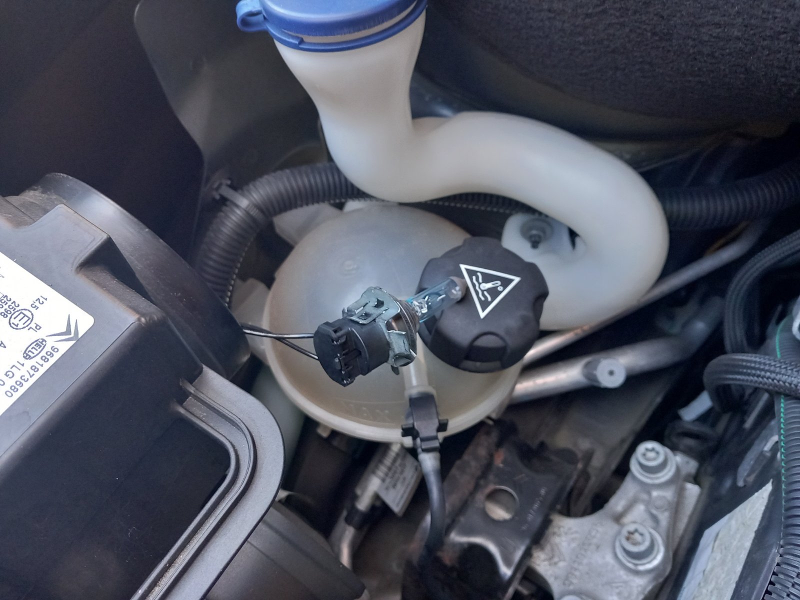

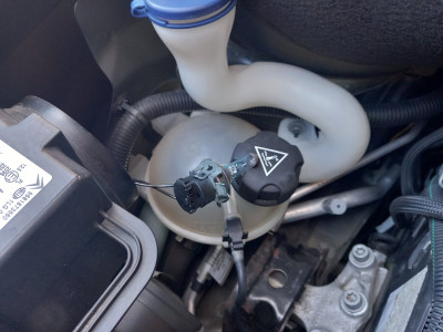

Whilst she warmed up, I swapped the other dip beam headlight bulb in Polly so that she has a matched set of bulbs as is recommended... Another very easy job :)
Even easier on the offside than on the nearside...
The good one I removed is now an emergency spare and in the car...

Regarding the fuel leaking back Jim, one of these https://www.amazon.fr/Anti-retour-Alumi ... VWOHR&th=1 placed just before the mech pump ( I'm presuming that's where the air ingress is) would sort it or a bulb, well known on the PSA diesels
Pete
Posts: 55111
x 8406
Re: Citrojim's AX, Pixo, C3, Running and Cycling Tales
moizeau wrote: 17 Nov 2023, 16:13 Regarding the fuel leaking back Jim, one of these https://www.amazon.fr/Anti-retour-Alumi ... VWOHR&th=1 placed just before the mech pump ( I'm presuming that's where the air ingress is) would sort it or a bulb, well known on the PSA diesels
I think one of those non-return valves may well be the answer Pete, thanks for that :D Given how much they cost, well worth a go and happily, I've found them on the UK Amazon site...
An order will be placed very soon...
