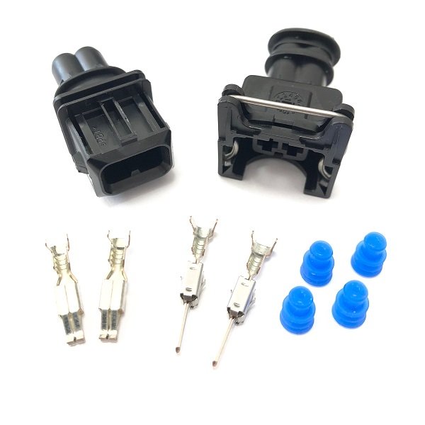

A Bit of research leads me to believe that might be a connector made by TE Connectivity......
Not necessarily this particular one, but it's of the same design.
https://www.mouser.co.uk/ProductDetail/ ... N4mw%3D%3D
Also, similar, but different.....
https://www.mouser.co.uk/ProductDetail/ ... %2Fg%3D%3D
You can have a browse at their catalogue - I've got it set to '2 position' (i.e. two pole) in the search terms.....
https://www.te.com/en/plp/automotive-co ... =false&q2=
You might strike lucky and find the right connector and be able to do a part number search and find somone selling individual ones.
Posts: 26425
Re: Falcon's Bargain Basement Motoring

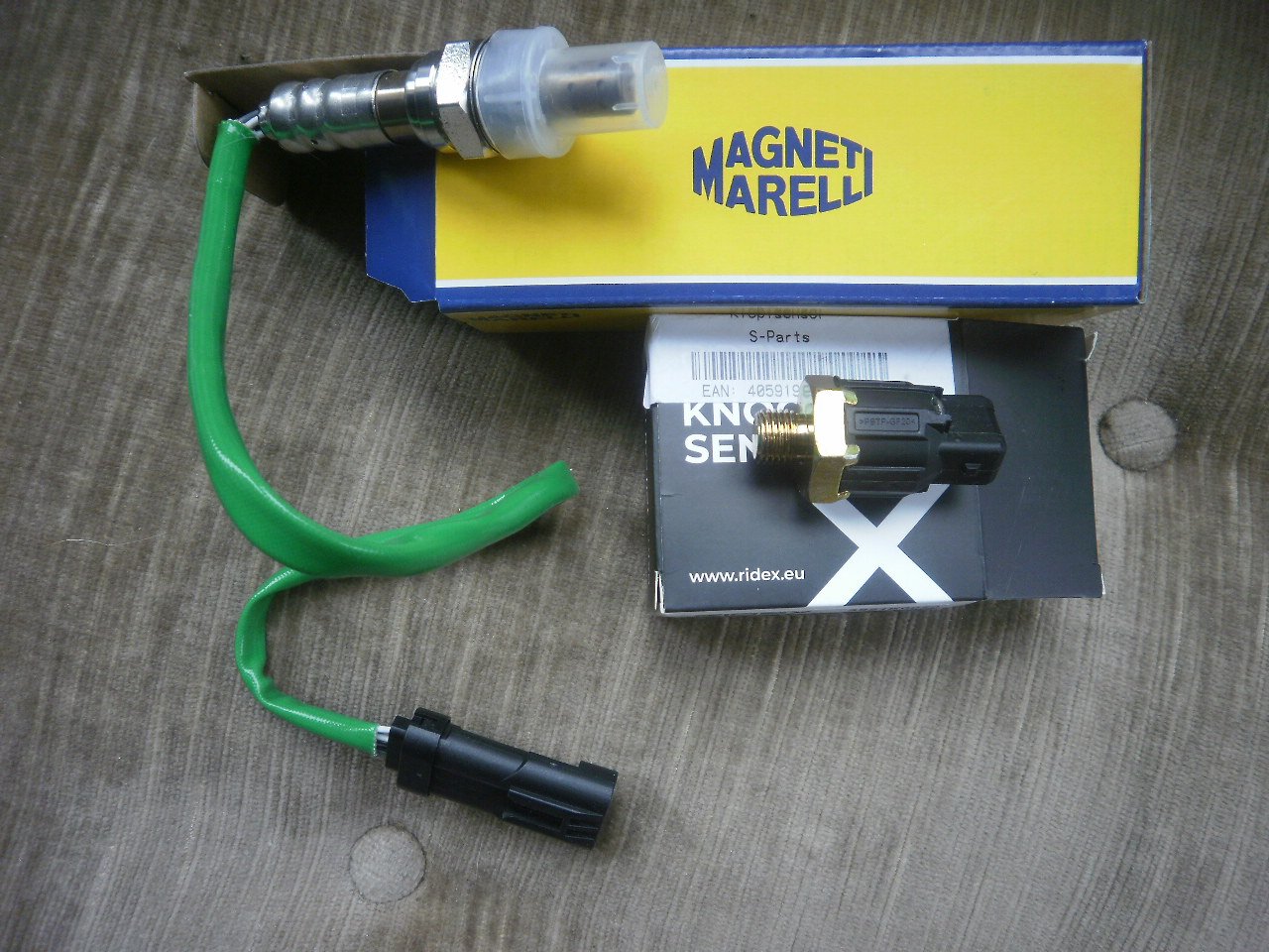

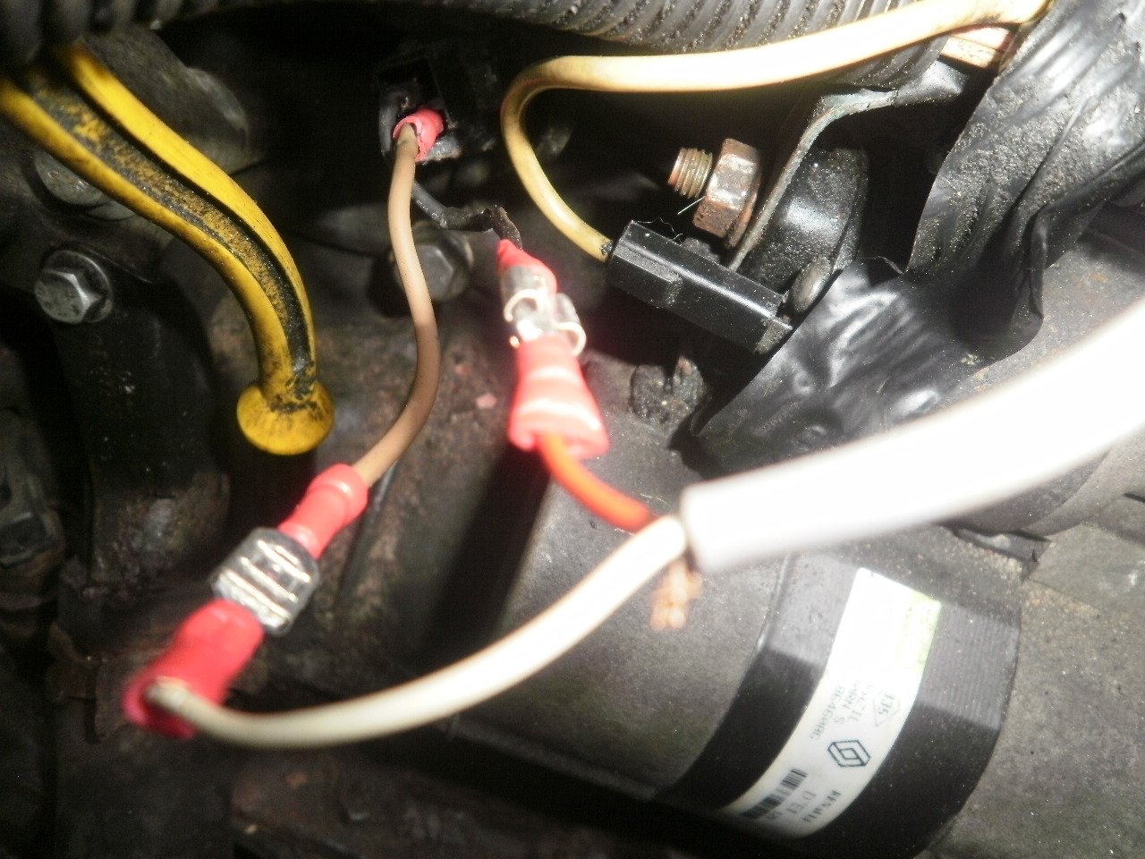

Thanks Bobins, when the new knock sensor arrives it would be better to wire it up with a suitable connector rather than my Health Robinson arrangement and they do supply the connectors in quantities of 1 for not very much!

A couple of new bits arriving from Autodoc, (O2 and Knock Sensor) but that's going to be about it.

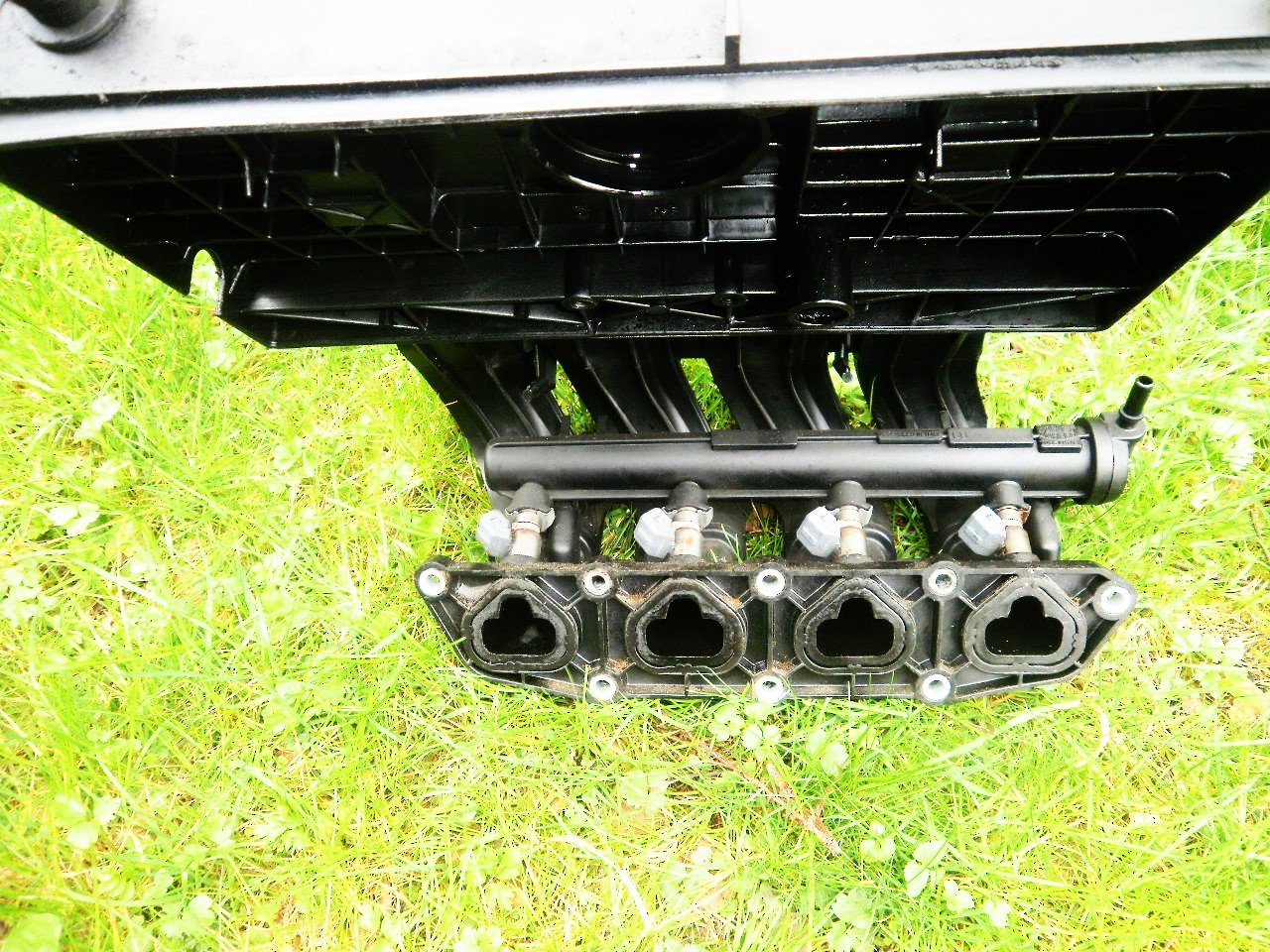

This is where I got the 50psi (3.5 bar) bit from Paul.
The D4F is a manifold injected petrol engine, with Multi point Injection with one fuel injector per cylinder
NewcastleFalcon wrote: 02 Apr 2026, 10:29 From my well thumbed through Haynes (sans covers now...)
D4F Fuel Pressure regulator control pressure 3.5 Bars Plus or Minus 0.06 bars
Fuel Pump Flow Output 80-100 litres/hour at 3.5 Bars fuel pressure.
Posts: 9456
Joined: 07 May 2009, 16:24
x 1946
Unread post by Paul-R »
Ah, I forgot about the early attempts. Out of interest, is that single or multi point injection?
Posts: 26425
Multi Point Injection, one fuel injector per cylinder discharging into the plastic air intake manifold! at the inlet ports.

Never quite got round to passing my de-pinning automotive electrical connectors badge, hence the current heath robinson arrangement.
I note on a trawl round of these things that the connectors of the type required are often referred to as "Junior Power Timer Connectors" and occasionally come with "Pin Sets", grommets and wire terminations you assemble yourself. like this
https://www.almsolutions.co.uk/terminals-connectors/junior-timer-connectors/full-connector-kits/2-way-junior-power-timer-connector-kit-with-terminals-seals
Posts: 21345
x 8156
Sometimes I have to wonder if designers make things far more difficult than needed for the job in hand, simply to protect their own existence!! When you look at it the plug introduces 3 potential fault areas for each wire. Feed wire to its pin, pin to socket and socket to distribution wire means three junctions where you only need one, wire to wire. Make the wires longer and bring back soldering I say!!! :-D

Haven't fitted the new knock sensor or the new O2 sensor yet, and the gubbins for the knock sensor connector wont arrive until sometime next week.

Swopped the pre-cat O2 sensor, not for the brand new one but another which I removed when I did the Front downpipe and the cat a couple of years back.
Not a single hesitation, stutter, code thrown up or engine management light on, and a distinctly "normal feel". on the drive.
