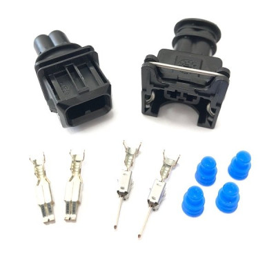

A Bit of research leads me to believe that might be a connector made by TE Connectivity......
Not necessarily this particular one, but it's of the same design.
https://www.mouser.co.uk/ProductDetail/ ... N4mw%3D%3D
Also, similar, but different.....
https://www.mouser.co.uk/ProductDetail/ ... %2Fg%3D%3D
You can have a browse at their catalogue - I've got it set to '2 position' (i.e. two pole) in the search terms.....
https://www.te.com/en/plp/automotive-co ... =false&q2=
You might strike lucky and find the right connector and be able to do a part number search and find somone selling individual ones.

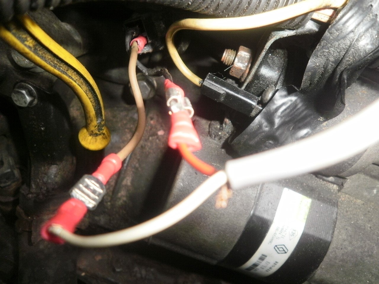

Thanks Bobins, when the new knock sensor arrives it would be better to wire it up with a suitable connector rather than my Health Robinson arrangement and they do supply the connectors in quantities of 1 for not very much!

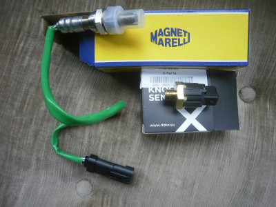

Saw this lying around, so decided to fit it. Bit of a looser fit than the old one, so out came the gaffer tape for a bit of clagging down just for good measure.
I know if given a decent revving its very responsive and has plenty of poke. My goals for the Clio are very modest though, nothing more than a smooth non-chuggy take up on a gentle progression through the gears changing up at around 2000 revs, and for most of the rest of the drive flicking between 4th and 5th as necessary.
Some progress on that front on a training drive for the new sensor/ECU. The out run put up P0130 within a couple of miles. Stopped, cleared it and it never appeared again. Purposely went for a smooth progression up to fifth on each restart and the Clio started to feel "normal" "Acceptable" "OK" in that aspect of driving. Put £10 of Shell V-Power in and half a bottle of Redex, and I am just about beginning to think it may have a beneficial effect. More in cleaning up the tank crud or in tank pump/filter crud rather than in "cleaning 'clogged' injectors" which I am sure Shell V-Power pulsating through at 50psi/50 times/second even at 2000 revs will take care of itself.
Those who enjoy a bit of maths could maybe fact check that! (I took is straight form an AI question.!)

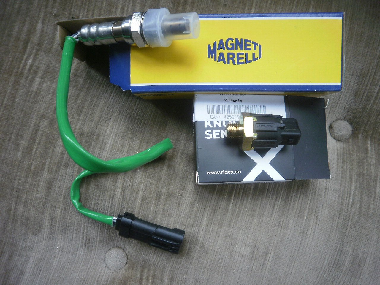

A couple of new bits arriving from Autodoc, (O2 and Knock Sensor) but that's going to be about it.

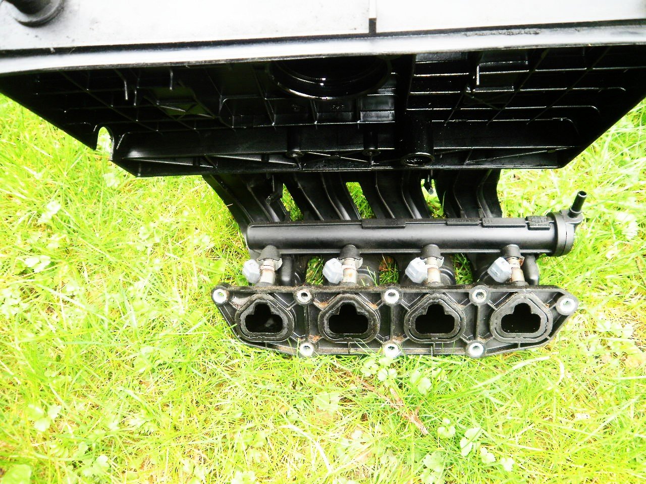

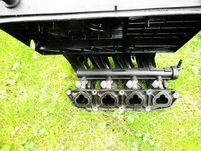

Ah, I forgot about the early attempts. Out of interest, is that single or multi point injection?
Posts: 26422
x 7163
Re: Falcon's Bargain Basement Motoring
Multi Point Injection, one fuel injector per cylinder discharging into the plastic air intake manifold! at the inlet ports.

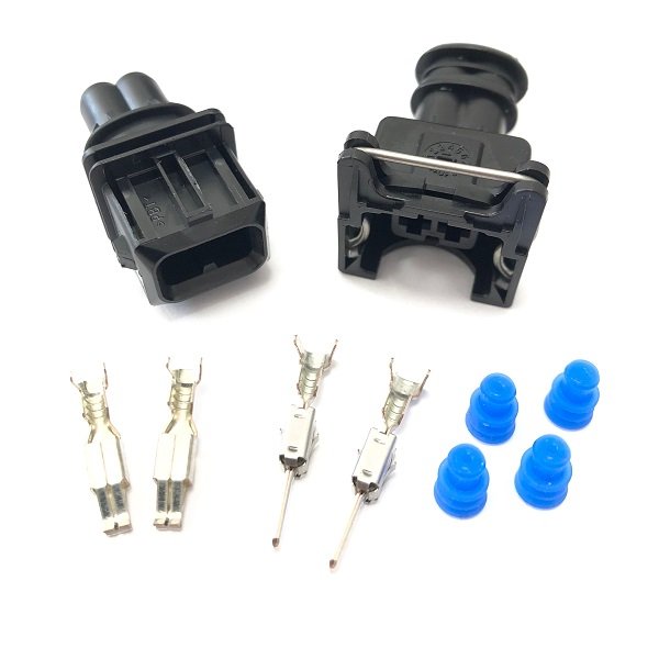

Never quite got round to passing my de-pinning automotive electrical connectors badge, hence the current heath robinson arrangement.
I note on a trawl round of these things that the connectors of the type required are often referred to as "Junior Power Timer Connectors" and occasionally come with "Pin Sets", grommets and wire terminations you assemble yourself. like this
https://www.almsolutions.co.uk/terminals-connectors/junior-timer-connectors/full-connector-kits/2-way-junior-power-timer-connector-kit-with-terminals-seals

Sometimes I have to wonder if designers make things far more difficult than needed for the job in hand, simply to protect their own existence!! When you look at it the plug introduces 3 potential fault areas for each wire. Feed wire to its pin, pin to socket and socket to distribution wire means three junctions where you only need one, wire to wire. Make the wires longer and bring back soldering I say!!! :-D

Had I been demonstrating today's run out in the Clio, I think a potential buyer would have been impressed with the free-revving poke it has up to 6000 revs, and on returning home to do the deal, its ticking over at idle like a gently purring sewing machine. No codes or EML lights on the trip out or back.
Haven't fitted the new knock sensor or the new O2 sensor yet, and the gubbins for the knock sensor connector wont arrive until sometime next week.
I'll keep those new bits in reserve for now. Its like the car is on a bit of a pre-season training. Drinking the right stuff (Vpower and Redex!) and being put through its paces, building up into some impressive sprints and recoveries and a bit of endurance work hopefully to return to a level of fitness to sustain it for the season! Not sure it needs the new bits...just a bit more training!
Posts: 26422
x 7163
One promising training run after another.
Swopped the pre-cat O2 sensor, not for the brand new one but another which I removed when I did the Front downpipe and the cat a couple of years back.
Not a single hesitation, stutter, code thrown up or engine management light on, and a distinctly "normal feel". on the drive.
Time to end the tinkering and start the moving on process...taxing and insuring a surplus car is not what bargain basement motoring is about!
