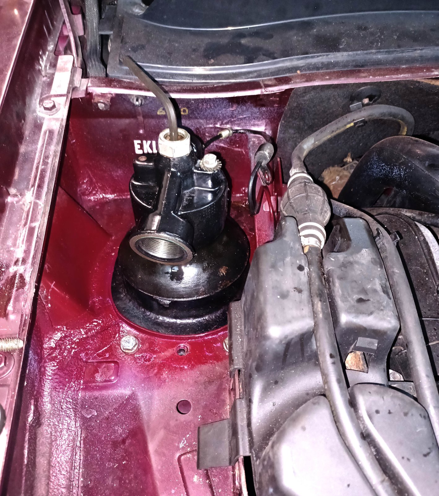

Steering rack is IN !....struggles with the heat shield (get it in first, tucked up tight to the exhaust or it is a pain !..it was for me
Long spanners are a pain, get a set of stubby ones to avoid the 1/20th of a turn game.
Inset the main pressure pipe into the ram body first as the return one gets in the way a bit when tightening and is hard to insert into/compress the seal/get the thread started.

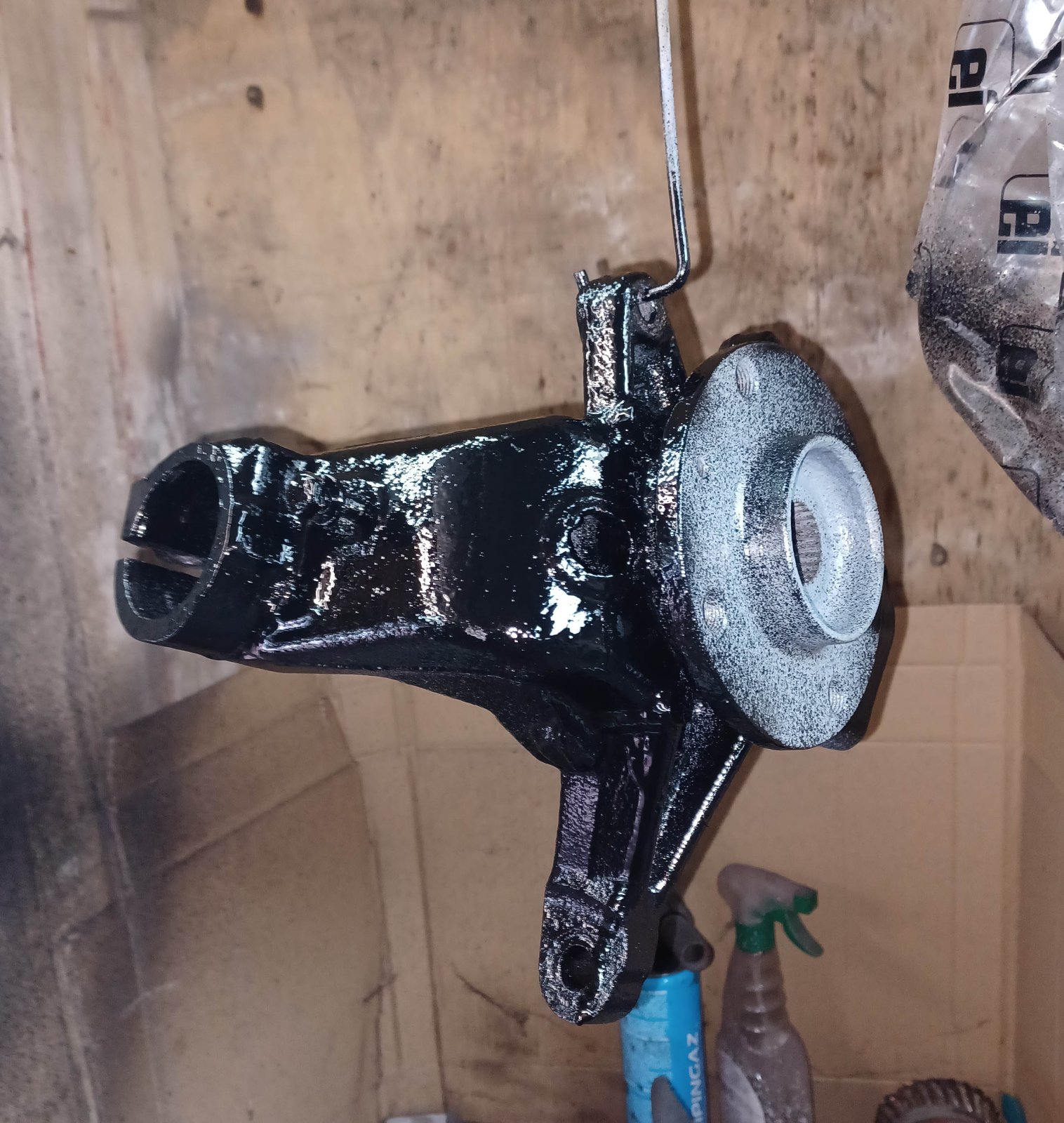

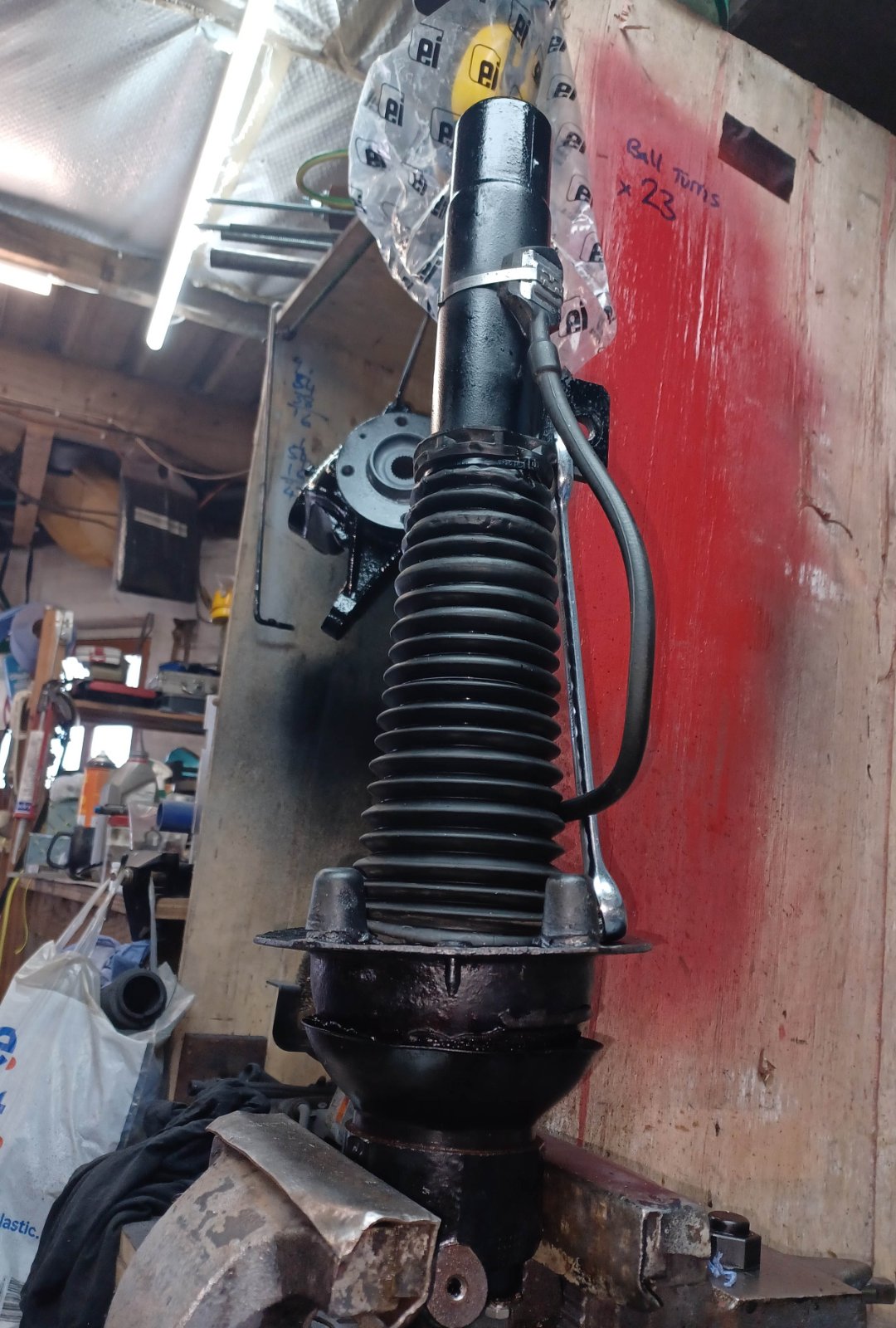

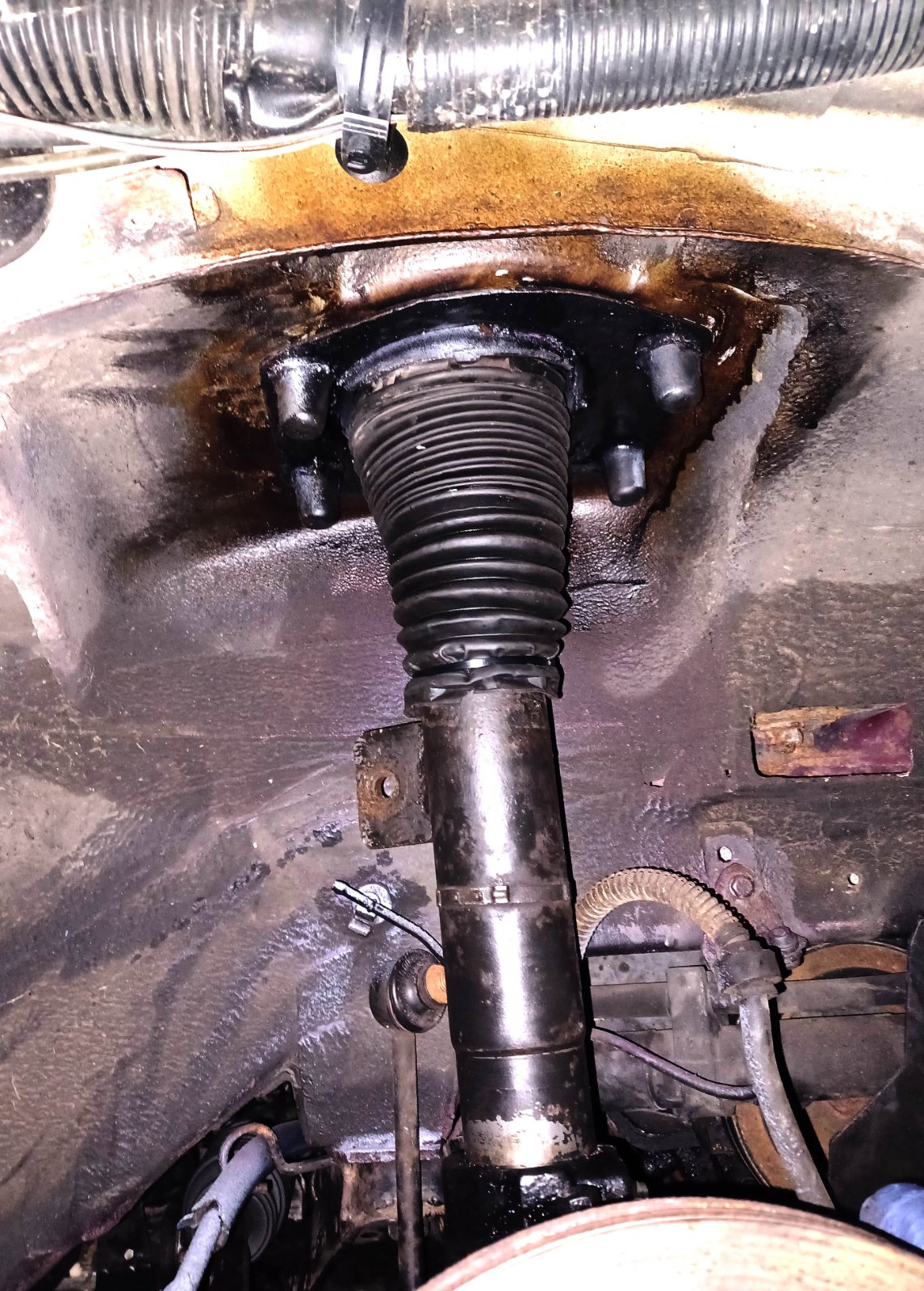

Also rebuilt the strut with a new piston, after a very close inspection and a good clean up I have decided to reuse the strut top as the internal rubber is in good shape with the corrosion limited to the outer mounting plate and its covering "rubber gasket". This will be protected for the future with copious amounts of Bilt & Hamber underseal. The thin rubber covering (engine bay side) which also has degraded will also be covered but with a layer of black PU sealant/adhesive as that has also been cleaned up with a wire wheel/de-rusted but I do not wish to use underseal where hands might go later. Additionally the new bearing is now in the hub carrier, cleaned, de-rusted with a wire wheel and chemicals/painted with zinc then black.
