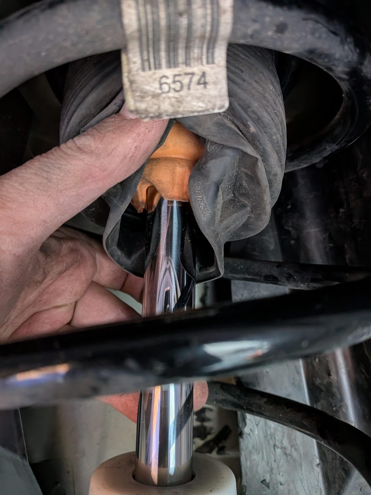

Think I might have the answer....finally.
My knocking supension noise has annoyed me since I got the car. It's off for a shaker plate test tomorrow. I had the front wheel off over the weekend and just had a general check out of the area and components. Lifted the dust cover and off the ground there was maybe 10cm-12cm between the bumpstop and the white buffer at the bottom, as per pic.
However I've just been downstairs and wondered what that gap is when the car is on the ground. Lifted up the dust cover and I can't even fit 2 of my thin fingers in side by side. I guess the distance is 25mm-30mm which reading around just sounds far too low.
I think it's just been hitting the bump stops which is why im getting the thuds.
