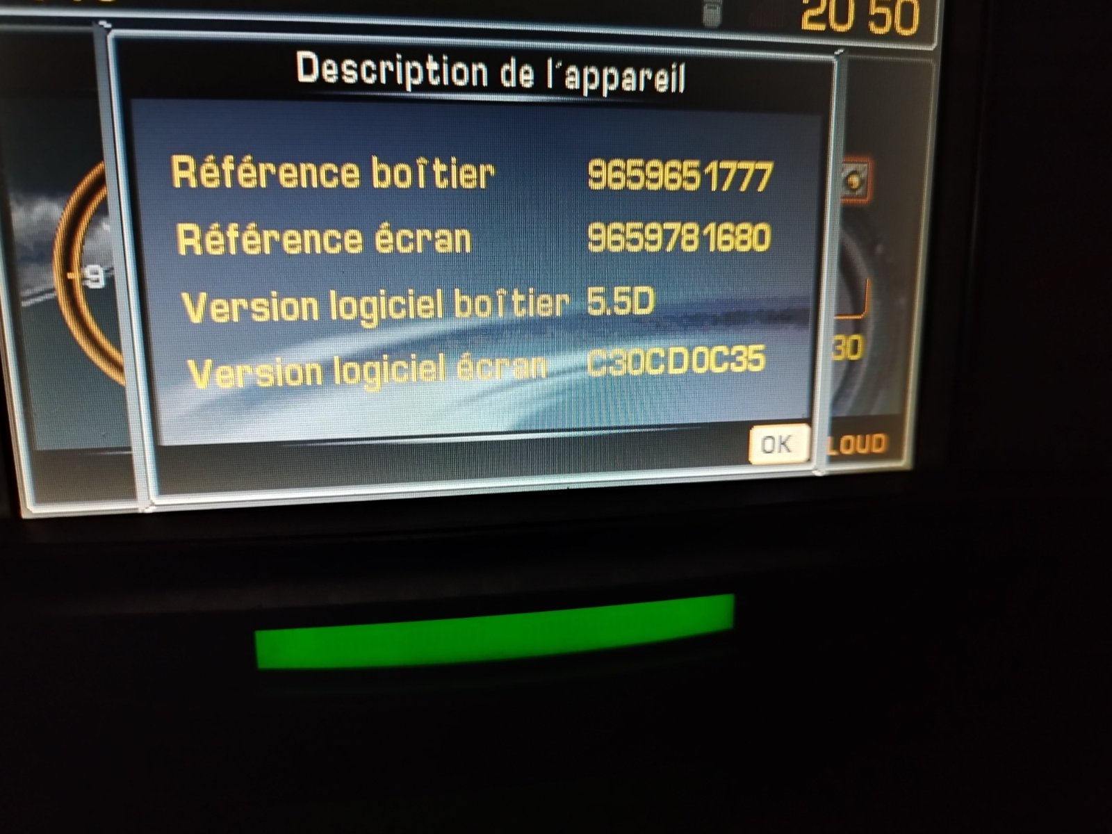

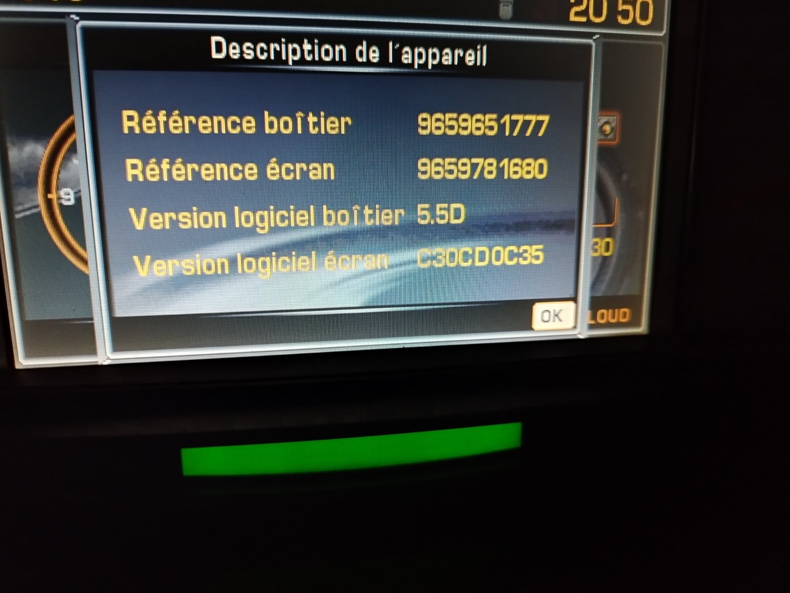

As I managed to get cd unit working again by swapping it for another one, I changed language from Italian to English with the 5.5 cd I had. However I’m wondering whether you have soft with polish language?
Version of my current soft is 5.5D
Change language RT3

Not unless it is one of the languages supported at the time the software was written. They don't support or update these units now as they're too old.

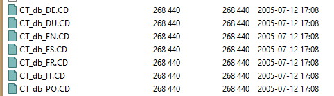

However if you have the V5.5 then it is a VAN Network system. I checked the versions I have and when opening up the 5.50 to 5.95 Upgrade CD, I see that there are the following:
files listed within the ISO:
If the one shown with 'PO' is Polish, then that language may be available, but equally, it may just be info regarding the mapping CDs and nothing more. The only languages available will
be what are shown when you opt to choose the language when it asks you to input the firmware CD.

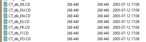

Po probably stands for Portugal. I would expect PL for Poland . Anyway, is there some major difference in these two soft versions ?
Not sure if I need it if I’m after language change that is unavailable in newer version.

Unless there's a need to update, leave your unit as it is, as there have been issues with people updating only to find something was affected they couldn't fix.
Agree about the language. It will be on your existing Firmware CD if available.

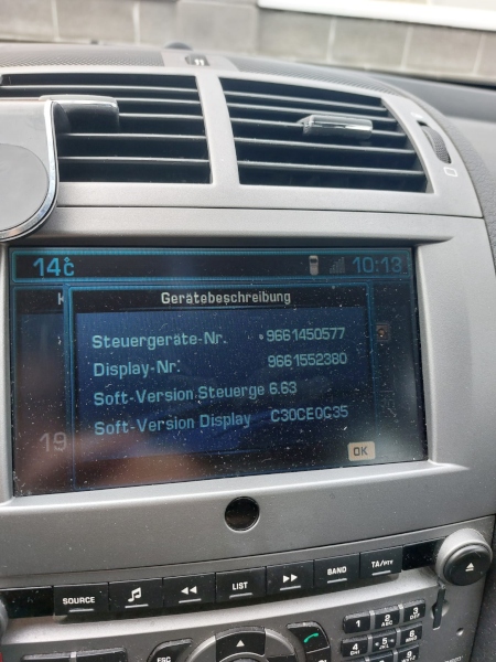

Hey lads!
Recently became owner of Peugeot 407 2006 and it came with German language on it's RT3. Of course no CD in sight and I want it changed to English as it pokes my eyes as I drive
Attaching photo of version info, appreciate any help and tips!
