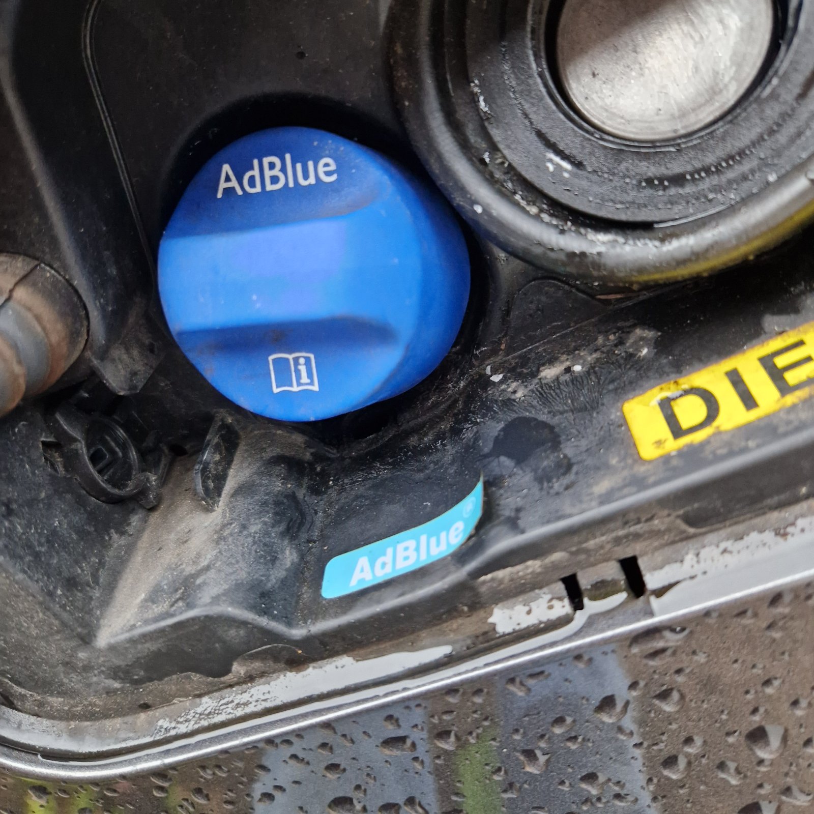

BTW, I've just checked and I don't think that I have a modified AdBlue cap fitted on my car.

The cap only applies to early cars - the modified design was fitted as std from about 2016 when the filler was in the car. I suspect yours has a breather elsewhere.

Thanks RichardW, the cap info is reassuring. I take your point about the checks that they need to carry out and about me not having to pay for them playing "parts darts" however, I have no idea how to realistically prevent this! No, I don't trust them, or their ability and the many cases of owners being ripped off an mistreated only supports my distrust, but I'm a retired builder, with little knowledge of modern car mechanics. They have me over a barrel and there's little that I can do about it!
