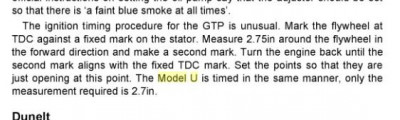

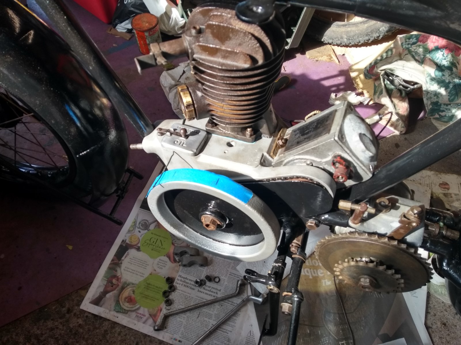

I have a feeling that your ignition timing is wrong, I would expect the timing mark on the flywheel (imaginary in this case, I know) to be much closer to TDC, maybe 0.27"?RichardW wrote: 01 Aug 2019, 21:41

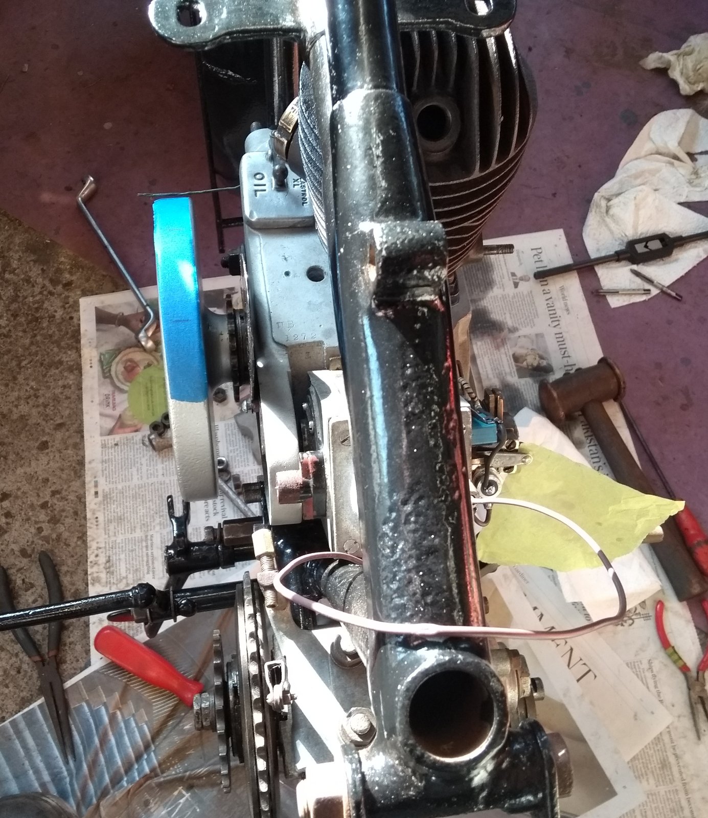

Setting the timing - no computer required here, the essential tools are masking tape, a bit of old wire, and some tissue paper (not having any fag papers!)
Was unsure what advance to set but I found some info on the web that it should be set to 2.7" on the circumference of the flywheel. This seems to be 35 or so degrees, which sounds like a lot, but it's full advance setting, so we'll see how it goes.

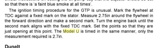

This is the info I set it against:
The circumference of the flywheel is about 27" so 2.7" reflects about 36deg advance. The range of the advance mech on the mag seems to be about 30deg, so putting it on full retard would give maybe 5deg of advance. I might try that.

A little tinkering yesterday... Set the timing back to 15deg, filed down a copper washer for the decompressor then stripped the carb down again. I poked out the idle orifice - it did appear to be blocked. Then had another go at starting it, but still no go on petrol only - only Easy Start it definitely ran a few compression strokes!! But then I put the tin down behind the kick start and stamped on it when kicking and broke the valve, so that stopped play
It might just be possible if it's firing on easy start to catch it on the throttle and open the main venturi to see if that will make it run - I didn't manage this as I was so surprised it appeared to going by itself!! Interestingly on this carb, the choke has no effect on idle running as the air is taken in separately. I still think a compression test is in order, if only to rule it out for peace of mind.

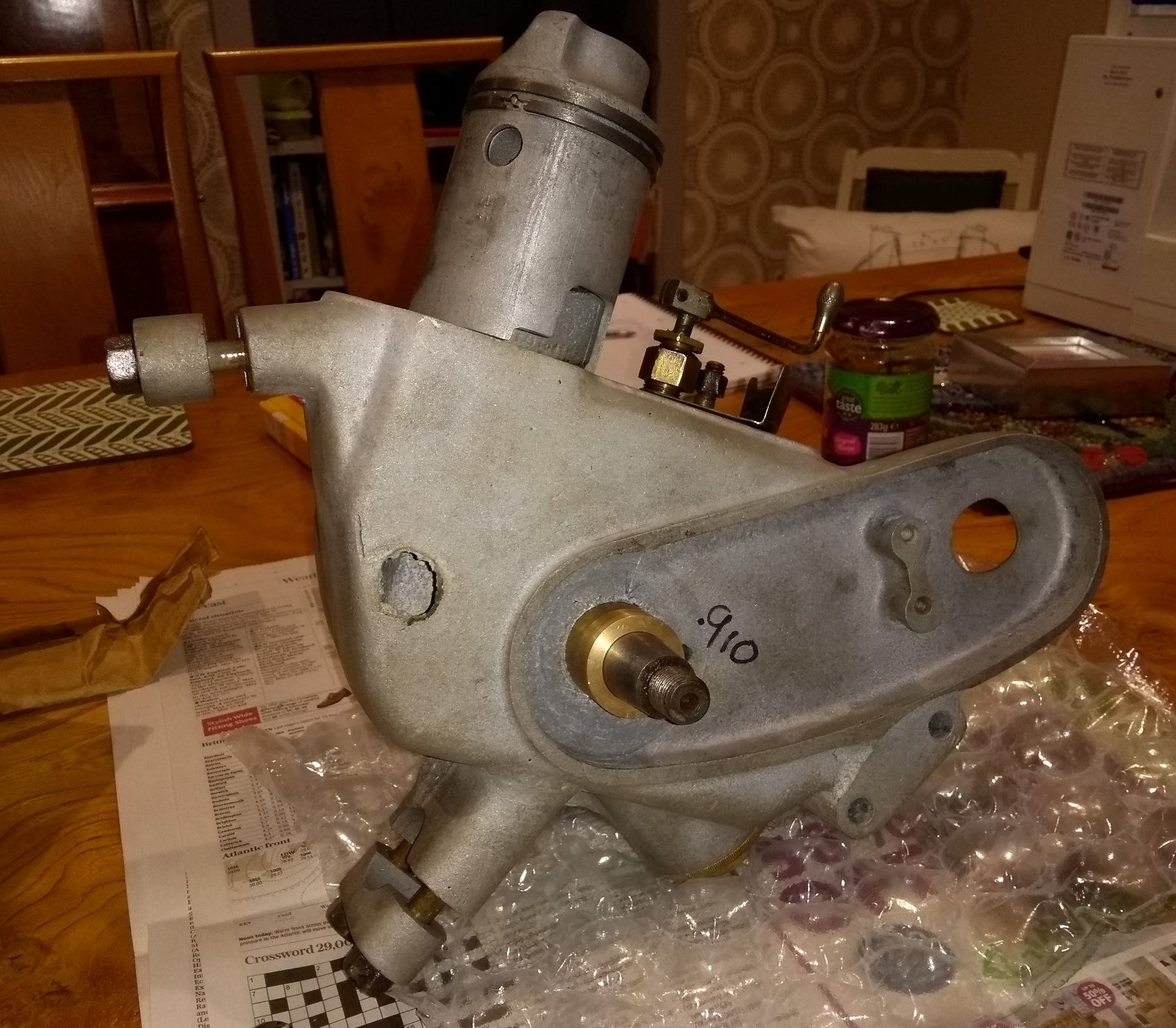

Just read through the whole thread again, you haven't mentioned anything about which way the piston went in. On 2 strokes there is normally an arrow that points towards the front. If they're fitted 180 degrees out they give your symptoms. This is on much newer engines (70's onwards) though and may not be relevant.

I'm sure I've got the piston in the right way round - this pic shows the piston - there is a substantial cut out on the skirt which aligns with the transfer port on the back of the engine. Actually I think the cut out allows the con rod to pass, and if it was in the wrong way round it wouldn't go round
There's no oil pump - there's a drilling between the oil sump (which is what most of the crankcase is) through the crank shaft bush to the crank shaft. There are then oil ways and drillings in the crank shaft so that the oil is sucked along the crank shaft, and then thrown out along the crankpin to oil the big end before being mixed with the petrol in the crank case, before transferring to the cylinder. The oil lever varies the amount of oil by adjusting a needle valve dropping into the drilling in the crank shaft. Got it about in the middle at the mo, could set it to min I guess.
