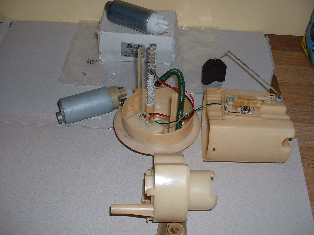

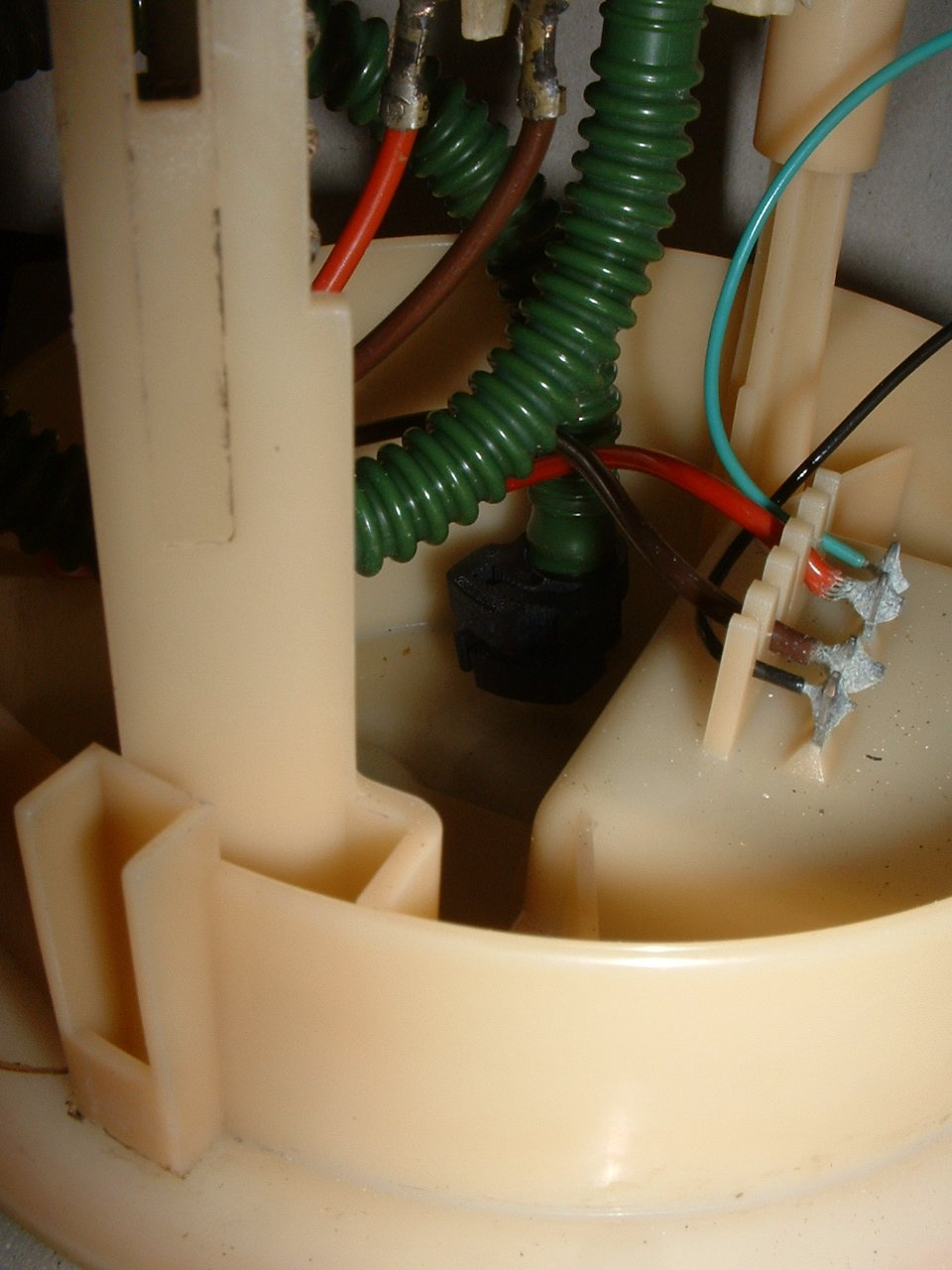

Well I've had 2 test runs and there is some improvementSkull wrote: 02 Jun 2019, 15:02
Had a play with the old pump (no flow rating marked) whilst I've got it out ran it in a bucket of water to see flow rate as Admiral51 suggested into a bucket - emptied 4 Litres out of the bucket in 1m40s....so over 120 Ltr/hr would seem sufficient (even though there is some internal leakage on the upper join of the pipe).
The pump strips down OK apart from the green plastic corrugated pipe that appears a push fit but even after warming with a hair dryer seems reluctant to come off, so even if I did use the new motor the pipework would probably need replacing as well but having confirmed the flow rate looks ok on the old pump I'm inclined just to put it all back together (try to slow the internal leak with plastic tie wrap) and move to the next stage of elimination ......
When I ran the flow test in a bucket of water there was some leakage from the upper join which was visible but when I think back to that test 2 things occurred to me:
1. The outlet was free flowing with no resistance in the pipe (simulating pressure with my thumb over the end of the pipe would probably make the internal leak increase).
2. The lower join could also be leaking but not apparent as it was submerged under the water level.
Whilst searching for replacement pumps I have noticed that some of these type of pumps have clamps on the internal hose joins but there wasn't any on mine and I also wonder whether these joints could have opened up due to the long term storage that this car has experienced.
So I will remove the pump again
or failing that replace the pipe with some suitable fuel line and clamps .....

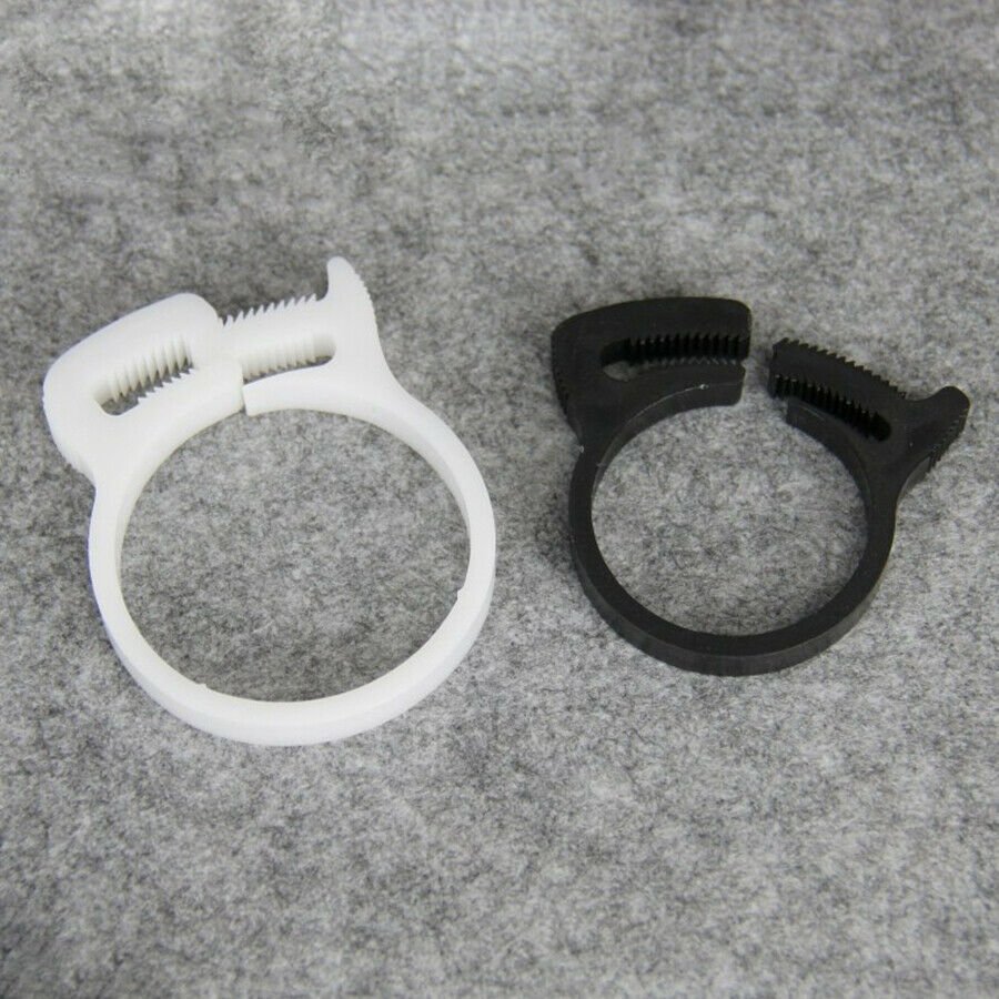

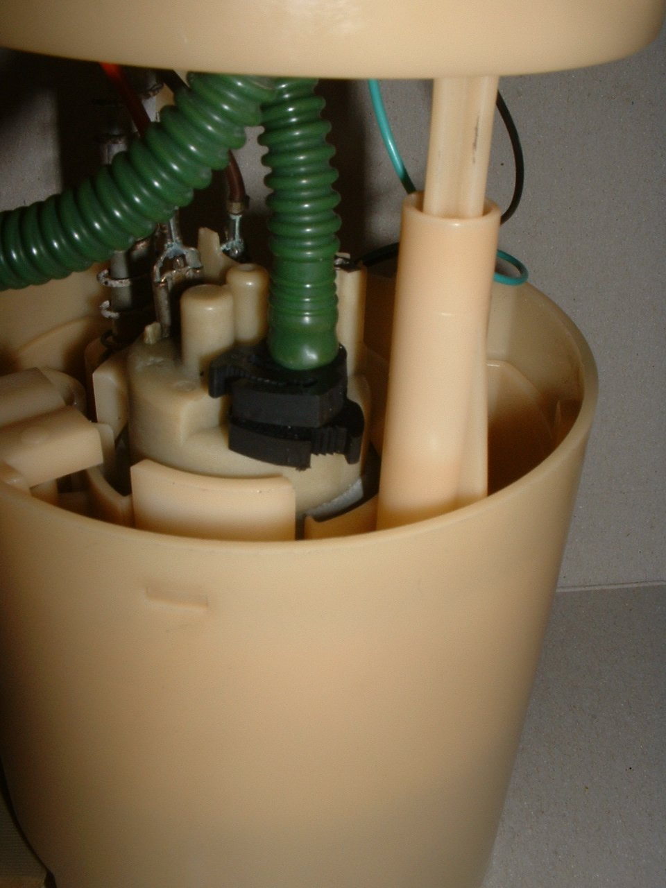

Re: My first Activa
Herbie Clip HC-B 7.9 - 9.2 (eBay item number:142655726135)
£3.58 for 10 clips arrived and although they fit as pictured (black) I put 2 on each pipe end and they open up enough to slip on the pipe without removing an end so ideal as saves replacing the old pipe.
HC-BB 9.2 - 10.3 would be ideal I think allowing more teeth to engage securely.
Pump to re-fit and test drive ....

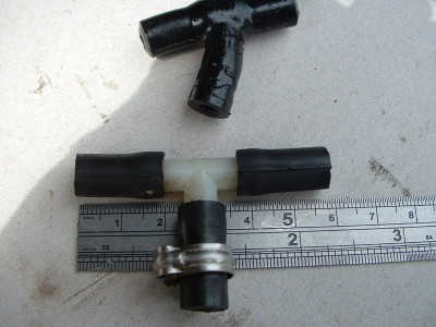

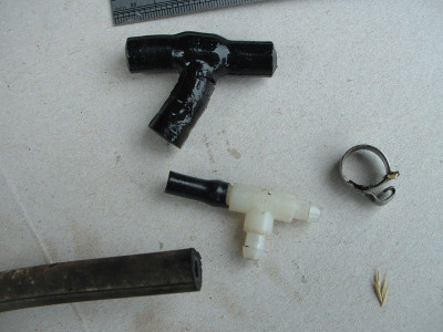

Re: My first Activa
Intermission break ...

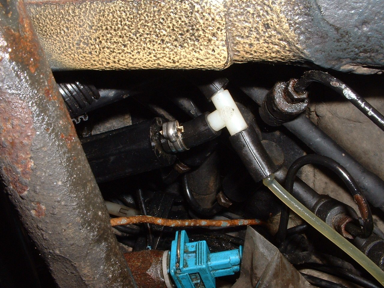

Got a leaky T piece on the return line from front safety valve 5451210 NFP
Had a look online with no luck so far .... anyone got a spare one or two ?

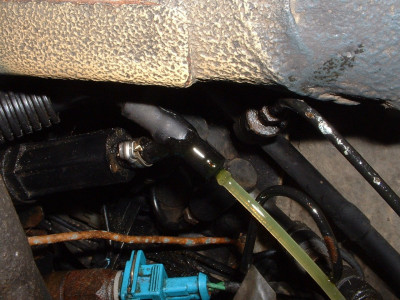

Re: My first Activa
Used the hose off the old front suspension leg leak off to make another T piece with an old windscreen washer T piece .... pictures best story ...
Many Thanks for input on SALE/WANTED PAGE guys

Re: My first Activa
Looks like some pipes need a little protection in there mate....
Skull
- (Donor 2026)
- Posts: 1379
- Joined: 02 Aug 2013, 13:35
- x 379
Re: My first Activa
Alasdair yes mate I've slapped some grease on them
could probably do with something heavier on them as the grease does seem to disappear after a while.

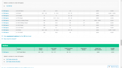

Going to see if I can get anywhere near this 9.7 sec 0-60 (AC)
Parkers
Having read the Activa engine thread I think I need a drive in a standard one to see how they SHOULD run ....
Parkers

Re: My first Activa
Skull wrote: 20 Dec 2018, 20:28 A few miles run since the test and the engine seems reluctant to rev![]()
I haven't took it out of town yet so a little premature but should there be a 'kick' at certain revs on the 2.0 8v Turbo![]()
At the moment my HDi feels faster and that is the one I'm using for the distance journeys at the moment.
I wasn't wrong but it's worse than I thought .....even though the fuel supply is improved with the clips on the fuel pump, power is obviously still nowhere near what it should be
Skull's 0-60's
HDi (10.5 sec) 12's
Activa (9.7 sec) 16's
