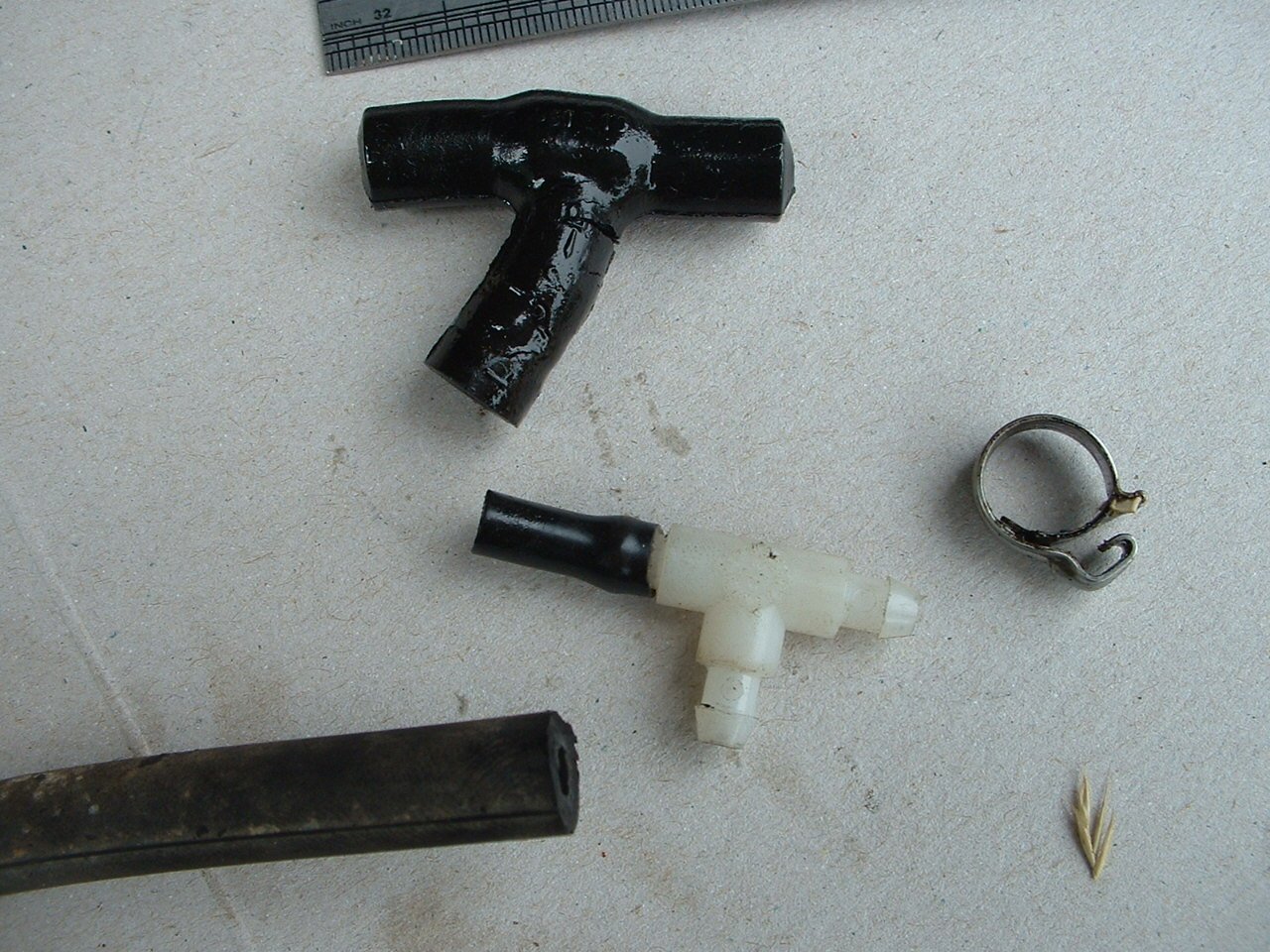

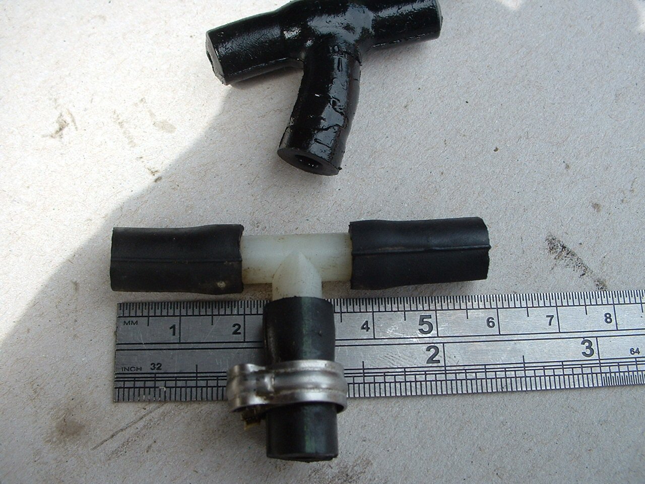

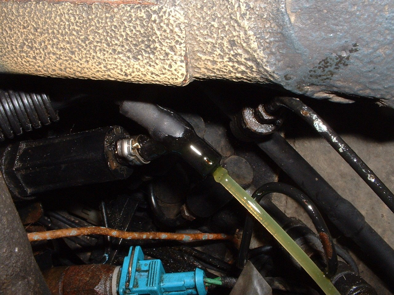

Re: My first Activa
Used the hose off the old front suspension leg leak off to make another T piece with an old windscreen washer T piece .... pictures best story ...
Many Thanks for input on SALE/WANTED PAGE guys

Re: My first Activa
Looks like some pipes need a little protection in there mate....

Re: My first Activa
Alasdair yes mate I've slapped some grease on them
could probably do with something heavier on them as the grease does seem to disappear after a while.

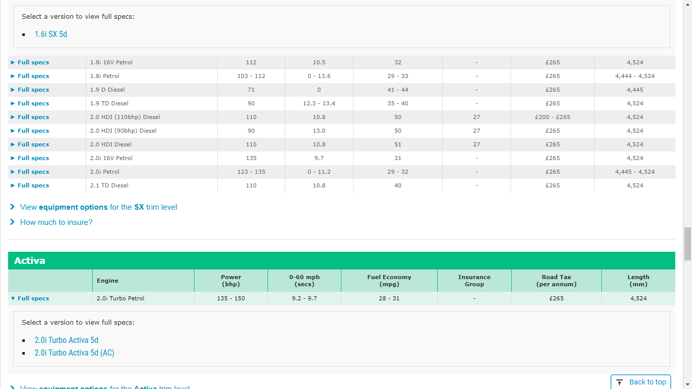

Re: My first Activa
Going to see if I can get anywhere near this 9.7 sec 0-60 (AC)
Parkers
Having read the Activa engine thread I think I need a drive in a standard one to see how they SHOULD run ....
Parkers

Re: My first Activa
Skull wrote: 20 Dec 2018, 20:28 A few miles run since the test and the engine seems reluctant to rev![]()
I haven't took it out of town yet so a little premature but should there be a 'kick' at certain revs on the 2.0 8v Turbo![]()
At the moment my HDi feels faster and that is the one I'm using for the distance journeys at the moment.
I wasn't wrong but it's worse than I thought .....even though the fuel supply is improved with the clips on the fuel pump, power is obviously still nowhere near what it should be
Skull's 0-60's
HDi (10.5 sec) 12's
Activa (9.7 sec) 16's
