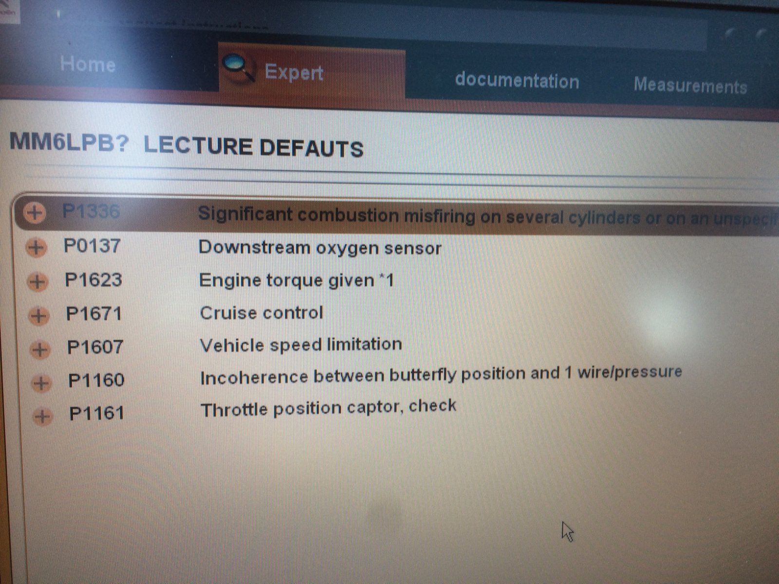

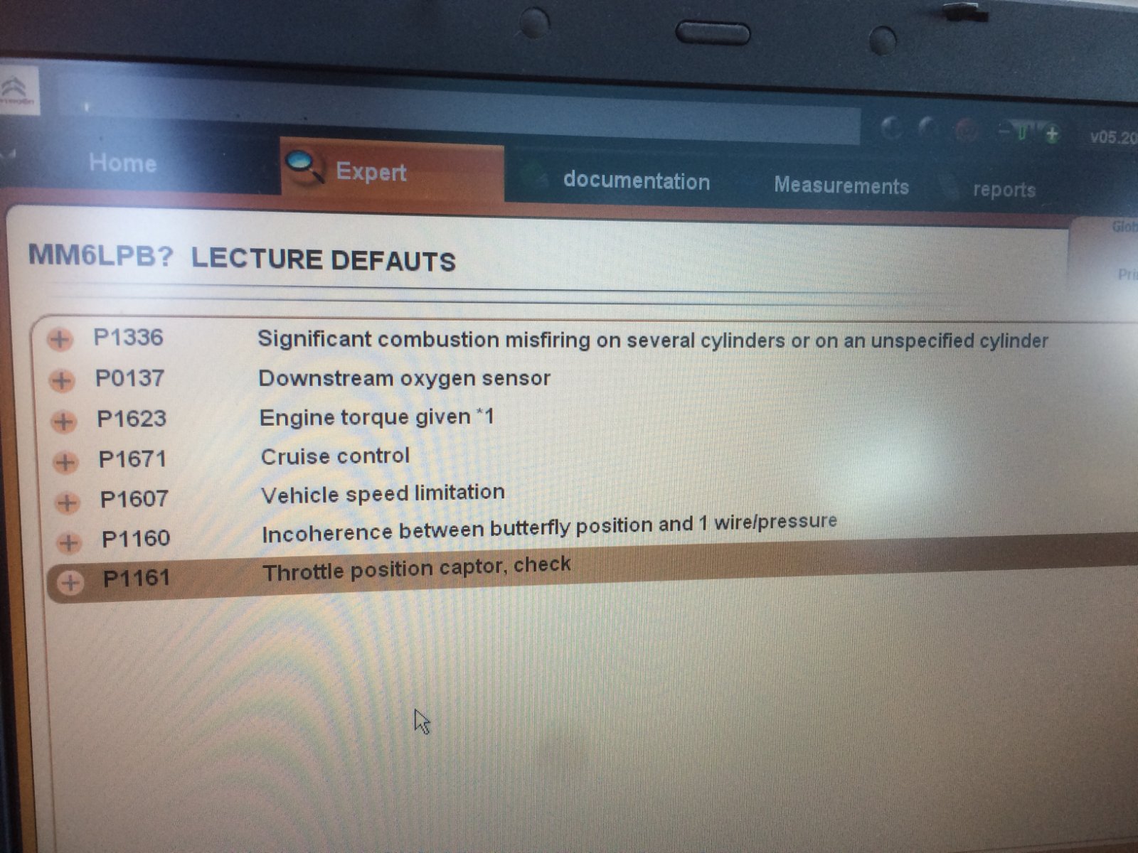

I am now totally confused by this!
I finally got Lexia/Diagbox to work again after reinstalling Windows three times due to Lexia refusing to install without errors. Now I have these faults
So now a missfire? Could that be a failing Coil pack?
Also P1623-Engine torque given *1 What does this even mean?
Plus what was interpreted as intake manifold leak P1160, is now shown as incoherence between butterfly position and 1 wire/pressure

If you look at the mileage and engine RPM where each of those faults occurred, how do they relate to when the car went into limp mode?

xantia_v6 wrote: 13 May 2018, 21:22 If you look at the mileage and engine RPM where each of those faults occurred, how do they relate to when the car went into limp mode?
No idea, somehow this time the report didn't get saved, so I only have the photos. I cleared the faults and will drive it a bit before reading any codes again.

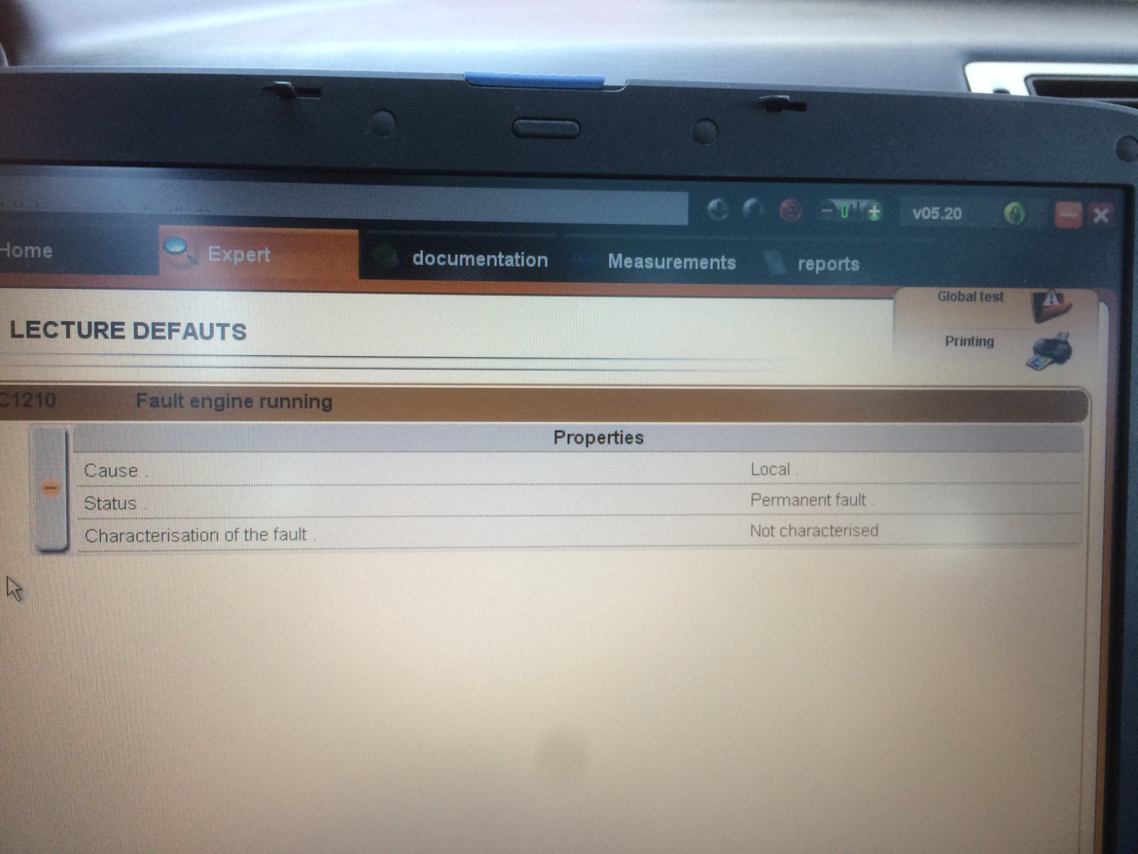

I still don't know (mine always gives faults I didn't know it had on Lexia/Diagbox)
