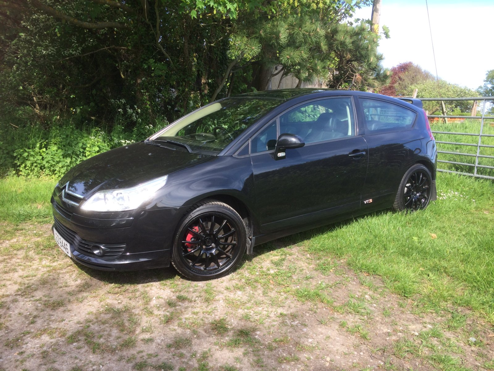

Just for Cutac, my VTS, LEZ

Wheels on yours look nice, I guess they are quite a bit lighter than Resolfens?
I've got a picture of mine taken on Thursday. It was a rainstorm and I got very wet but it paid off, or at least I think it did :)
I agree
Don't know
I still don't know (mine always gives faults I didn't know it had on Lexia/Diagbox)
The wheels are Team Dynamics Pro Race 1.2 in 18 inch x 8 size and are a lot lighter than the resolfen when you pick them up. Seem exactly the same when driving though!
Great picture! Are you on Instagram?

Really, no difference between wheels when driving? I would expect much lighter wheels to transform the car.
