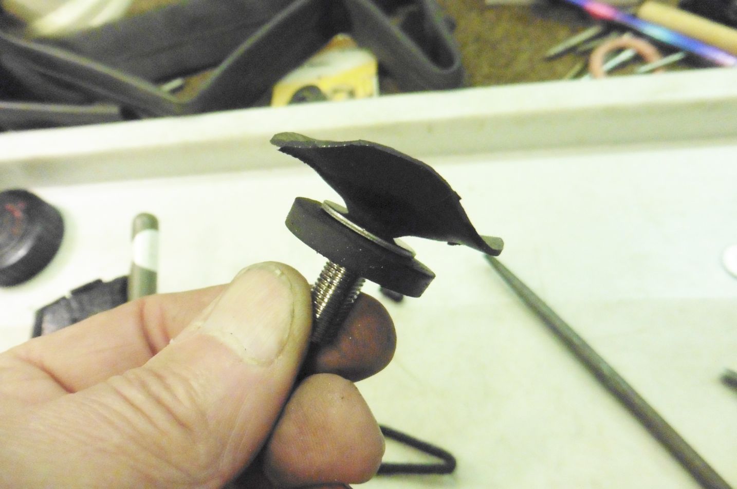

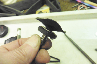

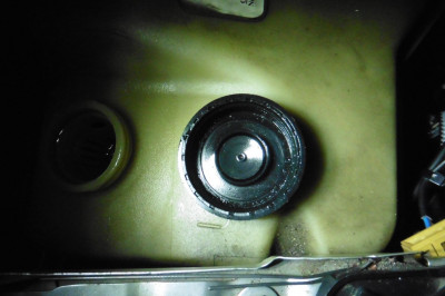

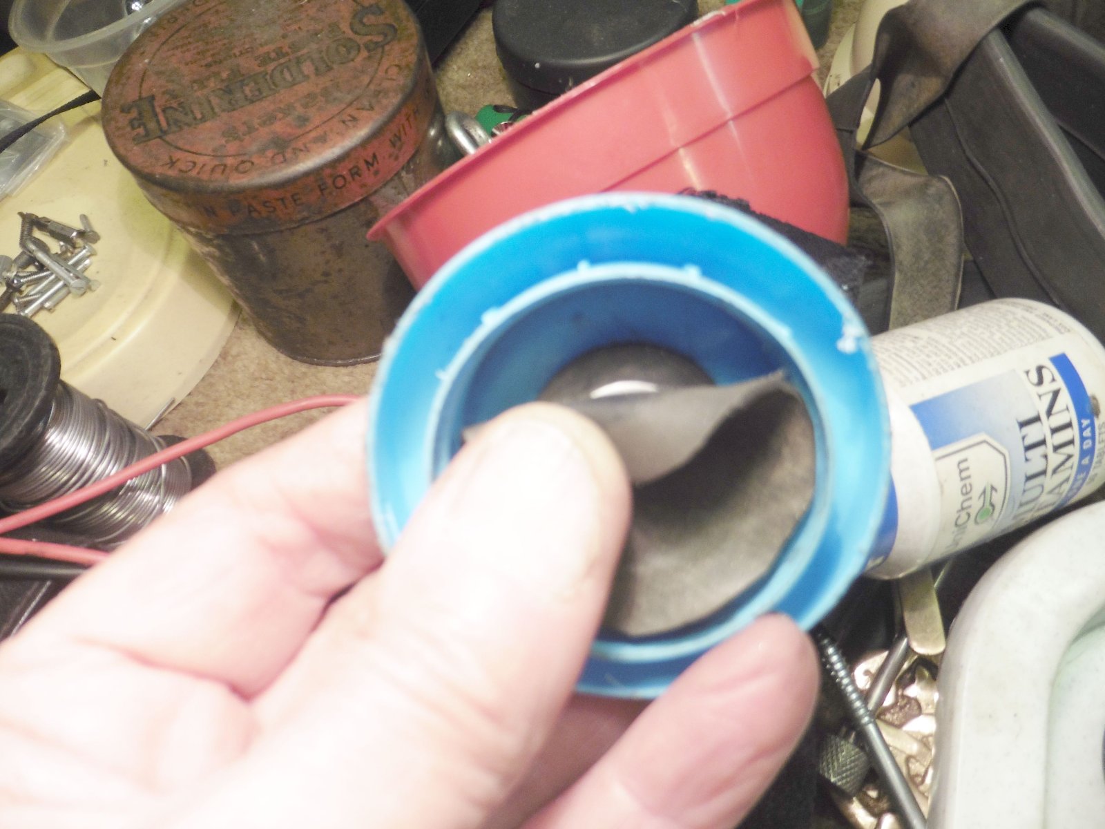

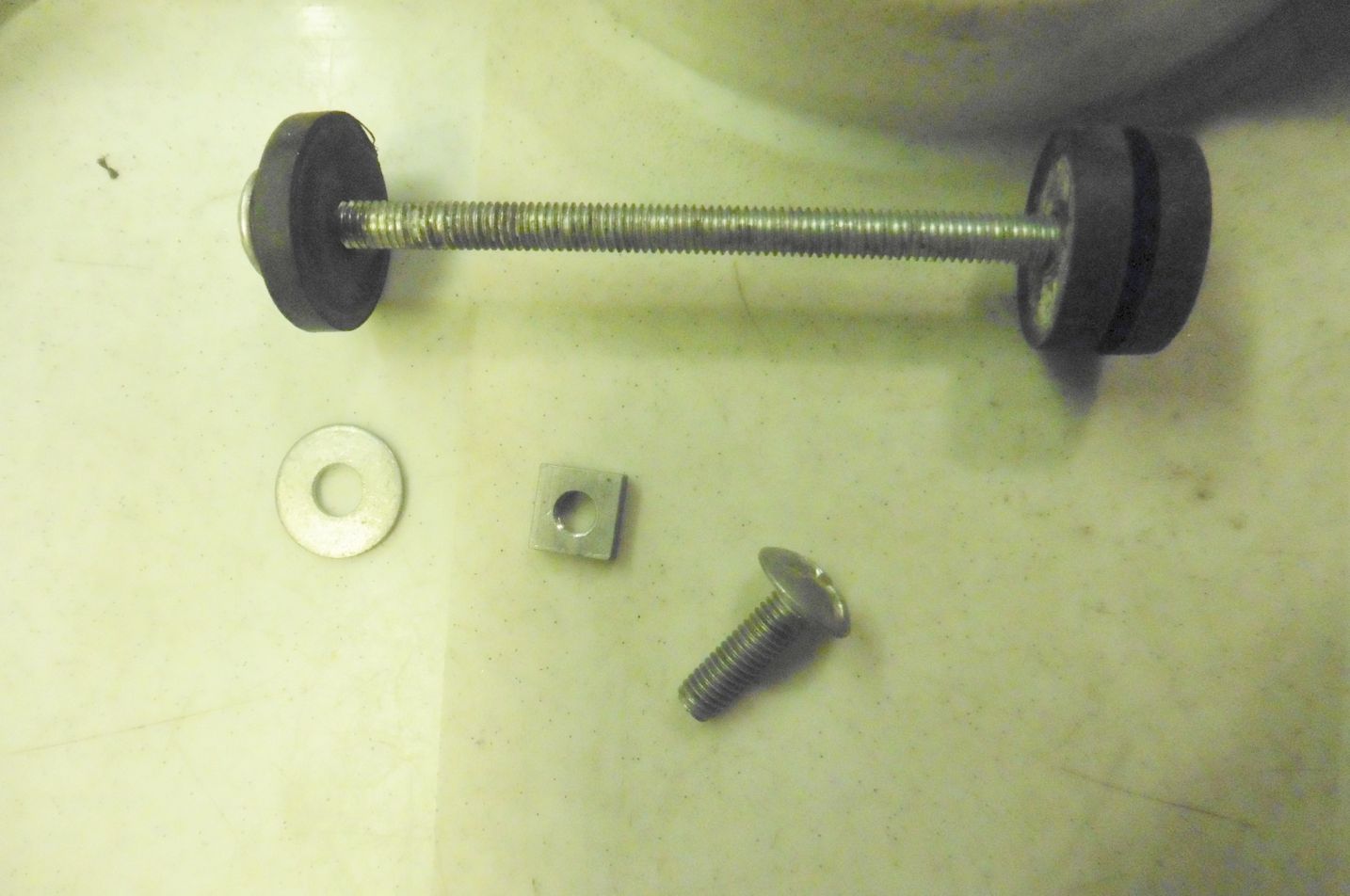

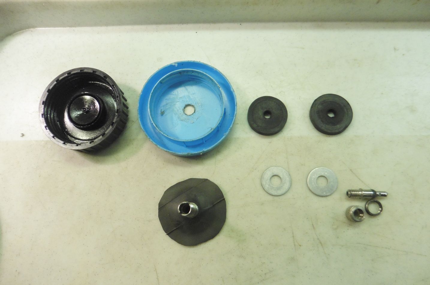

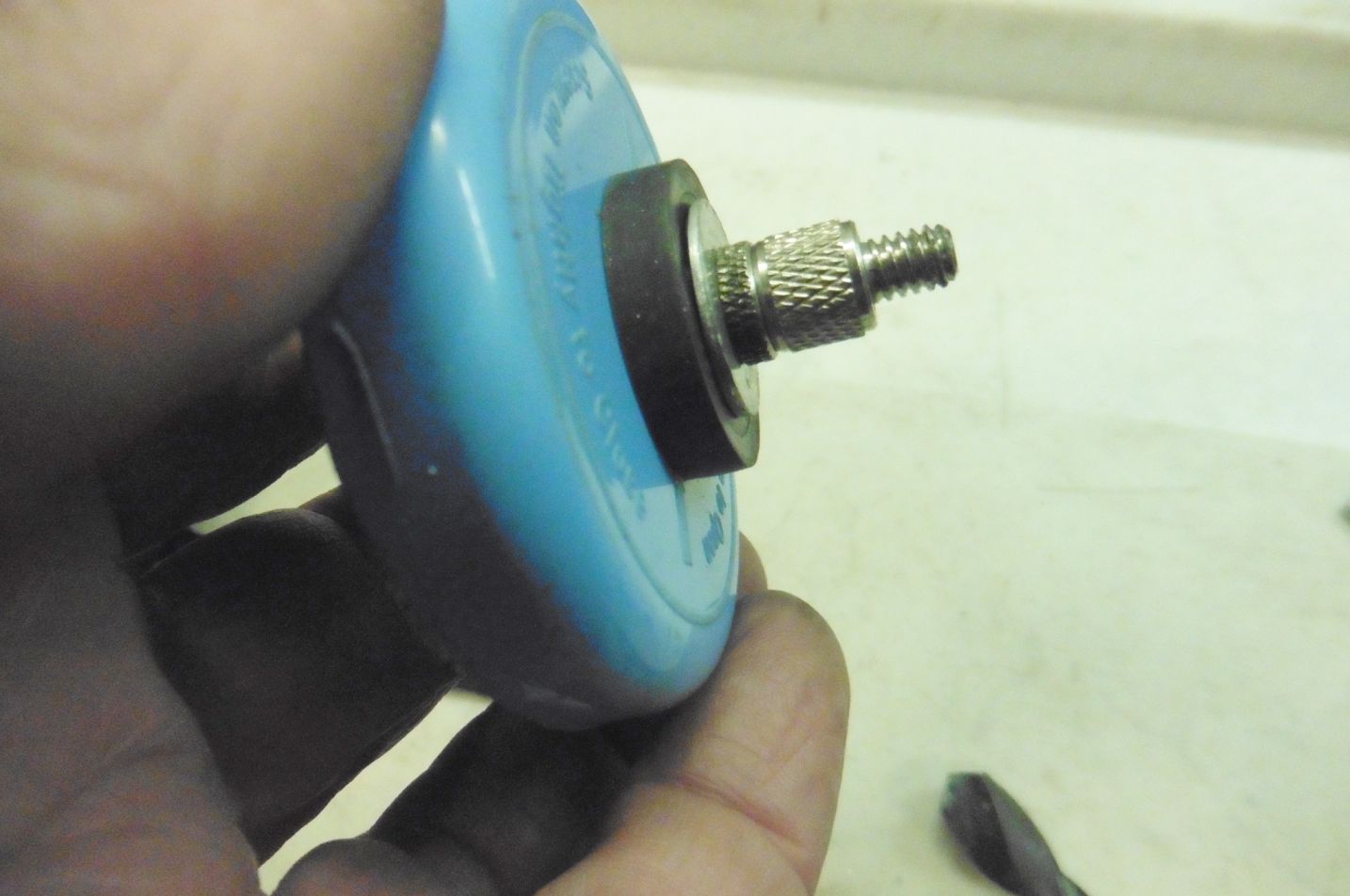

Today I made up a cap to pressurise the suspension hydraulic system.
The ready made device is over £200 if I remember correctly.
I tried a lot of lids from various containers around the house, workshop and garage.
The best I could find was the top from Tesco Omega 3 Fish Oil.
It is very tight and not ideal at all, but the best we had.
I cut the flange down a bit so as to better see what was going on.

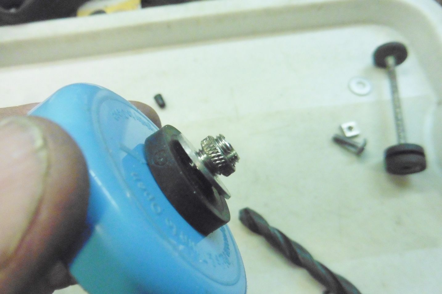

Some bicycle inner tube valves do not have a long thread, the type I used do.
They are the smaller of the two in diameter, that is as far as the part that the pump clips on not the main stem.
Please see image.
The rubber washers are from the bolts that fit low level tanks to toilets.
Perhaps tap washers would do as well ?
The holes are a lot smaller, I opened them out a bit with a soldering iron and round file, but still left them small so as to be a tight fit on the valve thread.
The washers were from the type of bolts used to hold Dexcion racking together.
The ones I used were Aluminium, they were easy to file the hole out to fit the diameter of the valve.

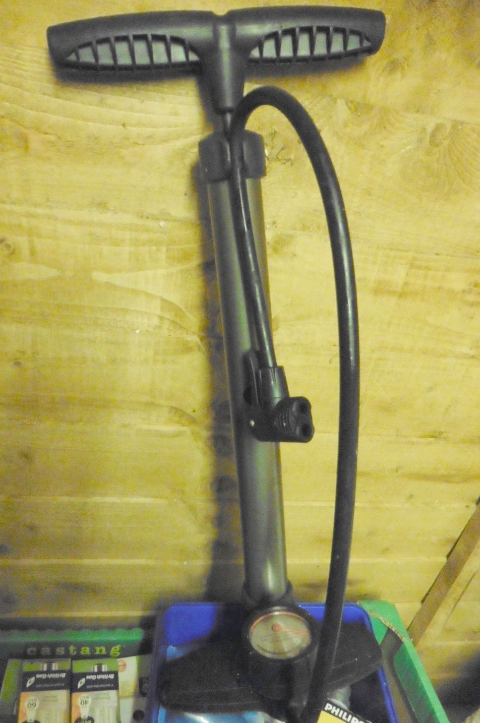

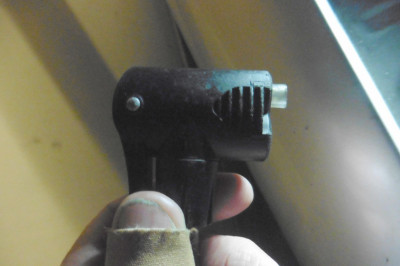

Alanna's bike pump has a gauge on it so is ideal, it will also fit both size of valve.
It is very very tight and difficult to screw on, you would do beter to find a better cap somewhere.
I tested it by mouth blowing into it to see how much it leaked, it should be good enough if we keep pumping.
The original cap has a pressure release valve in it so using that is out, as cutting a hole for the new valve would destroy it.
Tesco Omega 3 Fish Oil can then be consumed afterwards, then like me you will be able to run three miles a day at 72 : )
God Bless Spiff

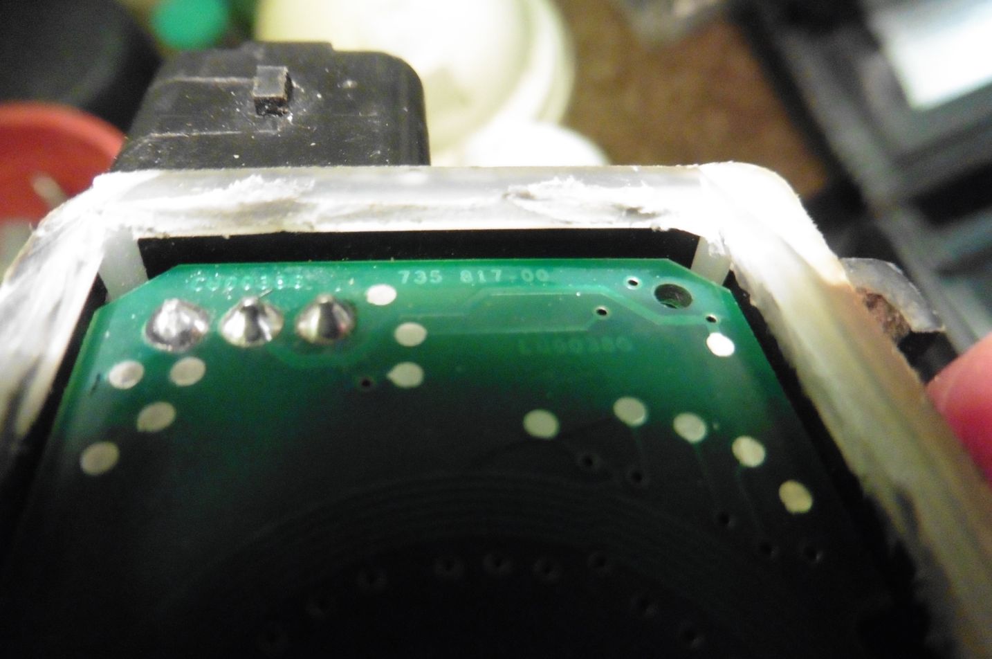

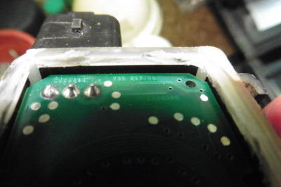

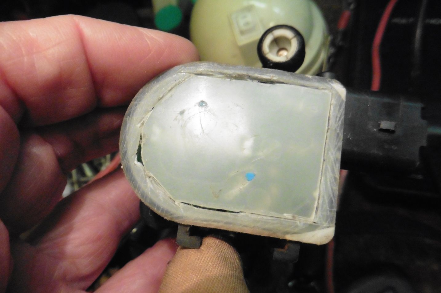

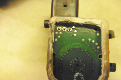

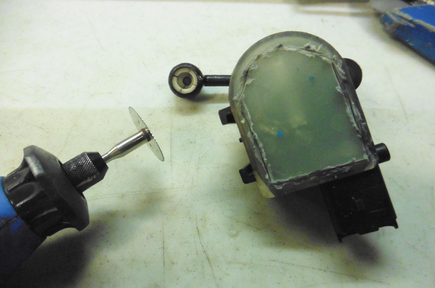

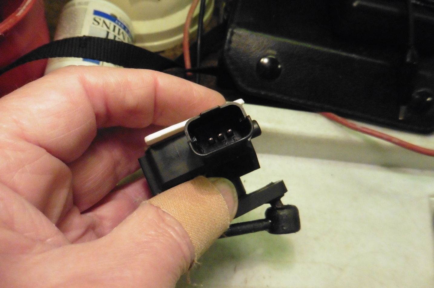

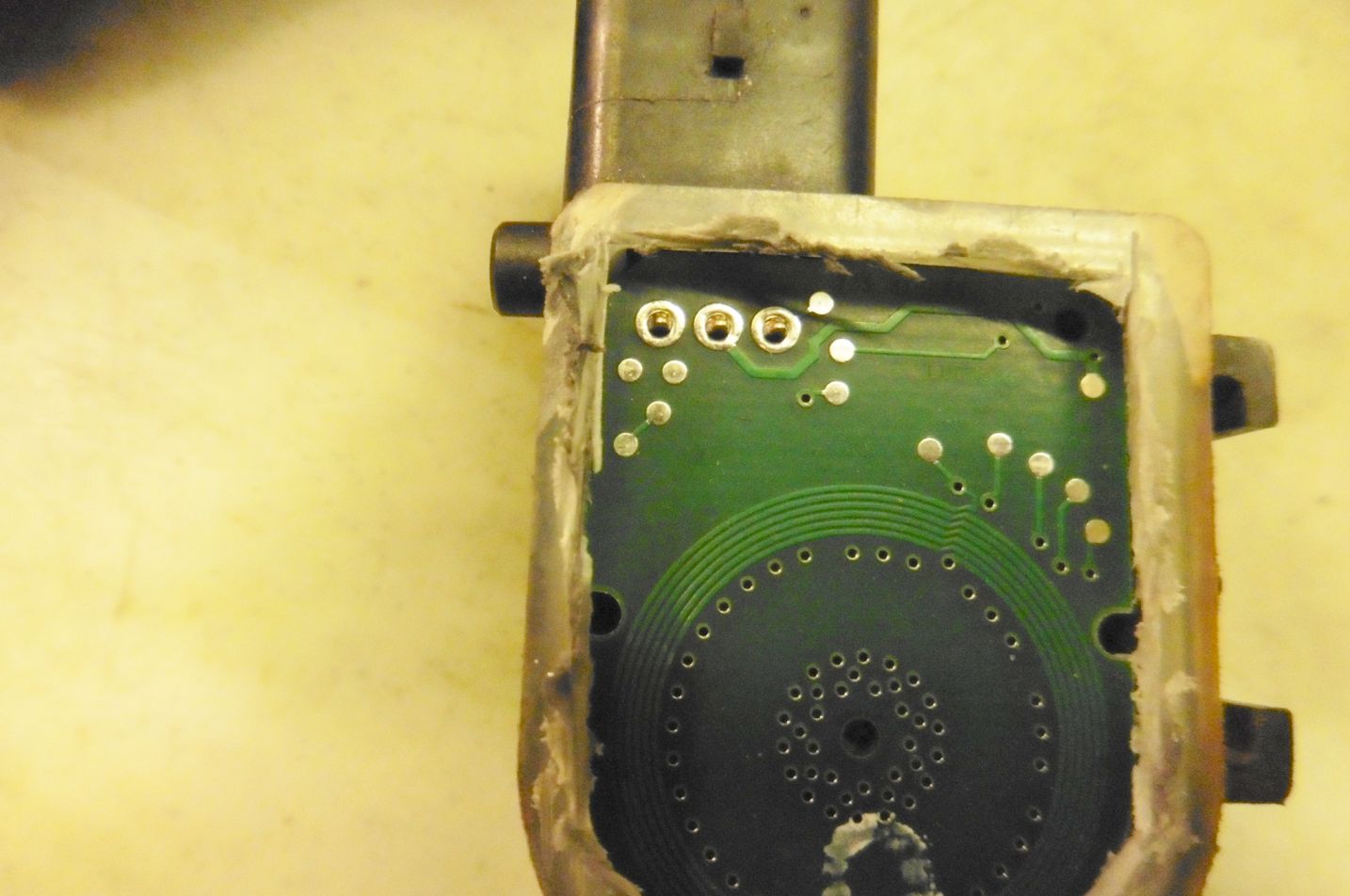

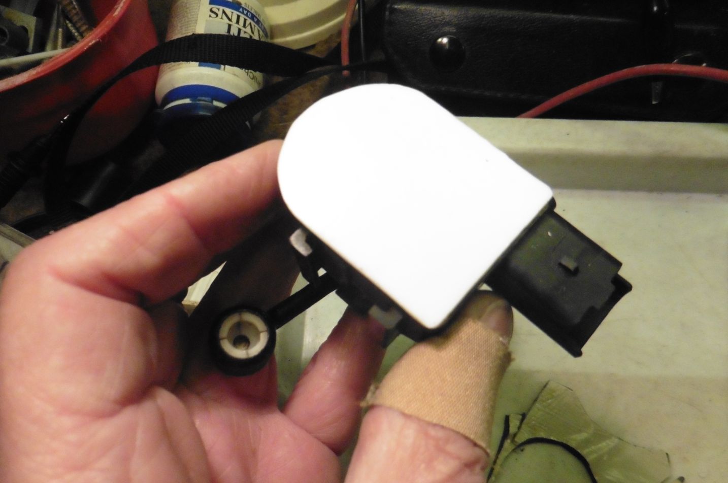

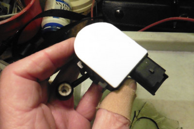

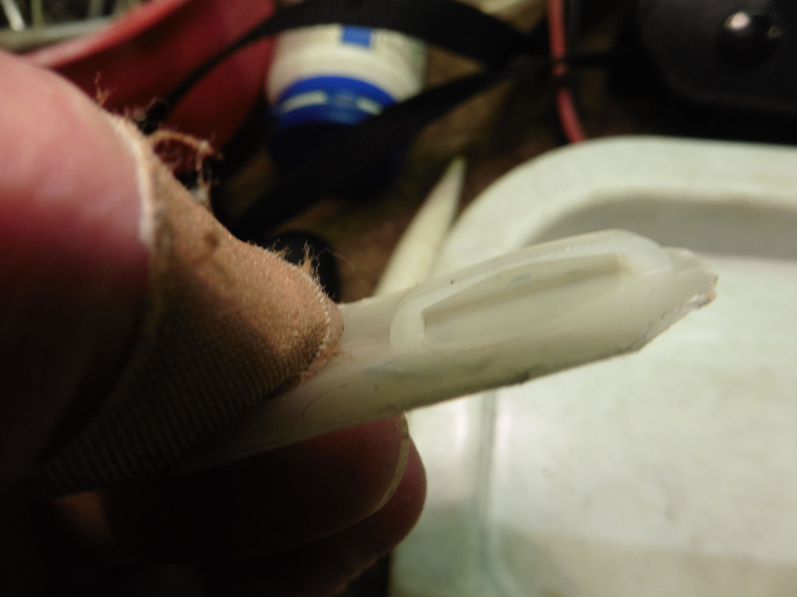

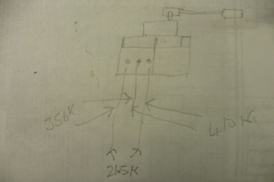

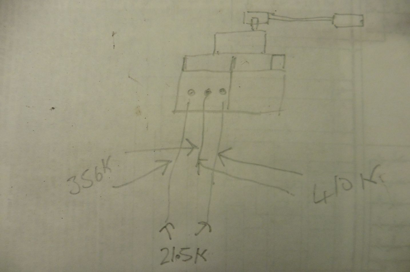

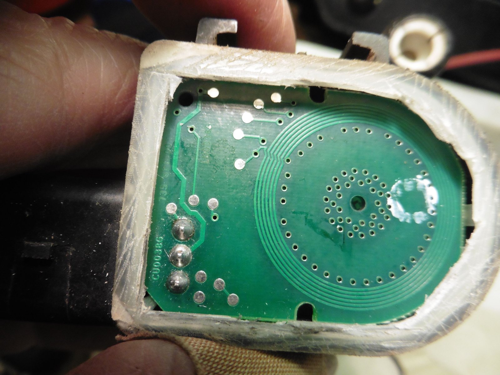

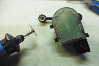

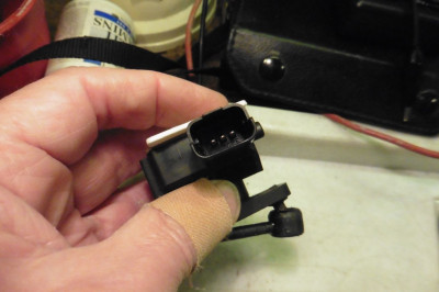

The car is now back on its wheels, but unfortunately the intermittent fault with the pump not running means the rear stays down.
Sometimes if left over night the pump will run when the doors are unlocked, but no such luck at the moment.
I have a second hand height sensor, the seller could not guarantee that it was a working one only that it came from a working car.
So before I try the sensors again I took it apart to solder the three connections inside which apparently can become intermittent.
This is not my original idea, it was first suggested by ( landyman ) but unfortunately the images with the original post are missing.
The attached pictures should explain the process.
Tomorrow I shall try plugging it in to the front and rear.
It is not as far as I can tell a variable resistor, as the resistance did not change when moving the spindle, nor is it a variable capacitor as I tested it on a capacitance bridge.
The fixed resistance readings varied depending which was round the meter was connected on the pins, which could sugest that there are transistors inside ?
The printed coil is an inductor, may be it has some kind of oscillator inside ?
I should be interested if any one knows : )
When re-assenbling the sensor, fit the original cover as it has a raised section to hold the printed board down, then glue a new cover on the top.
The new cover was cut from a plastic box : )

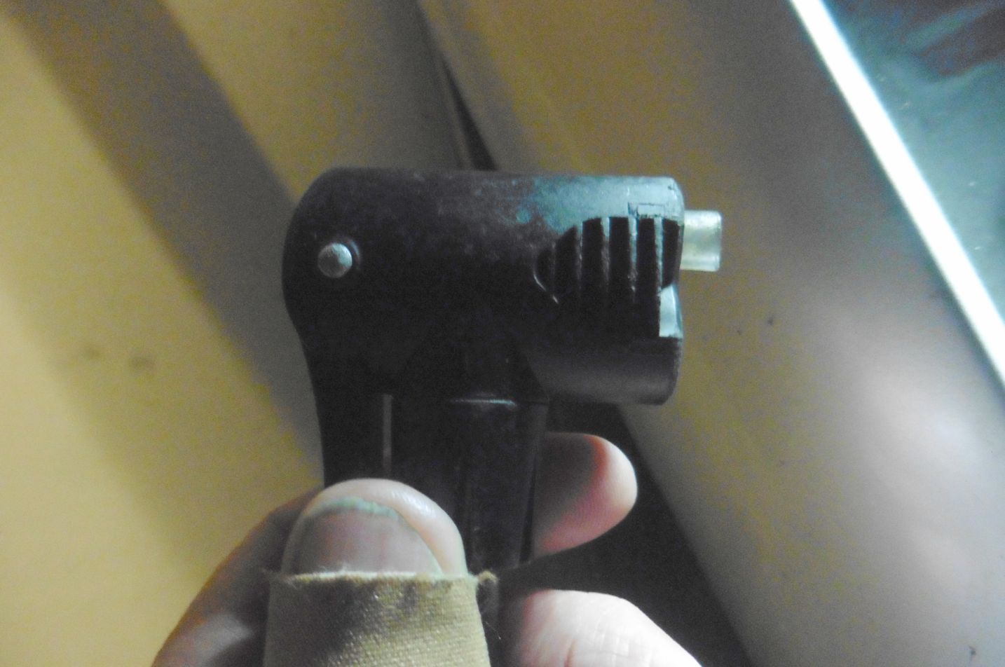

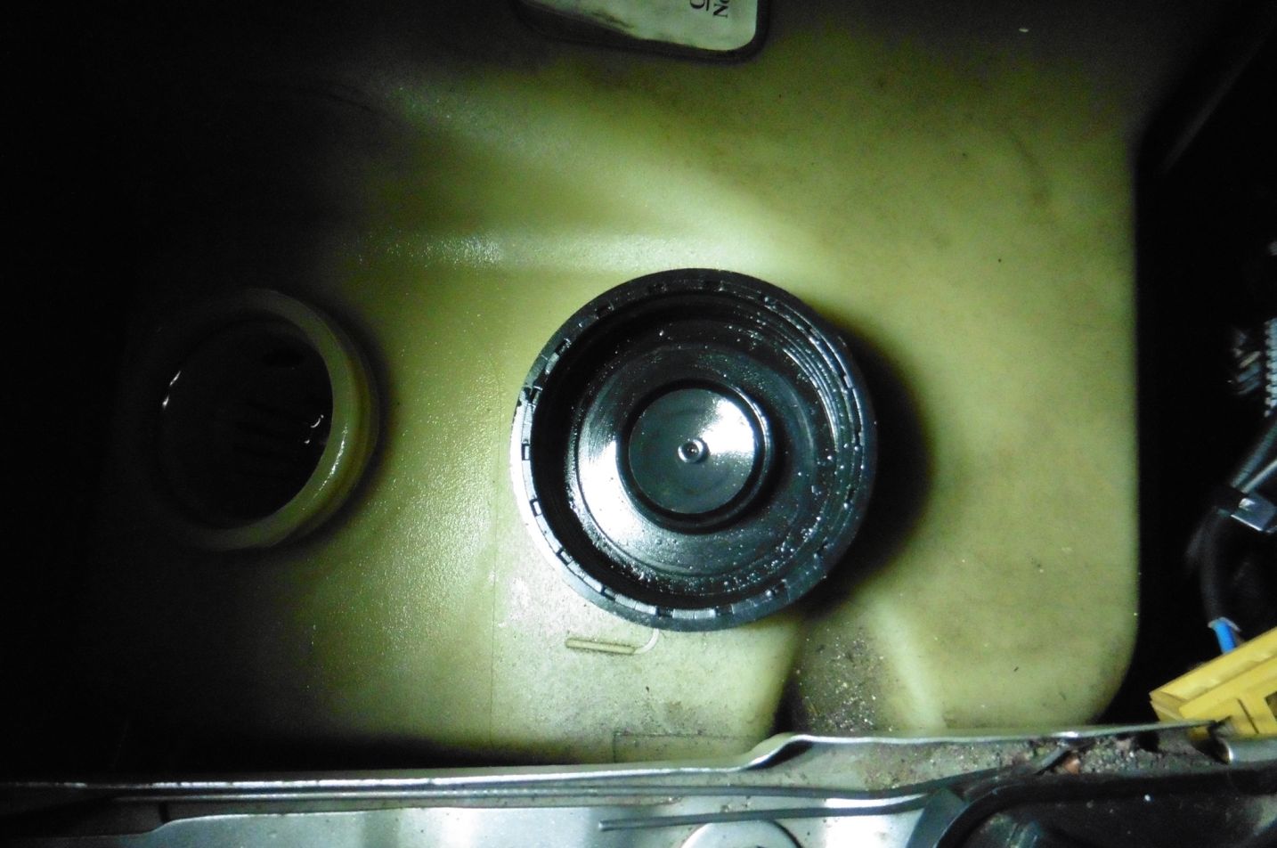

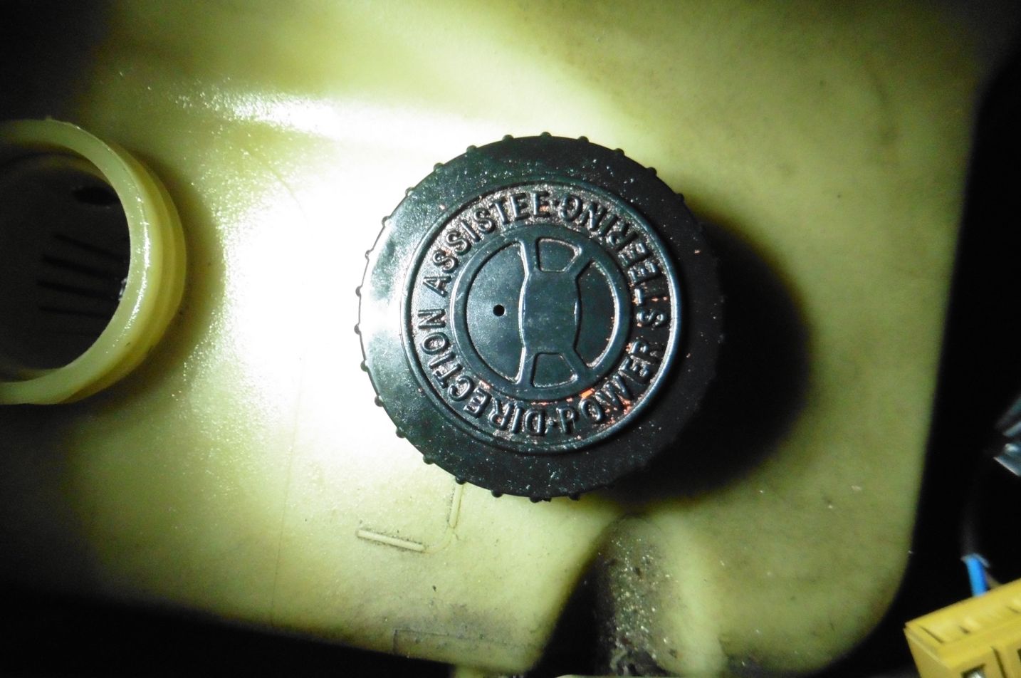

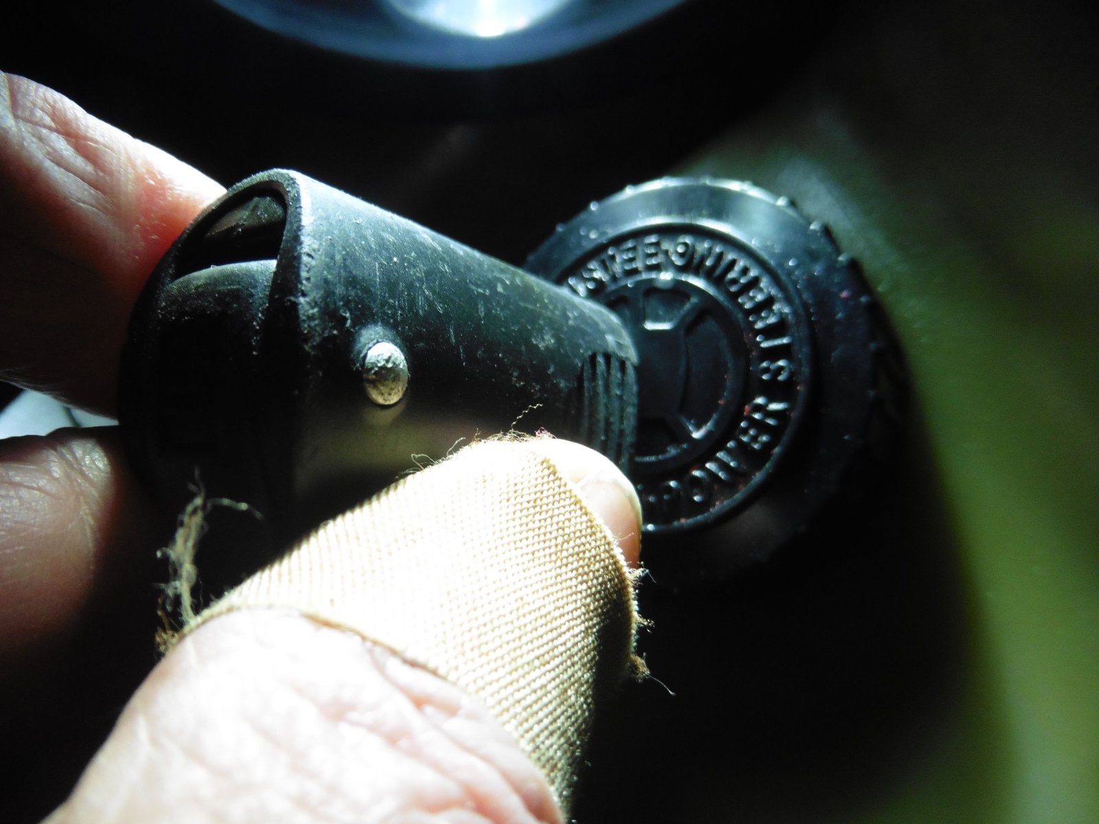

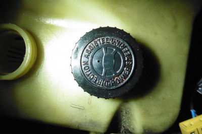

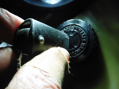

The fluid reservoir already has a valve in the cap, it can be pressurised by fitting a piece of tube to the pump connector and pumping against the hole in the cap, please see images.
There is then a large hiss when the cap is removed, it is not possible using this method to tell what the pressure is though.
It may be possible to fit a bicycle valve to replace or as well as the original valve in the cap, as it should not affect the working if left in situ?
God Bless Spiff
God Bless Spiff

Impressive work - don't think anyone has previously tried to disassemble one of these height sensors.
I would strongly suggest the best way forward is to plug the car into Lexia and see what that tells you - even if no fault codes stored, you should be able or see whether or not the rear height sensor is correctly registering that the rear of the car is low or not.
