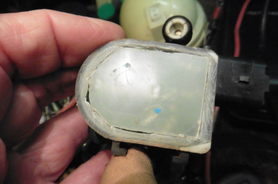

The car is now back on its wheels, but unfortunately the intermittent fault with the pump not running means the rear stays down.
Sometimes if left over night the pump will run when the doors are unlocked, but no such luck at the moment.
I have a second hand height sensor, the seller could not guarantee that it was a working one only that it came from a working car.
So before I try the sensors again I took it apart to solder the three connections inside which apparently can become intermittent.
This is not my original idea, it was first suggested by ( landyman ) but unfortunately the images with the original post are missing.
The attached pictures should explain the process.
Tomorrow I shall try plugging it in to the front and rear.
It is not as far as I can tell a variable resistor, as the resistance did not change when moving the spindle, nor is it a variable capacitor as I tested it on a capacitance bridge.
The fixed resistance readings varied depending which was round the meter was connected on the pins, which could sugest that there are transistors inside ?
The printed coil is an inductor, may be it has some kind of oscillator inside ?
I should be interested if any one knows : )
When re-assenbling the sensor, fit the original cover as it has a raised section to hold the printed board down, then glue a new cover on the top.
The new cover was cut from a plastic box : )
The fluid reservoir already has a valve in the cap, it can be pressurised by fitting a piece of tube to the pump connector and pumping against the hole in the cap, please see images.
There is then a large hiss when the cap is removed, it is not possible using this method to tell what the pressure is though.
It may be possible to fit a bicycle valve to replace or as well as the original valve in the cap, as it should not affect the working if left in situ?
God Bless Spiff

Impressive work - don't think anyone has previously tried to disassemble one of these height sensors.
I would strongly suggest the best way forward is to plug the car into Lexia and see what that tells you - even if no fault codes stored, you should be able or see whether or not the rear height sensor is correctly registering that the rear of the car is low or not.
