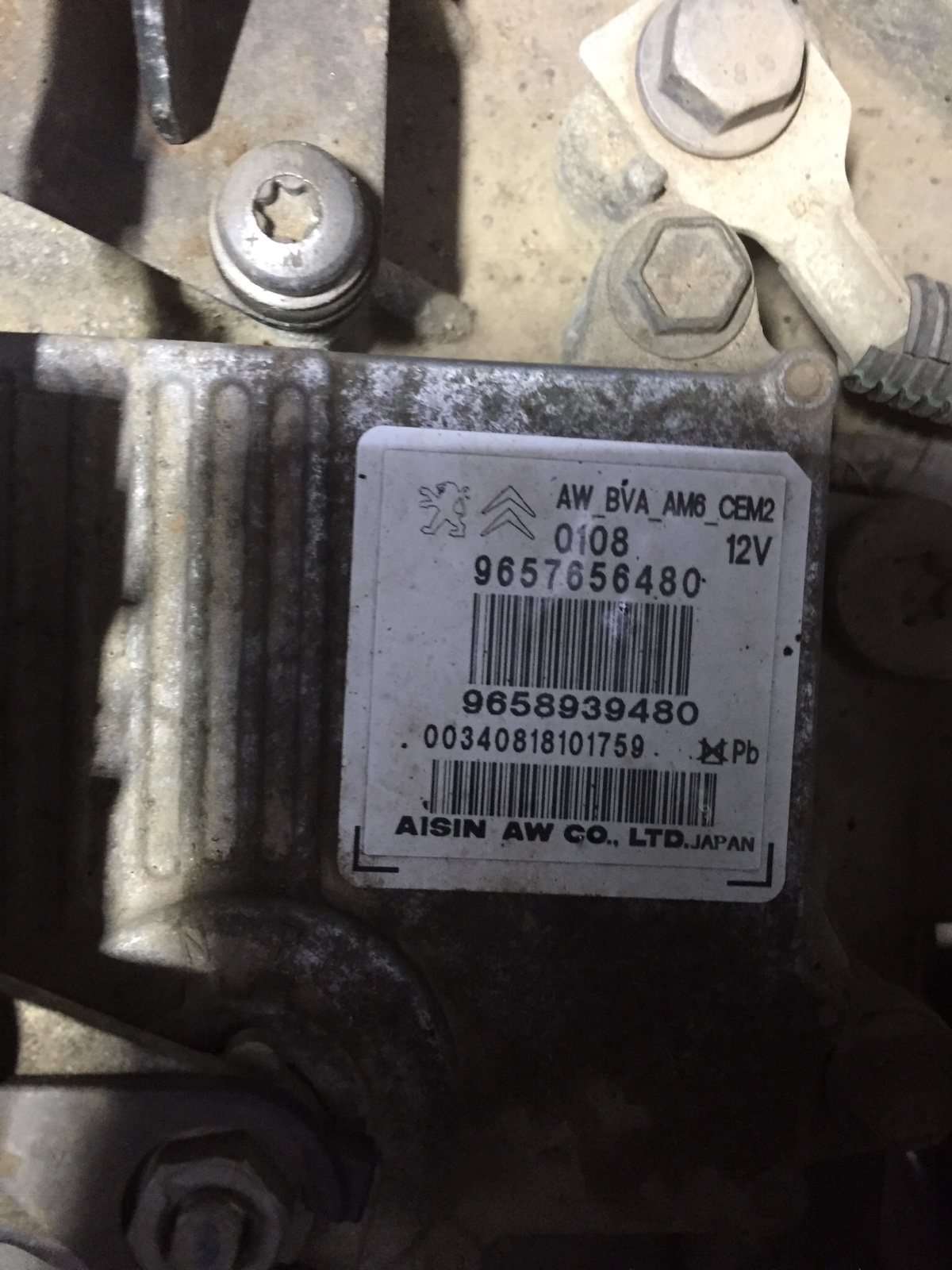

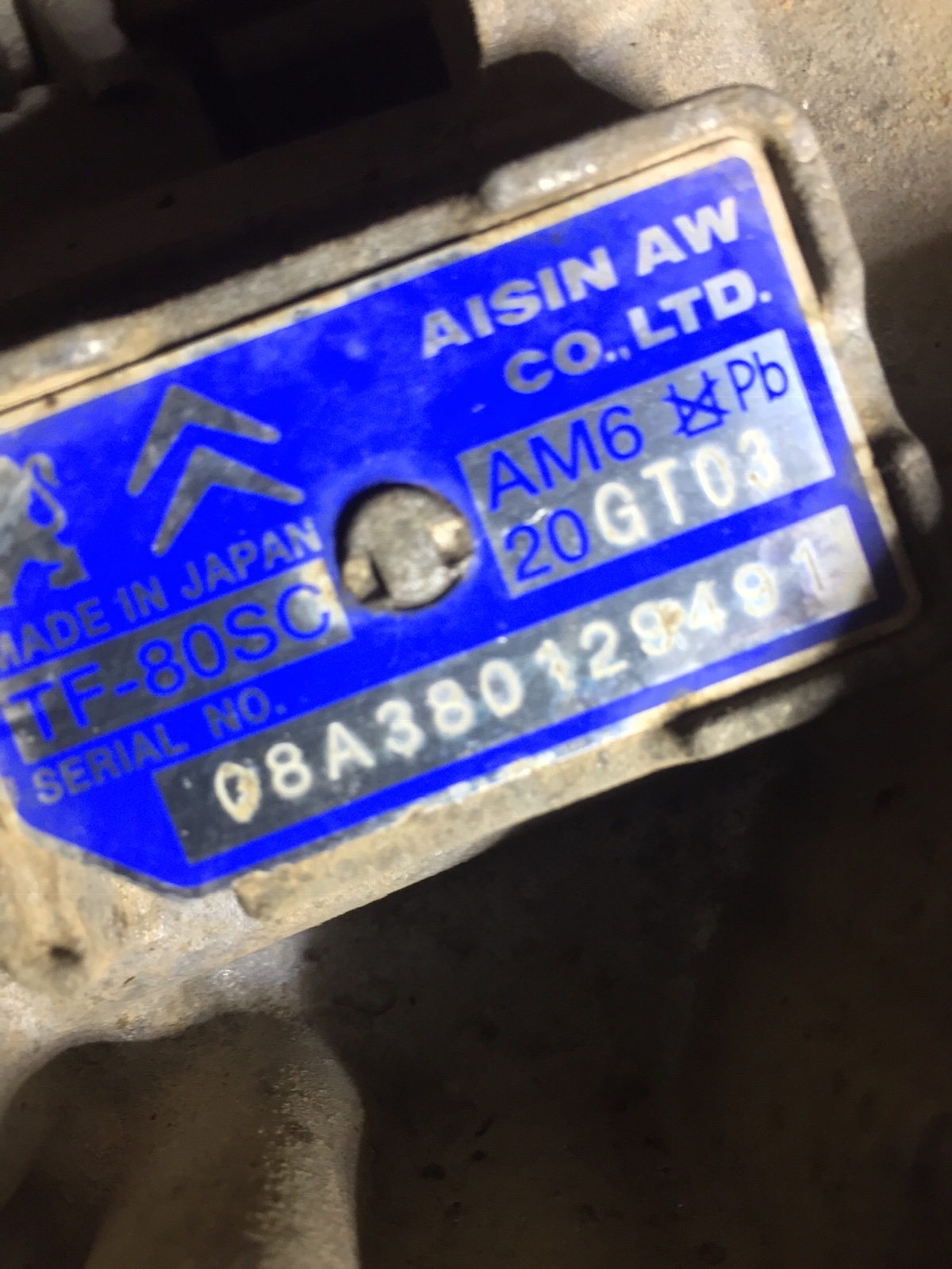

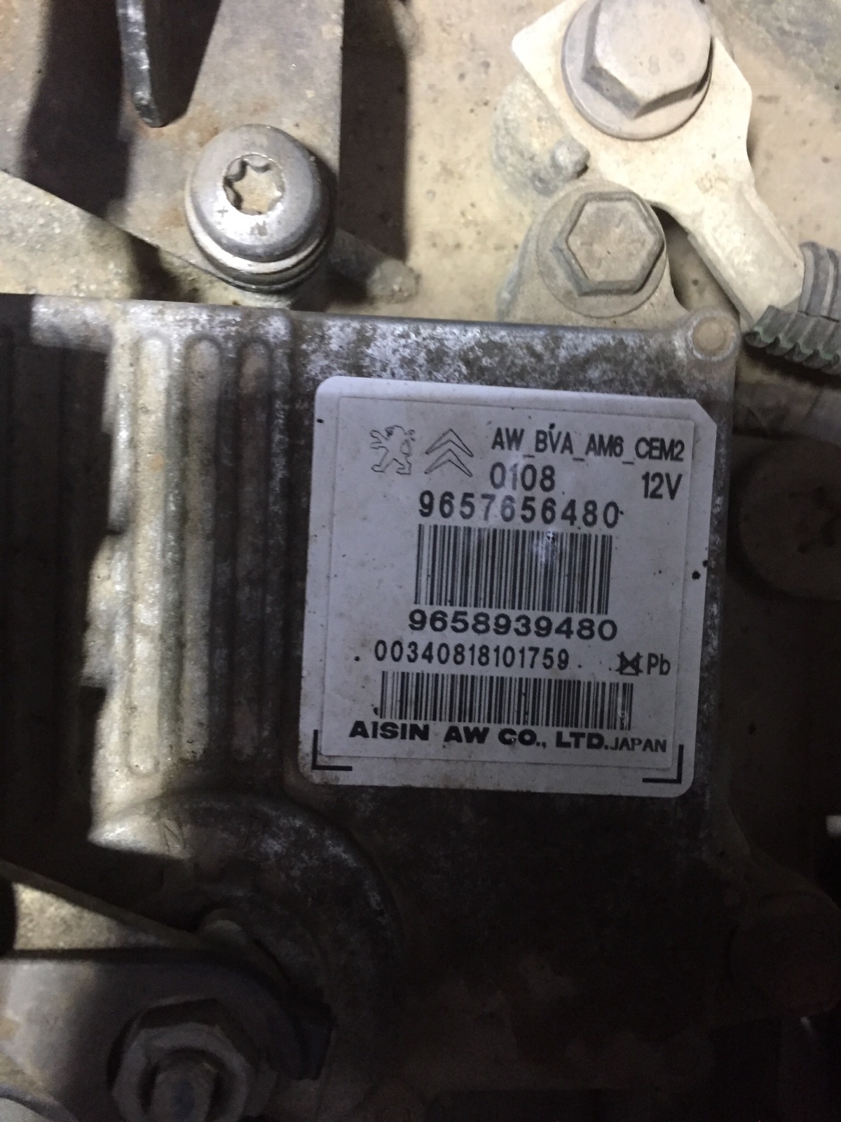

Hello helpful members,
I'm about to change the oil of the automatic transmission on a C5 3.0 V6 240 HDi, with transmission AISIN BVA AM6C.
I read tons and tons of stuff about the procedure all over the web, I feel confident enough but this post: viewtopic.php?p=543115#p543115 got me confused!!
Where did @EDC5 encounter the filling problem (by which he filled 2 litres and the last one couldn't be filled)?
When I fill the new oil does the engine need to be on or off?
can someone please explain the filling step and how to make sure the level is correct (the last 500ml + 500ml fillings)?
