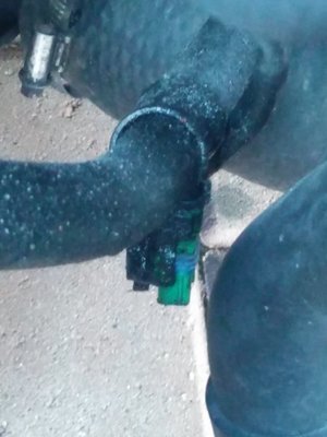

Sorry about the quality, I was mooching under the bonnet and noticed this connector hanging. Could this be related to my non working oil level sensor? And if so where does it fit?

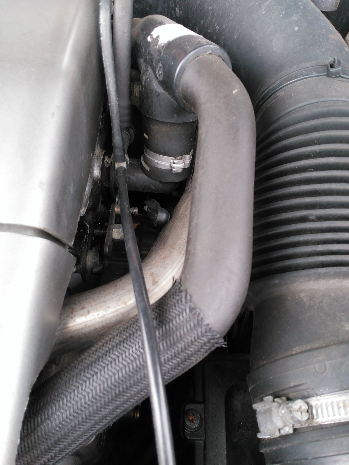

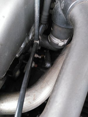

I replaced the air filter today, it needed doing but whilst doing the job I noticed this cable and lever disconnected. I'm not sure if its anything to do with cold starts or maybe kickdown? But the engine runs fine. The pic is the best I could do in the grey light. It's on the ns of the head I think, poking out from under the plastic engine cover.

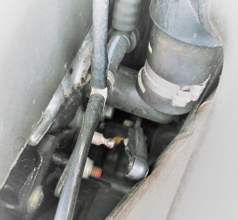

Edited it a bit to make it clearer, can't help with what it is at the mo though.

Still having a job working this one out - I've got your car diagrams up - maybe adding another shot from a distance so we can see some of the surrounding parts to help identify it.

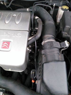

Thanks Gibbo and Marc. Here's another a bit further out. Air filter hose to the right, engine cover left.

I confess I can't remember seeing anything like that sticking out! Can we see where they go to whenever you get the chance - I still can't decide if this is EGR. return fuel pipes or turbo related - or none of those!

That's the sort of cable that connects the gear lever to the box but as you say the car's running ok it can't be that.
Your car is a 2.2 isn't it? If so it's different to both my cars, I have a 2.0 Litre HDI manual and the one I'm putting back together is a 2.0 Litre automatic with the Japanese AM6 gearbox.
It's obviously there for a purpose so I would just reconnect it and see what happens, it should pop on, maybe need a squeeze with pliers or pip wrench.
