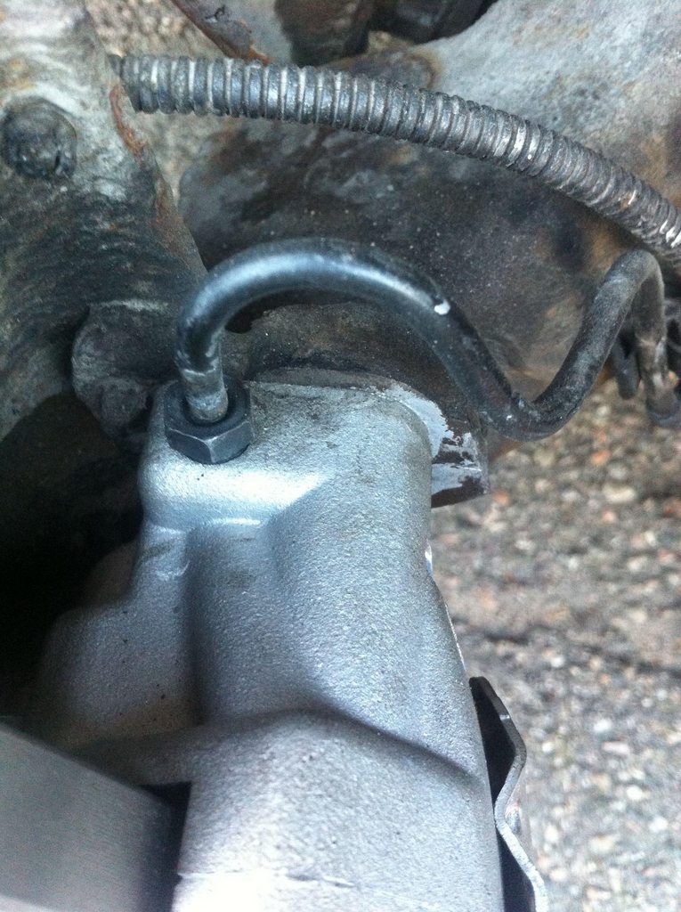

Looks like he repaired the brake pipe rather than a new one and the result doesn't look bad at all:

That looks like some pretty hefty angle grinder induced percy-whasit :rofl2:
Pipe a neat job, I presume he has cut the end off and re-flared it in situ. Good lord, a Mechanic who actually knows how to fix things rather than just change electronic components..... :lol:

Can't really tell what he''s done there. The fitting looks like a new one to me. If that were mine I'd get that exposed pipe painted Ben, last thing you need after all that is a leak. I'd use high temp paint, same sort as for callipers, sumps and rocker covers.

elma wrote:Can't really tell what he''s done there. The fitting looks like a new one to me. If that were mine I'd get that exposed pipe painted Ben, last thing you need after all that is a leak. I'd use high temp paint, same sort as for callipers, sumps and rocker covers.
Yeah I think the caliper came with everything except for the pipe, pads and discs :)
Thanks for the paint suggestion, I'm out at the mo nearby a shop that sells some car stuff so after we're done with the other shopping will see if they have something for it.
If not I'll have a look online once I'm back home.

You can get paint that is suitable for exhausts, rated for something like 800C, if that helps.
