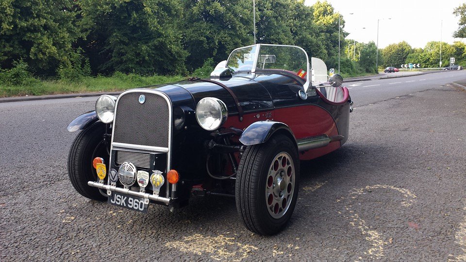

It lives again! After I'd put all the bodywork back on it, cleaned all my tools and crap out of it - it is handy having an open top car you can just whizz tools in for the evening, I thought I'd better stretch it's legs for the first time in a couple of weeks. 35 miles or so, about an hour ran it up to 80ish on the motorway, pottered about town, had a nice evening run. No real problems. Still runs a little hotter than I'd like. Perhaps need a new thermostat, but I need a BoL for it really, I don't know where the thermostat is! I think it also needs a new dizzy cap and rotor arm judging by the state of them.
It has however stopped pinking and it is cooler under the bonnet than it was due to the exhaust not leaking at the manifold to downpipe join.

That's a lovely picture of it Mike :-D
There you are Mike, An R4 BoL on ebay for you :-D

Did anyone else notice that it's parked, tongue-in-cheek, on a "STOP" sign?
