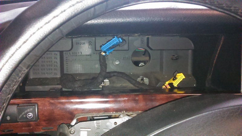

Done a little bit of fidling yesterday as I changed my instrument panel. The old speedo meter jumped to 40km/h on ignition and then it just showed 40km/h over speed. Also the kilometers were not showing on display. Since I was working I decided to change the clock as it was resetting constantly and also the illumination didn't work.
Now I have a properly working speedo meter, kilometers meter and also time meter
Xantia fans here is a question for you! Anyone notice the difference between my old panel and the new one? Hint old one year 1998, new one year 2000

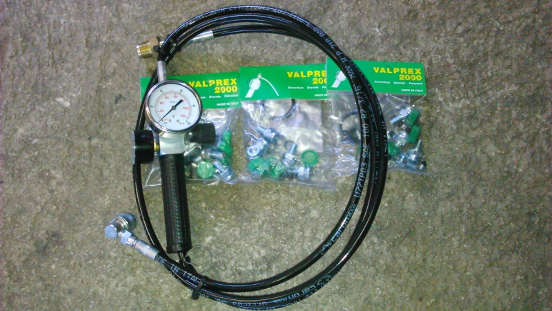

And here it is! Tecnosir valves and filling "gun"!
Next week I plan to slaughter the other Xantia and also refill my spheres. My Activa needs some more attention as it dripping LHM in the front and at the back. In the front it's probably steering rack collar so jolly nice job repairing it... But I do have a plan!
Don't know about the back. I did also buy a set of 6-angle wrenches, special for undoing pipes, so that should help undoing the pipes, without rounding the nut.
