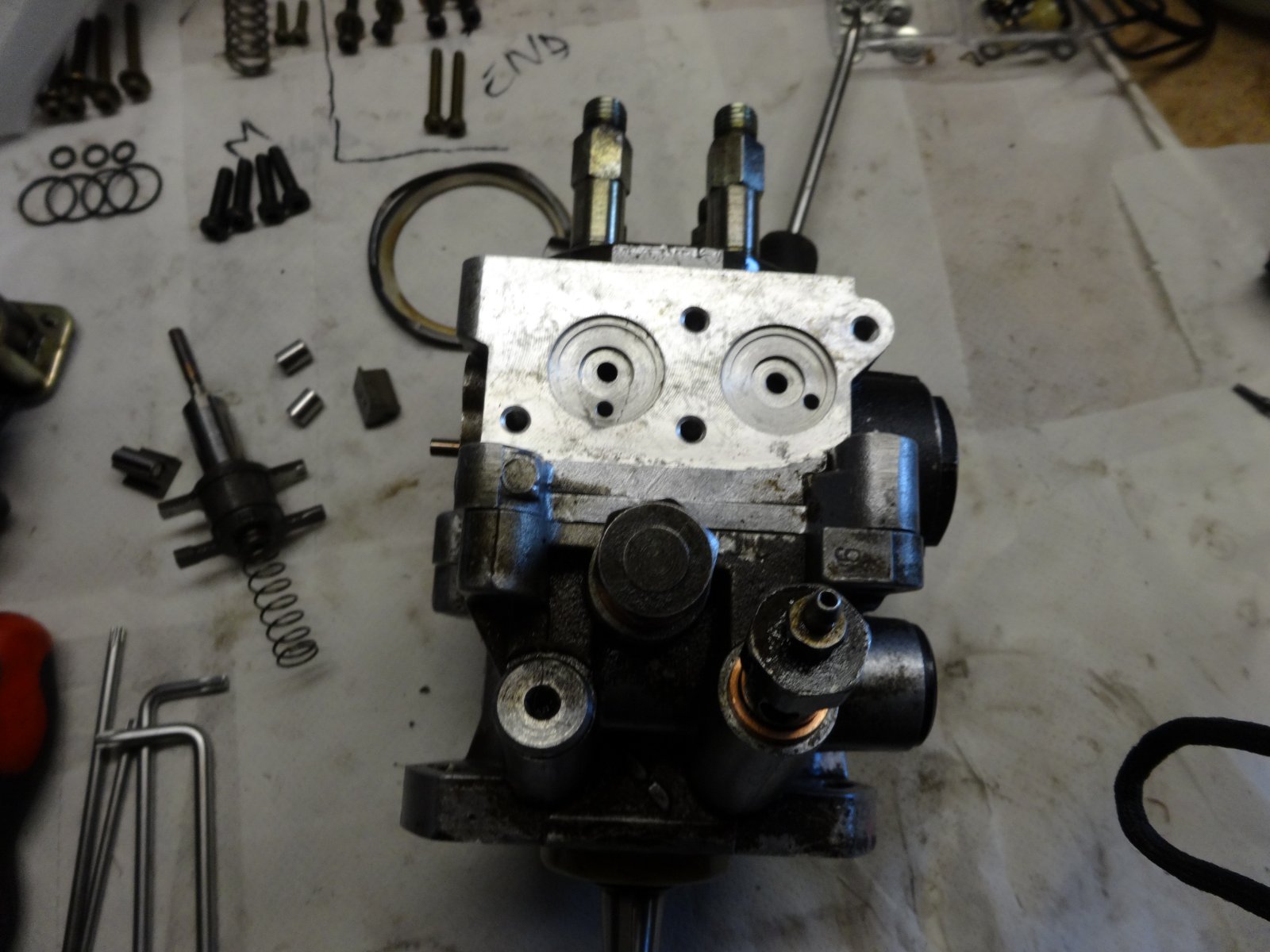

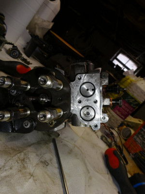

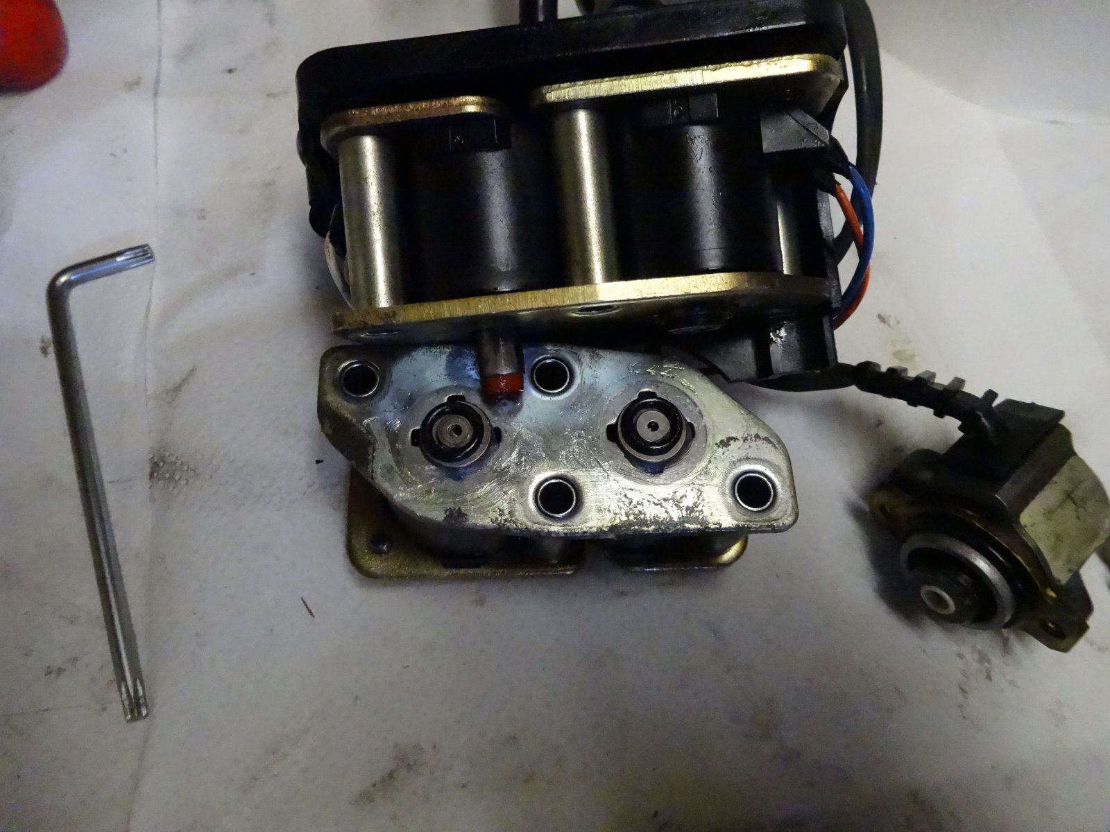

Here's a pic I found from when I stripped mine. I thought I may have had a pic of the valve assy split but I haven't.

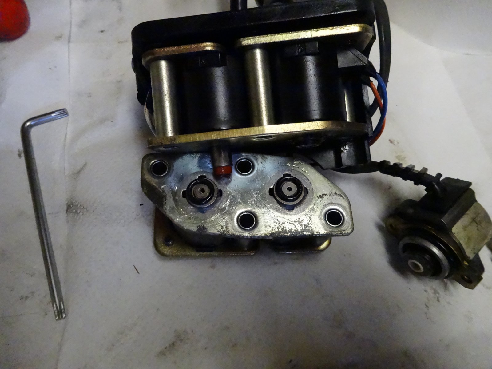

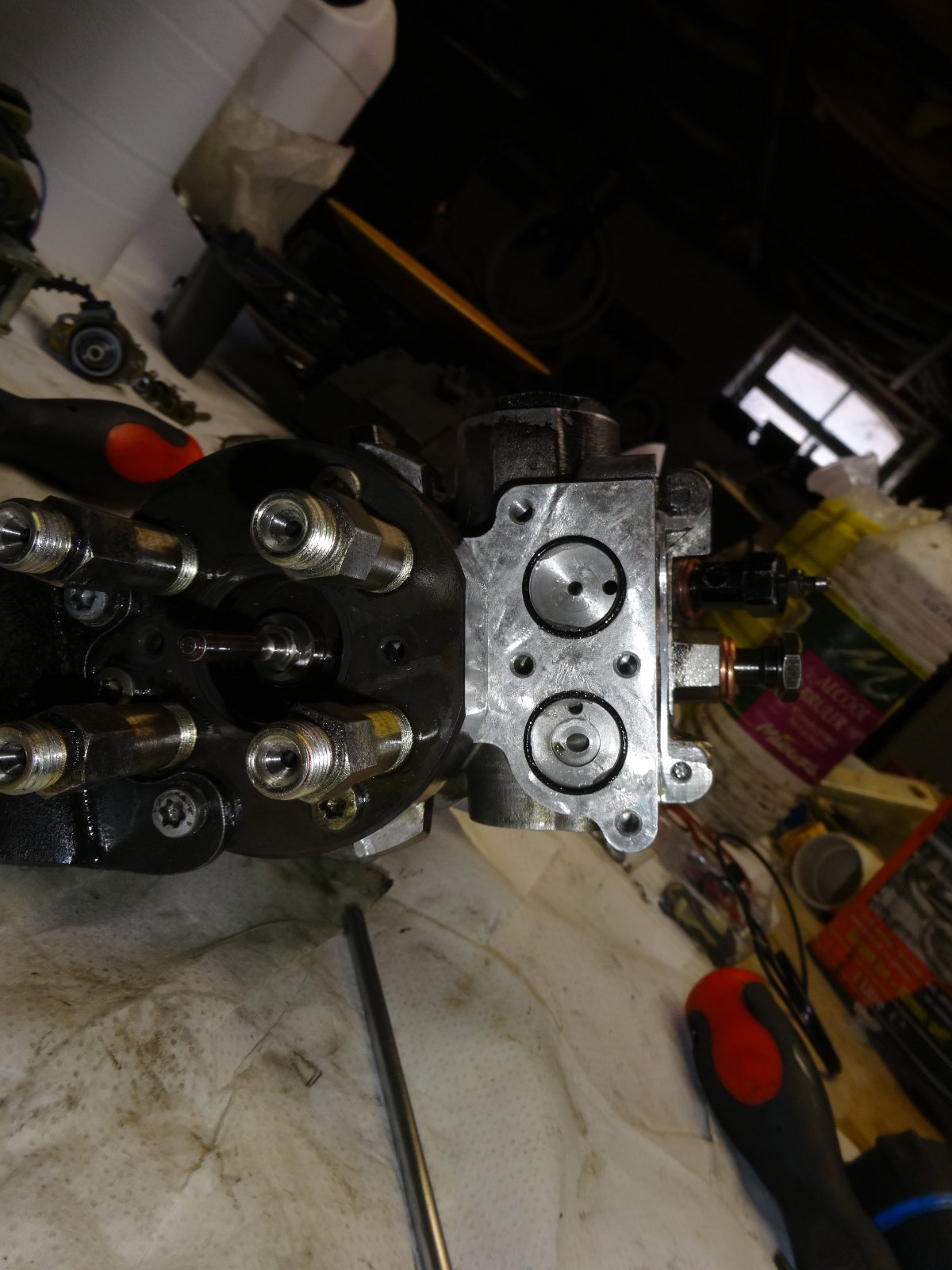

And here's the rear part with the stop solenoid
And here's a valve
Similarly, how it works??????

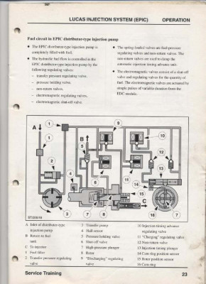

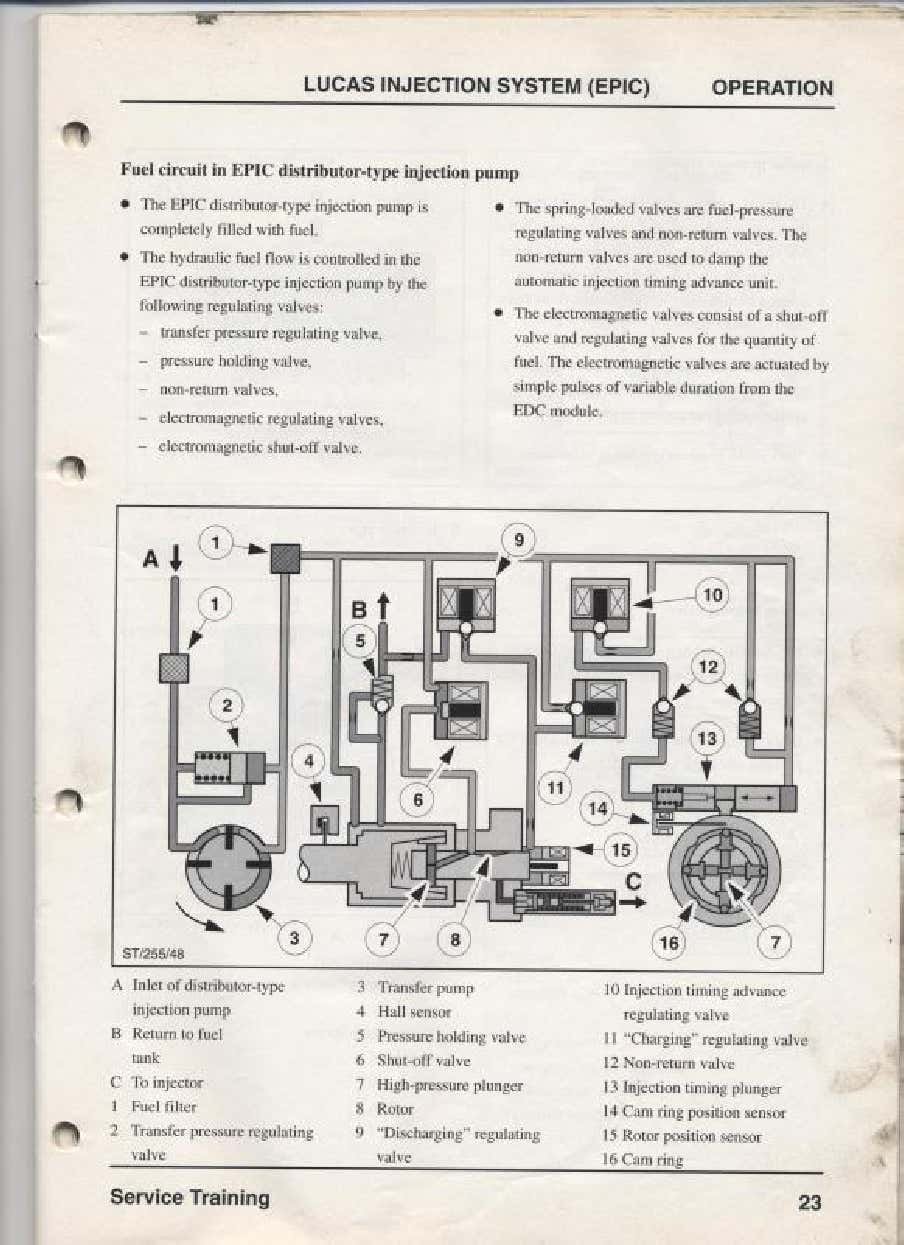

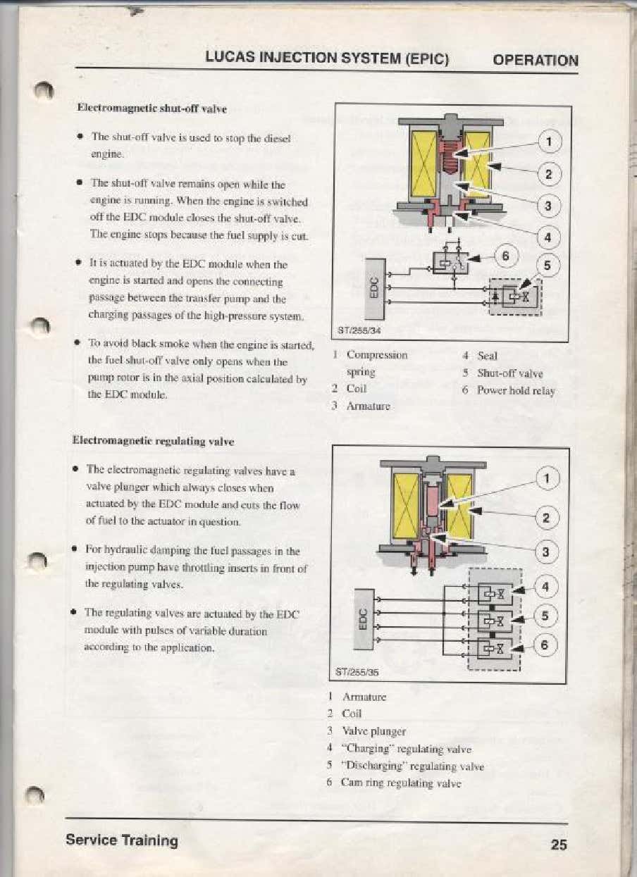

As to operation of the pump, see picture below (it's a scan from the transit manual I linked earlier)
There are 3 sections, from the left: transfer pump, high section, cam regulation section

@moizeu how many orings are to be replaced per one valve? Is it one (wider) on the pump side (pin no 1 and 2 you uploaded) and one on the solenoid/valve side (pic 3)
I think I am onto sth just need little help

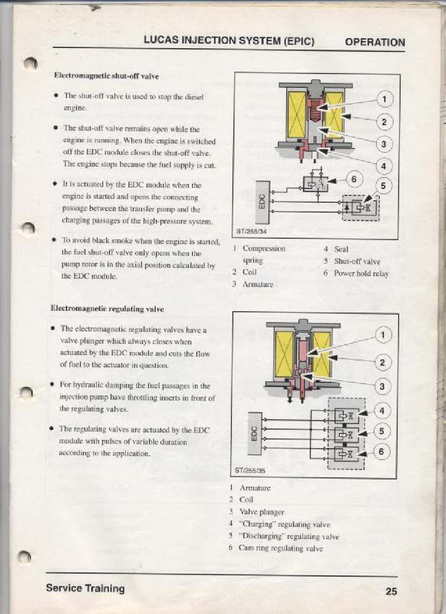

Ok, I think mystery is solved
Your material did not provide any useful explanation for me but what I established so far is enough to present a theory
There are actually two wholes in each valve
Please study the picture I enclose (bottom illustration on the picture) Pay close attention to little "in" and "out" arrows (up and down arrows) BENEATH the valve body (actually beneath and left - where the second arrow is located - to be precise)
These clearly shows flow path ( and also this is reflected in real photo - see 3rd photo by moizeau - whole in the middle is "in" whereas cross-alike structure located behind the seal is "out of the valve" terminal.
Also on the pump side ( pic 1&2 by mozieau) you can see for each valve 2 wholes
one whole in the middle
one few mm apart from that one in the middle - this one enable those cross alike structures from the valve side to transport fluid.
Vinyl
- Posts: 15
- Joined: 03 Feb 2021, 06:26
Re: Lucas EPIC Injection Pump Overhaul Guide
Why I asked about 2nd seal on the pump side - I thought it might be needed since outter part of the valve (these cross alike terminals) is very active in theory I presented above ( lots of fluid is carried through these cross alike terminals) and I figured second ring of seal would be also needed to secure the operation (from pictures 1&2 by mozieau you cannot really tell if there are or not - first picture showing pump side of the valve assembly appears to have no outter orings while second picture showing also pump side of the valve assembly (second assembly) appears to have some outter oring))
