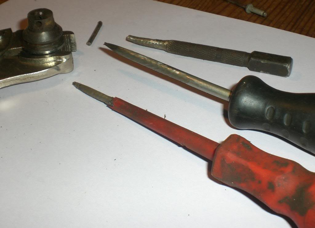

I am on holiday this week, and from the relaxed position of not actually having to finish a job on the car to get mobile, I have retrieved my old radius arm from the shed again, and had a session with a club hammer, a grinder, a punch, and some old screwdrivers.
Earlier on in the thread I reported that I had enjoyed a fruitless couple of hours trying to get the rusted pin out of the arm just for amusement.
Well here is a picture, of tonight's 2-hour effort.........success this time
With the arm off the vehicle it can still be a pain getting the pin out, but the chances of success are much better.
My own views.
File the pin flat even if there is a millimetre or more poking out.
Get or make a decent punching implement of the right dimensions. Its better if the "punch" is close to the diameter of the pin itself. I made mine quite crudely out of a centre punch ground down, and screwdrivers ground down. Not very clever or effective. Found myself constantly regrinding the implements to smaller diameters.
Punch from one side then the other in turn and for many repetitions and liberally plus gas the hole/pin.
Wiggle and turn with mole grips once the pin frees off to get it out.
On each occasion I have done the job the pin punches out from the outer to the inner side of the arm.
You may see from the photo that the bottom of the cup emerged damaged- a combination of rust in the recess, the heavy punching process with too wide punching implements and the proximity of the drilling in any case to the bottom of the "cup".
regards

looking at the remains of that pin the furthest end away in the picy looks bent over, maybe that could be the cause of the pin being stuck????
