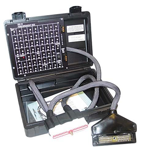

Instead of plugging the test harness into lexia you plug it into a manual box & you can test things direct with a multimeter, you can also bridge wires & power up or earth wires, you cant to that with the electronic one.superloopy1 wrote:BTW, what do you mean by the manual breakout box, can you explain?
Looks something like this

Thats not even a Citroen one but it's a similar sort of idea, couldn't find a pic on the net of a citroen one. I think the one in the pic is for Ford.
You cant buy them new anymore anyway, they only have 126 pins in them & some of the modern control units have more than 126 pins in them so no good for modern control units. The only unit compatible with the newer ECU's is the electronic breakout box for Lexia 3.
Mines is at my mums house, I need to pick something up either today or tomorrow so i'll get a pic.

Can you still get these?wheeler wrote:Instead of plugging the test harness into lexia you plug it into a manual box & you can test things direct with a multimeter, you can also bridge wires & power up or earth wires, you cant to that with the electronic one.superloopy1 wrote:BTW, what do you mean by the manual breakout box, can you explain?
