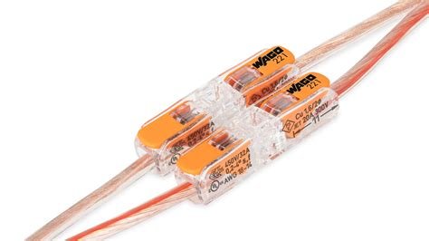

Have to admit that I would probably have bodged it with one of these:-
As long as it were to remain dry.

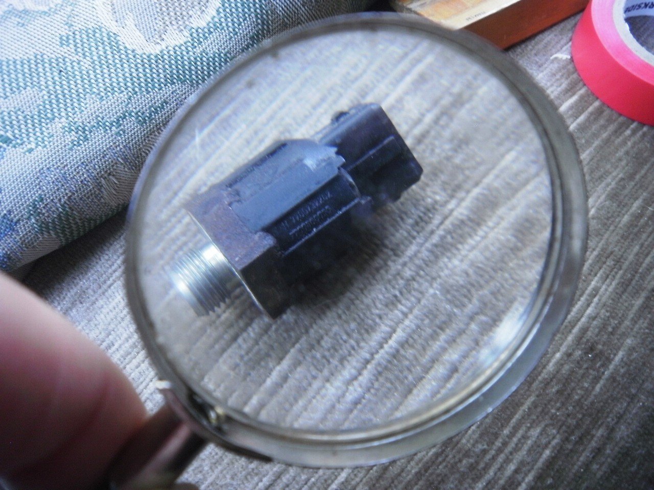

Not enough (indeed none at all) tail on the broken white wire to restore that fitting without the destruction Steve. No doubt the very experienced with the "knack" will be able to de-pin those connectors, but they did come out with a little bit of reasonable force but enough of the white one needed exposing to get it out.myglaren wrote: 06 Apr 2026, 18:52 Have to admit that I would probably have bodged it with one of these:-

The Knock Sensor Resistance between the pins, off the scale on all scales of the Multimeter up to 2000k ohms
The internet tells me a typical resistance value for a knock sensor..2.5k ohms to 3.5 k ohms.
Cant think that sensor is sending any useful info to the ecu, and I have never heard the clio pink or knock in its life!
Knock sensor 7700732262
https://www.autodoc.co.uk/car-parts/oem ... 7700732262

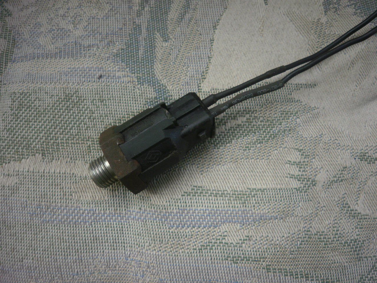

- Posts: 26424
Re: Falcon's Bargain Basement Motoring
Knock sensor with two new wires.
- Posts: 26424
Assuming the original sensor is now dead as a Dodo, and probably has been for some time, not sure what change a new one is likely to bring.
The most common motor factors round here are NAPA, supplying the trade as well as retail. For some things they are quite competitive, for Knock sensors for a 23 Year old Clio's way way way off the mark. £55 plus VAT.
The autodoc one I linked to earlier with matching OEM number...£12.99 inc VAT excl delivery costs.
No contest
No contest

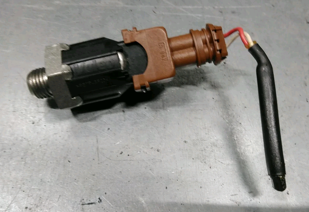

- Posts: 5334
- Joined: 25 Apr 2022, 09:03
- x 2354
Not a particularly good example (given the forty quid postage rather undermines a pretty good price for the part!)
But maybe look out for a knock sensor removed in that way scrapyards often seem to favour (hack it off complete with chunk of loom)
https://ebay.us/m/jDiMh9
- Posts: 26424
Thanks Matt, That's the exact thing (the brown bit!). Pop the bonnet up on anything Renault of a certain age and something similar must be lying around.
