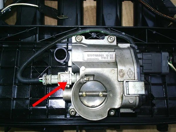

Some things take a bit of finding. I can confirm that on the D4F 712 Engine the Intake Air Temperature Sensor cannot be seen on view anywhere in the engine bay or on the visible part of the Intake Manifold. Similarly if you are looking for the throttle body to be visible in the engine bay, with the BB Clio's version of the Renaults D4F engine you will not be able to see it.
In the case of the Throttle Body this is mounted to the underside of the plastic Air Intake Manifold....and the IAT sensor is mounted on the throttle body.
Probably the only picture on the internet of the said IAT sensor in situ on the Throttle Body comes from Lancs Dave on Renault Forums.co.uk
Lancashire lads know their stuff Matt!
https://www.renaultforums.co.uk/threads ... ost-936003

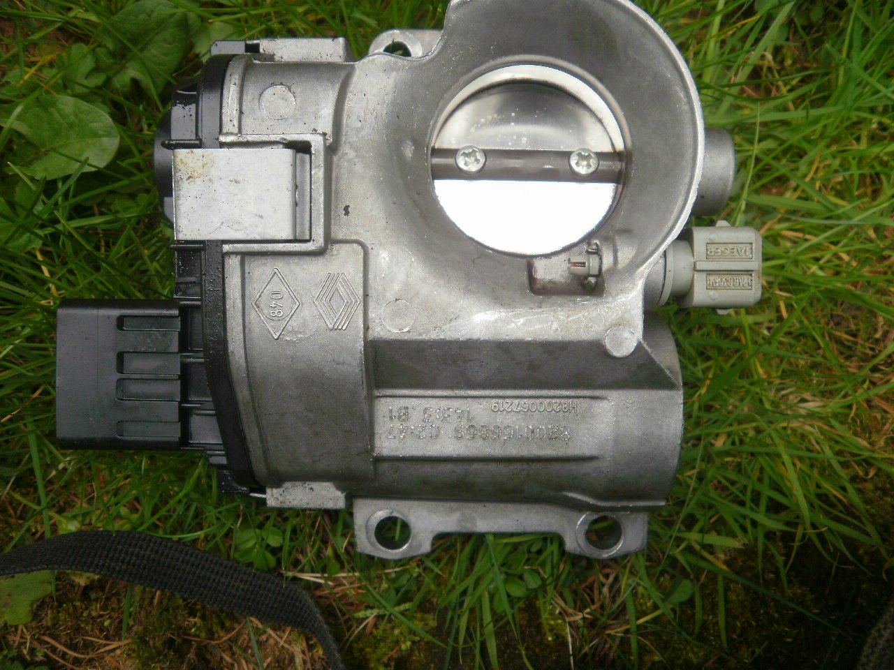

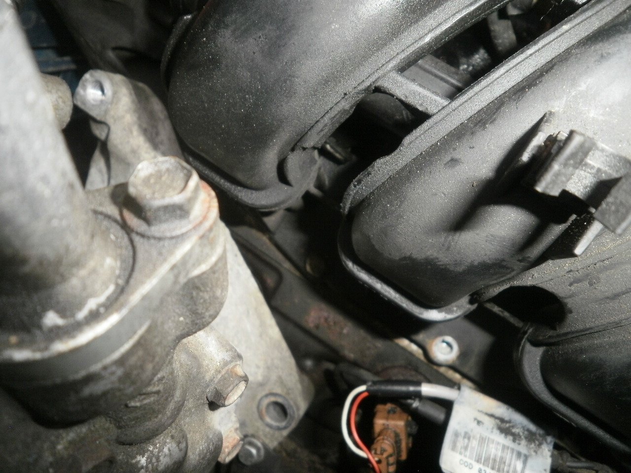

Today saw the inlet manifold removed, not on the bench still with a few wires attached, but enough free rein to peek underneath at the throttle body.
Yes the Intake Air Temperature sensor is there poking into the airflow just before the throttle valve. I will describe the throttle valve orifice for you awkward taking a pic. Yes I would describe it as not in the tiniest bit sooty or deposity, and hardly worth a squirt of stuff to clean it! I don't think that valve is "stiicky" in the least. Not a good idea to manually poke them, upsets things with the electrics/electronic fly by wire operation.
Was following the throttle body removal video linked to earlier in the thread, his car didn't have aircon though. Yes the inlet manifold bolts are much more readily removable in the video than with the BB Clio, the difference being the BB Clio has an Air Con compressor and its plumbing in the way!
This pic probably doesn't show things very clearly, but take it from me the Air con compressor needed unmounting (pretty simple) to gain access to some of the inlet manifold bolts to get a tool in to undo them.

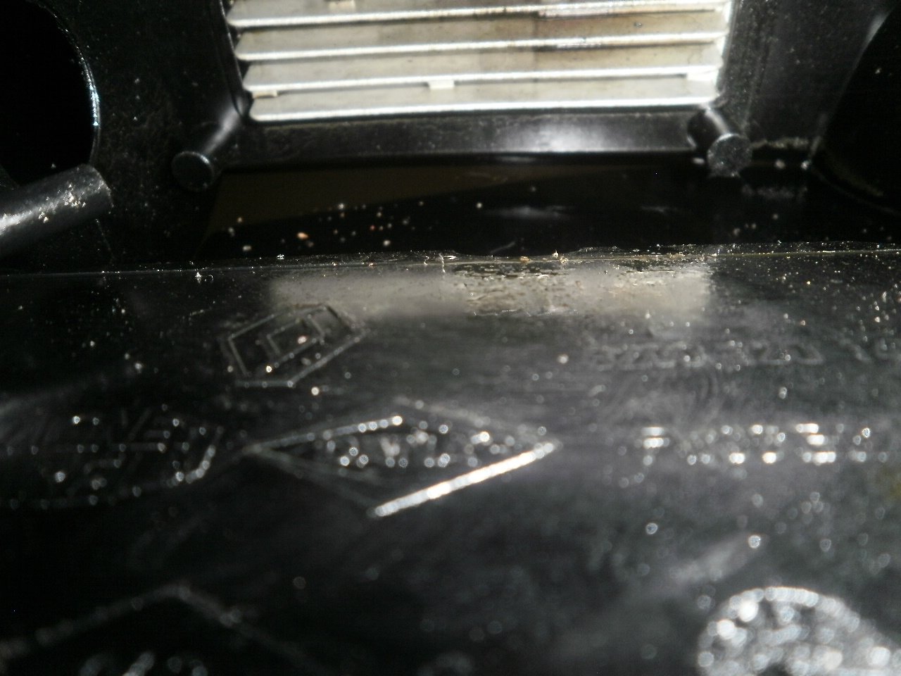

The bits are off
Throttle Body Its had a spray of carb cleaner so looks shinier than it was. It did have a small degree of black stuff round the edges.
Inlet Manifold and injector rail
the void on taking off the intake manifold ah the wonderful crankcase ventilation system discharging into the air box, and depositing a nice pool of oil. Not sure what the "grill" thing is maybe its a vent thing to make sure the cabin gets the benefit of a hot-oil smell!
EDIT This problem of oil in the airbox appears to be ubiquitous for the Clio. Crankcase vapours oil and all are vented directly into the large plastic airbox (filter on the D4F 712 is at the side of this), and oil accumulates at the lowest point. Long thread here on Renault Forums https://www.renaultforums.co.uk/threads ... rbox.68736 without solution the design creates the problem.

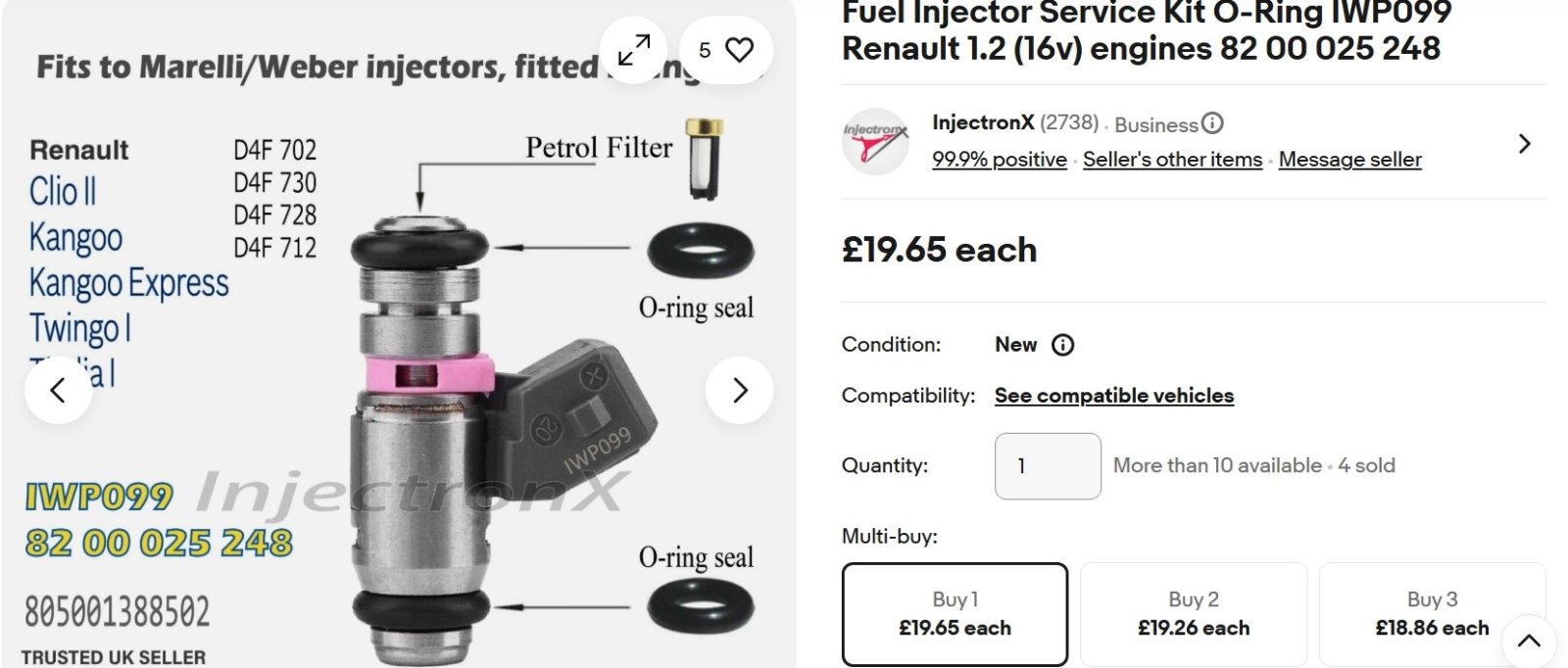

"Best I could come up with was Intellectual Stimulation, an inherent persistence to try to solve puzzles, and a desire should the car be moved on that the new custodian receives a car in good working order.."
In the interests of that philosophy this little package may assist. I have done most jobs to maintain and repair the family fleet, but have never tried to refurbish petrol injectors. Something new! (whether they need it or not!). You tube vids suggest its not that difficult and a clean and refurb is worth a go,

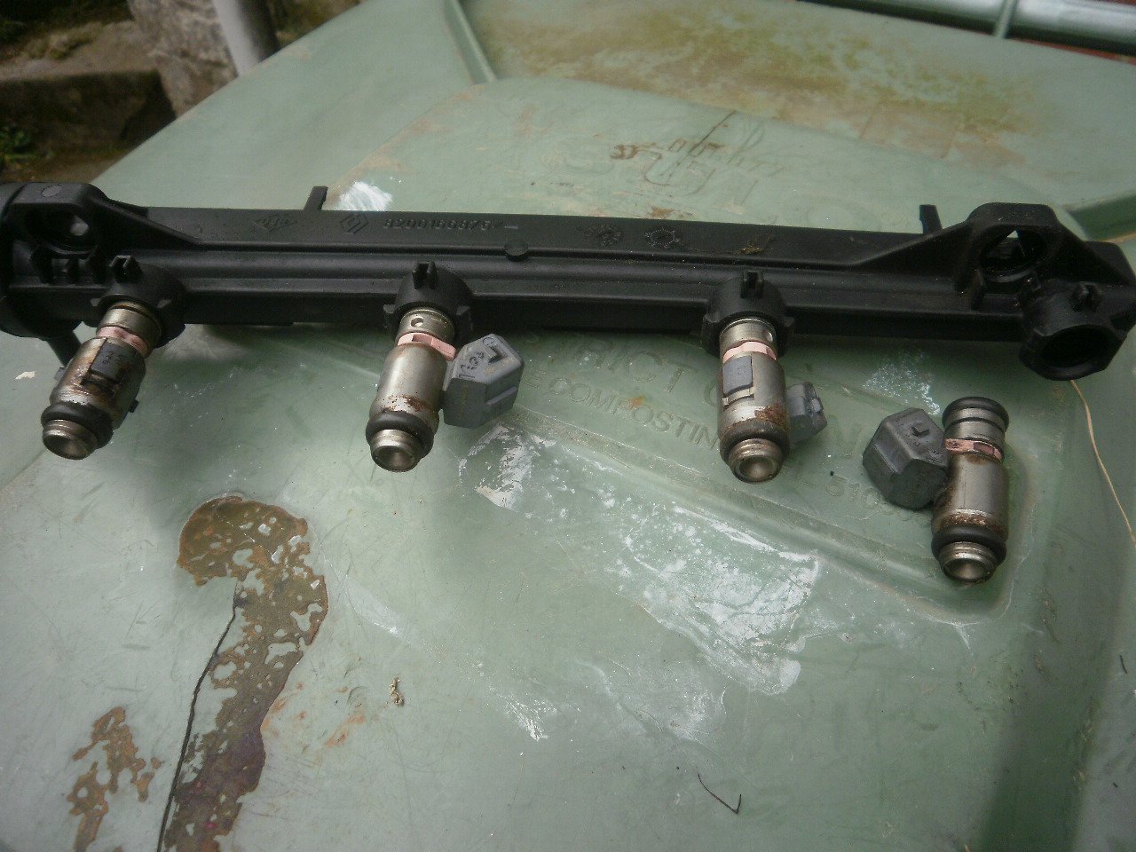

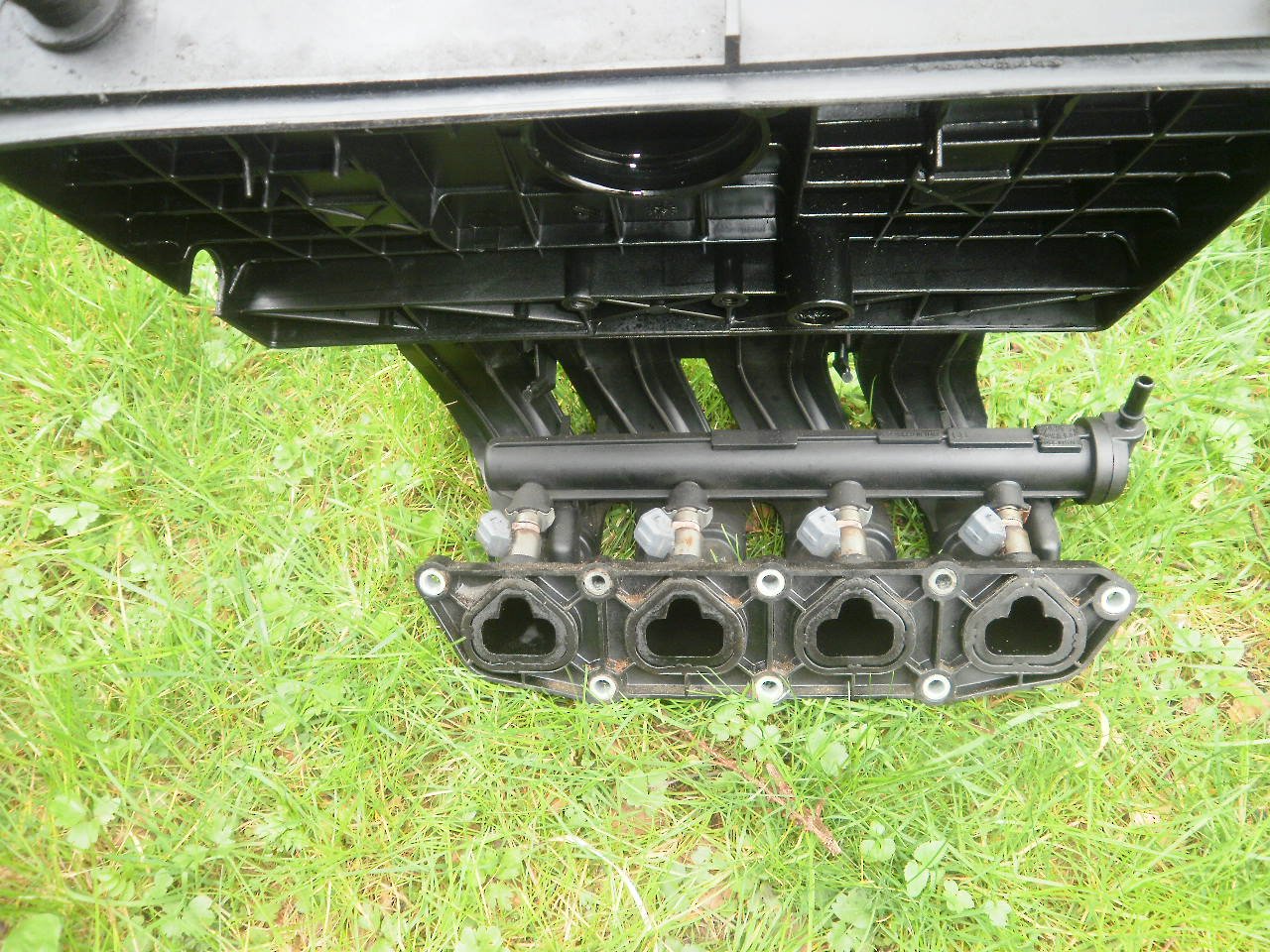

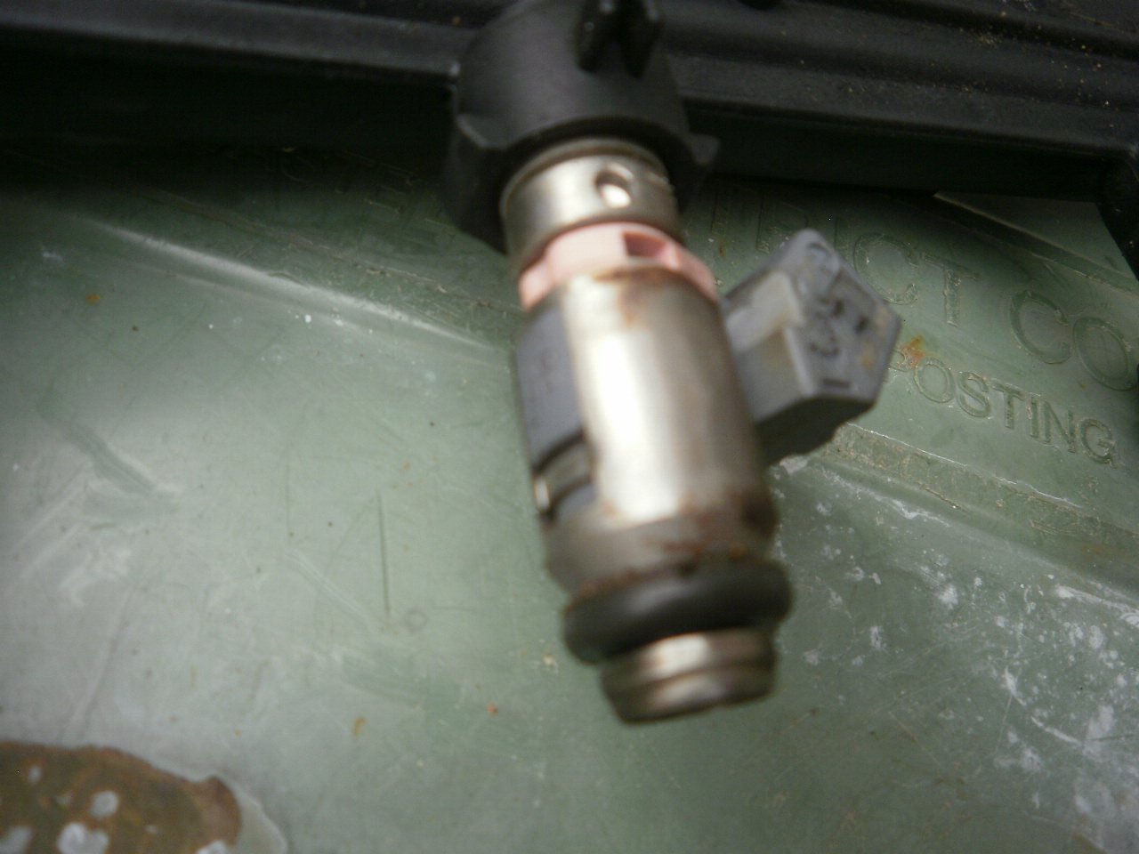

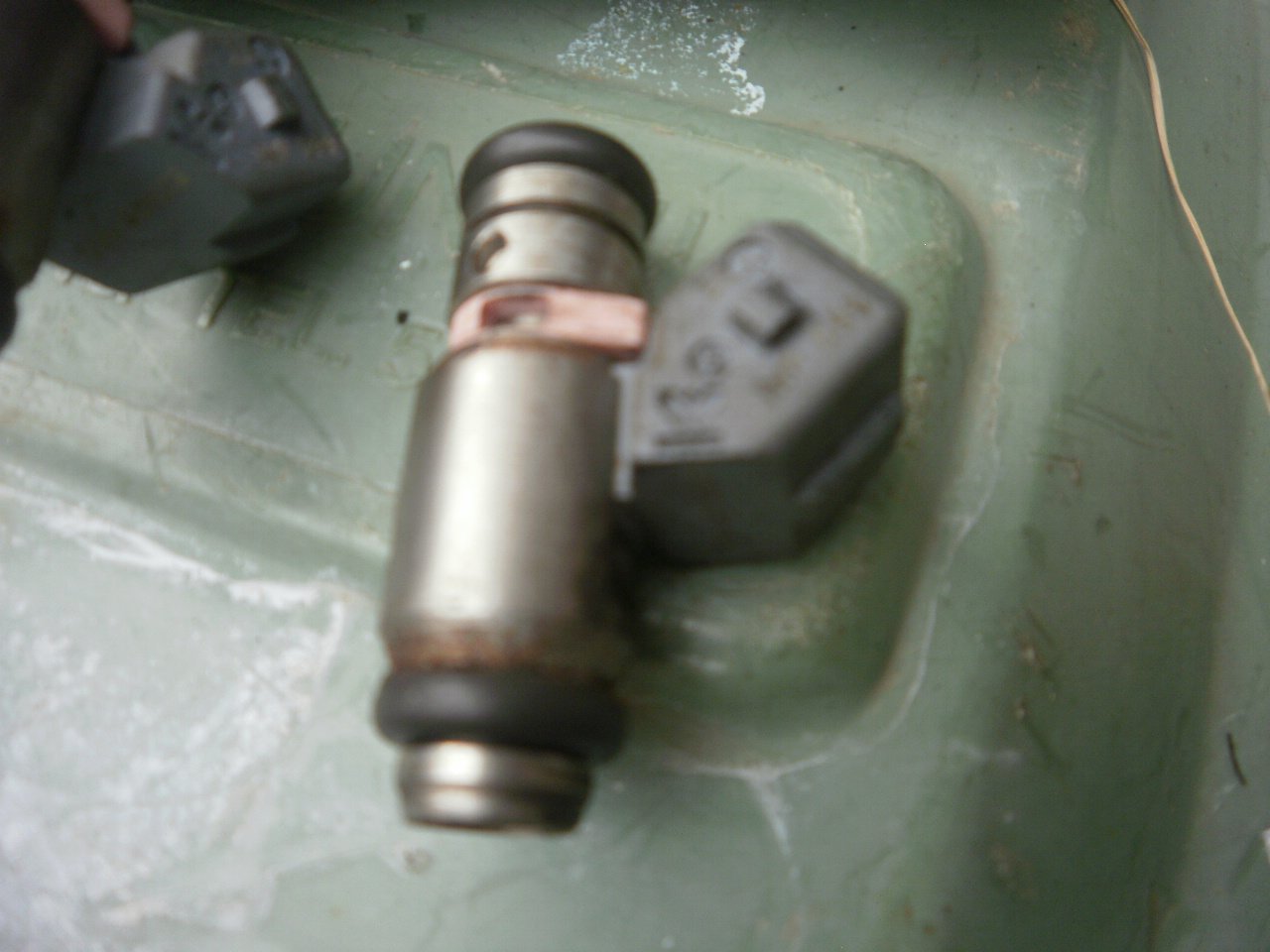

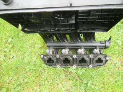

Did a little more dismantling of a gentle nature in an upright position.
The upright position being important in that I am now a fair weather tinkerer and am easily put off by the weather.
Today it was/is dry but cold. The cold definitely rules out any sort of lying or kneeling on the ground for example to remove the wheel arch cover to get at the awful EVAP system plumbing, activated charcoal cannister, and its dodgy solenoid valve mounted behind the headlight and behind the wheel arch cover.
The fuel rail/injectors on the detached air intake manifold...I could do that upright and take a photo of the result. They look like they have lived a life, but the O-rings look reasonably sprightly for their age, but a replacement item of course for re-assembly.
