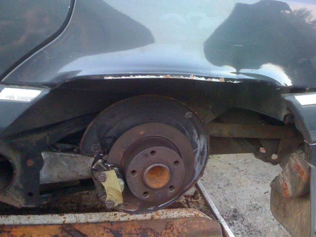

Yep that's KYAC - still in rude health and just fresh from a new MOT and 6 month's tax.
You may recall I caught some diesel on a mini roundabout and went roundabout removing
a rear wheel in the process? Don't mention it had a boot full of heavy kit and I wasn't exactly
dawdling at 1:00am...
I had to swap the whole arm as it ripped off the hub and the front hub casting BENT at the
lug where the lower balljoint attached pitching the whole camber of the front wheel!! :shock:
Hey, sorry, this is turning into my blog but does illustrate how indestructible these are even
when you abuse them!! Reading this Vince!? lol
The only thing is I damaged the wing when the wheel detached...
