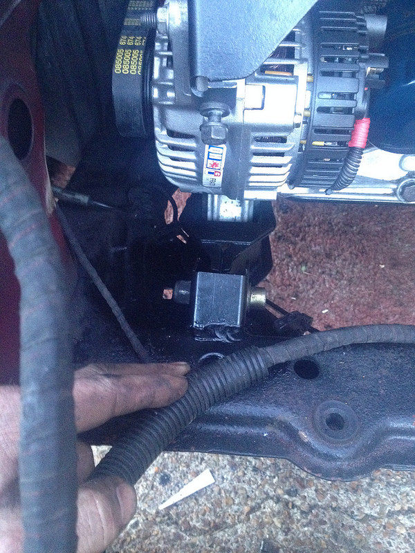

So, engine mount time. here is what the 2.0i subframe provides, bearing in mind this is fitted in exactly the right place for the V6 engine mount, and my engine was as top spec as a 2.0i engine can be im not sure what this fitting is for. It has now been removed though. Its worth noting that both V6 and 4 cylinder subrfames are the same, the V6 version has most of the important 2.0 bits like the cutout to accomodate the inline engines sizeable sump and the pressed section for the rear engine mount is all there so its only a case of a little basic fabrication to make either subframe work with either engine.
ImageIMG_3245 by Deanxm, on Flickr

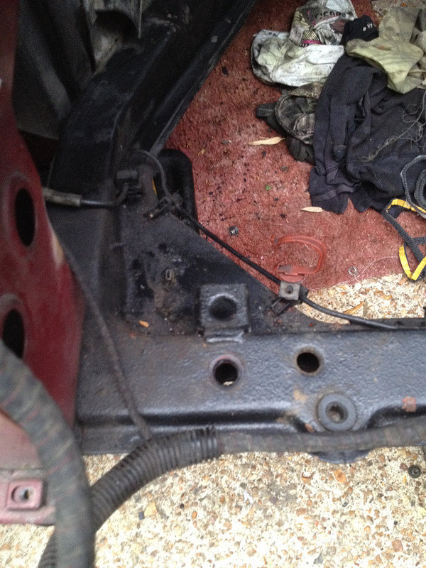

Now we all know what dreams are made of, this is what V6 engine mounts are made of, well, mine is at least.
ImageIMG_3244 by Deanxm, on Flickr

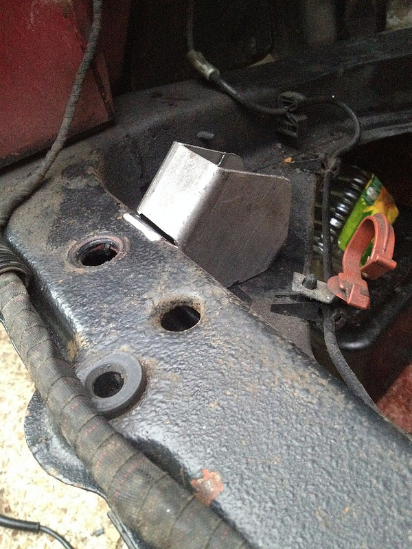

A bit of work with the measuring stick, some carefull cardboard template fabrication and a quick session with the wirly spark thrower
ImageIMG_3247 by Deanxm, on Flickr

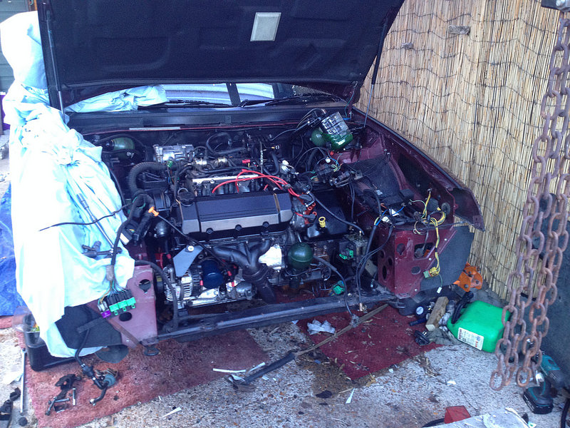

And here we go, this is what ive been waiting for!
ImageIMG_3249 by Deanxm, on Flickr
