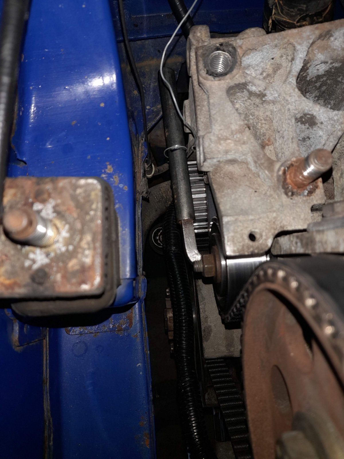

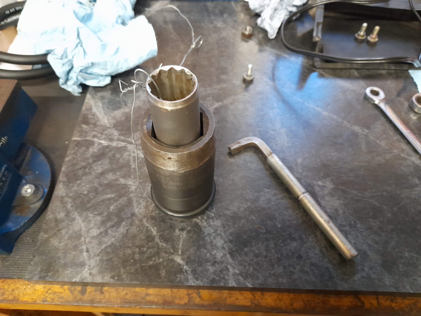

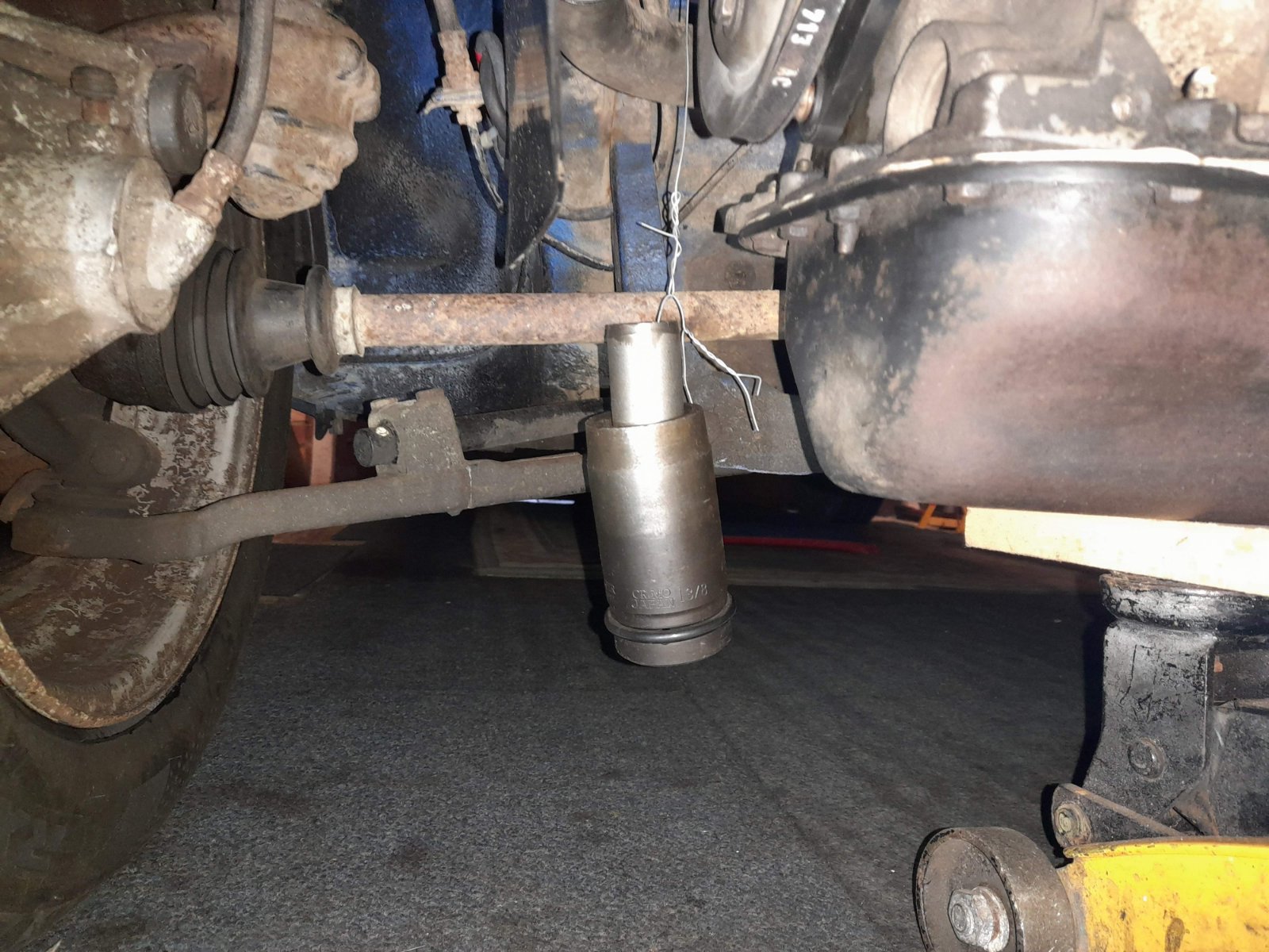

This afternoon has been very interesting...
I had a feeling in the back of my mind that Bluebell's new cambelt was just a fraction too tight so today I checked it...
In doing so I learned something quite significant that Haynes fail to mention when using a SEEM gauge...
I decided to reset the tension using the old-school pre SEEM method of hanging a 1.5Kg weight 8cm along a bar inserted into the tensioner square...
First I made my 1.5Kg weight using a big Xantia hubnut socket, a 24 mm deep socket and a bolt! Weighed on my kitchen scales...
Then set it up...
Bar in the tensioner square hole with the weight attached to a groove 8cm along it...
And the weight dangling below...
I did this with the engine stone cold and felt the belt was very slack...
I popped the SEEM gauge on, out of curiosity, and saw it reading 20. For the Saxo 8V 1.1TU engine (practically identical) the Haynes BoL quotes 45 SEEM units... This value was what I originally set Bluebell's belt tension to.
I then started the engine and let it get up to temperature...
When I stopped it to recheck, the belt felt much tighter - the engine 'grows' as at warms up - and the SEEM gauge read 45 units!
As it cooled I could see the SEEM units going down again...
Therefore the moral of this story is that the SEEM reading is valid only for a hot engine and not a stone-cold one... No mention in the BoL that it's very temperature dependant and if you set it to 45 SEEM units on a cold day it'll be too tight when hot...
One small issue I noted whist watching the cambelt with all the covers off is that it does not run 100% absolutely true. It 'walks' from side to side on the cam sprocket... It's very tiny - maybe 10 'thou total but noticeable to my sharp eye... Further investigation suggests the water pump is not quite running true as the belt 'walks' a little more on its sprocket...
Both the water pump and tensioner, along with the belt, are brand-new. Maybe, being Autodoc stuff, not the finest quality perhaps? There's no sign of any fretting on the belt so I'm not going to worry. Just an observation and it would go unnoticed but for running the engine with the covers off...
As I say, it's been an interesting afternoon...

That is surprising about the belt tension. I would not have expected engine expansion to cause that difference. Is the belt perhaps shrinking when hot?
I can't imagine that PSA expected the seem tension to be measured hot, just think of the pain that would cause on an early es9 engine.
See also: gates link

xantia_v6 wrote: 10 Dec 2022, 18:26 I can't imagine that PSA expected the seem tension to be measured hot, just think of the pain that would cause on an early es9 engine.
I can only report my findings as I found Mike! My workshop was most definitely not at 'room temperature' today unless you're an Eskimo living in an igloo!
A most interesting Gates link :D The belt I fitted was an Ridex Autodoc-sourced one so maybe the belt, like the water pump, is not of the finest quality... Sally, my Saxo, has a proper Gates belt...
It's not an issue on an ES9 as the later ones had the automatic tensioner but yes, on an early one with the dynamic tensioner that needed a SEEM gauge to set it would have hurt doing it hot!
I must say I never experienced the same when I last set Sally's timing belt tension using the SEEM gauge but then again, it was done on a very warm day in full sun so that would have counted as 'room temperature' or possibly a little above...
This all, now, makes me feel I should keep a very watchful eye on Bluebell's belt... I don't want it snapping and may replace it (and the water pump and tensioner) with higher quality known and trusted items before too long...
