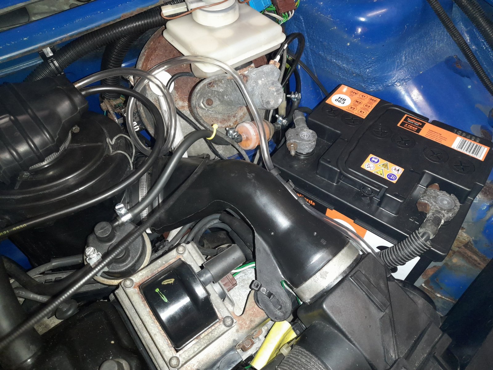

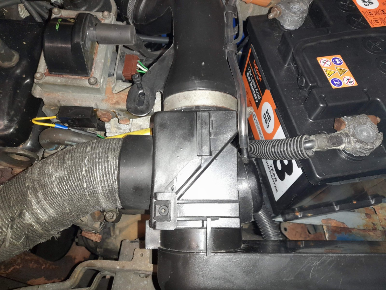

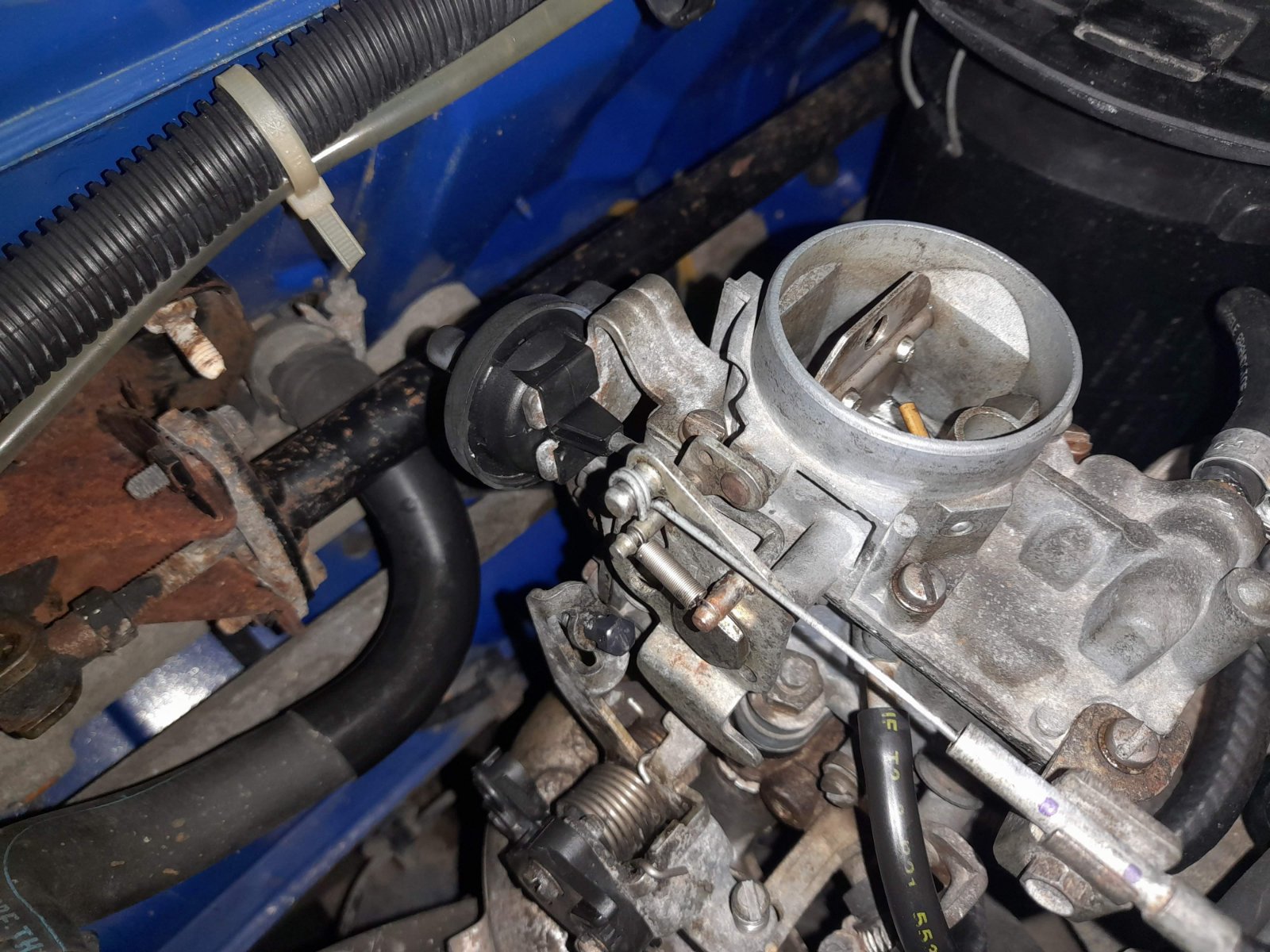

I did a bit of work to get the thermostatic hot air intake arrangements working on Bluebell this afternoon... It was originally disconnected. A piece of (temporary) clear pipe to the flap vacuum actuator up to the vacuum thermostat above the air filter and after getting the vacuum connections the right way round got it working beautifully...
Before piping it up I'd tested the system using my vacuum tester - part of my vacuum brake bleeding kit - and found it good.
With the carb drawing warm air heated by the exhaust manifold the warmup time is a lot more rapid and less choke is needed...
However, I was dismayed to discover there was still a bit of a flatspot when cracking the throttle open, even with the engine nice and warm. Not as bad as it was but there was a distinct hesitation and a slight misfire at around 2000rpm...
I checked the distributor vacuum advance capsule with my vacuum tester and all good...
Then I checked the choke pull-off vacuum capsule... Punctured and unable to hold any vacuum... This capsule is intended to pull off the choke under high vacuum. In case the driver forgets to push the choke fully home... It's not really needed and can be lived without easily...
The choke pull-off vacuum capsule sits on the back of the carb...
I blocked off its vacuum supply and there's now no sign of any flatspot or hesitation anywhere... The engine runs even more clock-like now...

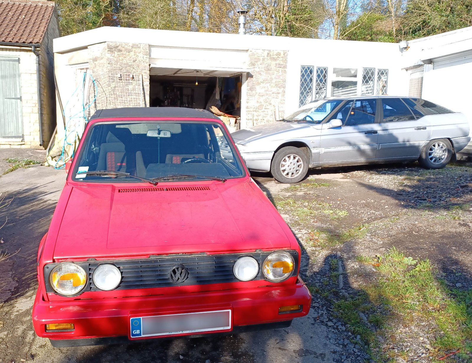

Bluebell's first long trip since recommissioning was a great and most enjoyable success 🙂 She runs very sweetly and her seats surprisingly comfy...

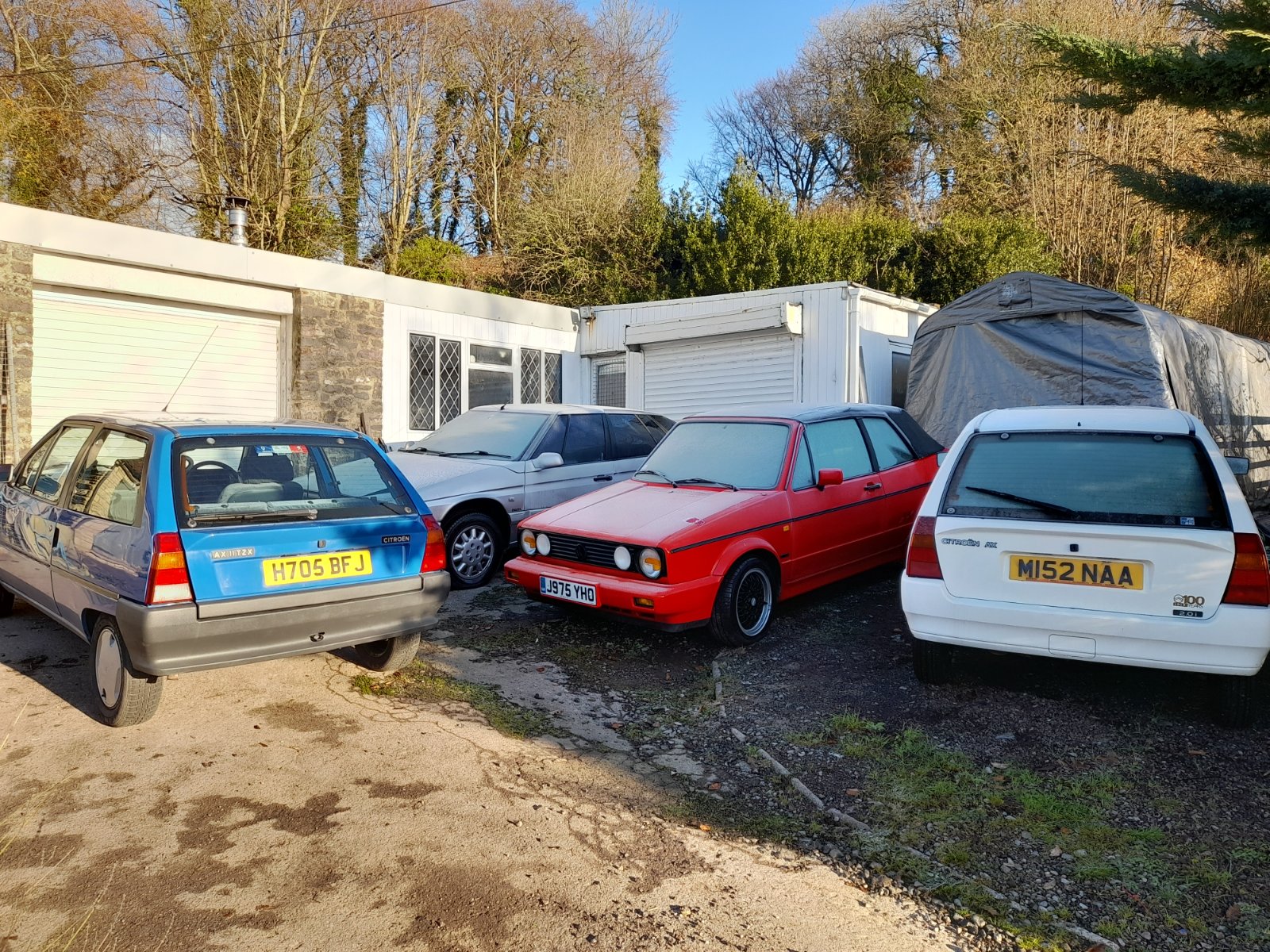

Here she is with her younger sister and some old jerrybuilt thing 🙂

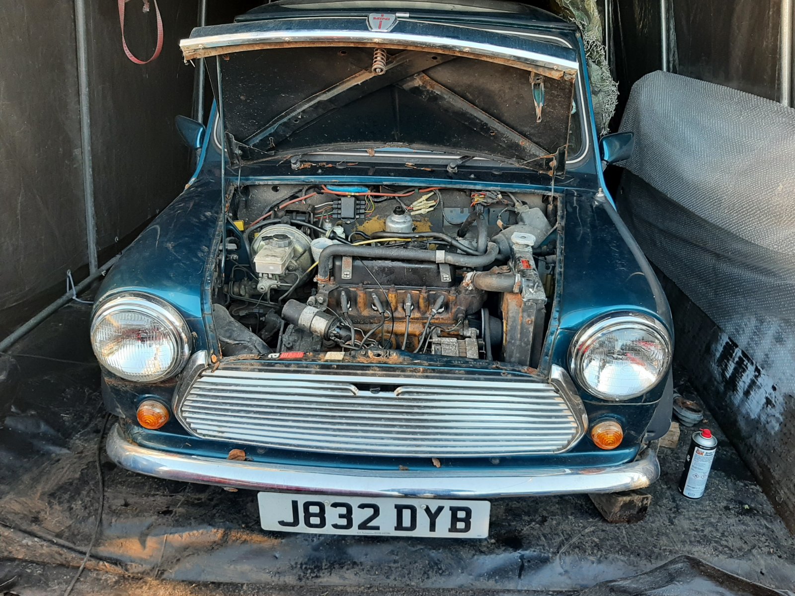

It cold down this way and I'm currently working to breath life into a proper classic Mini living in the tent behind the red thing...

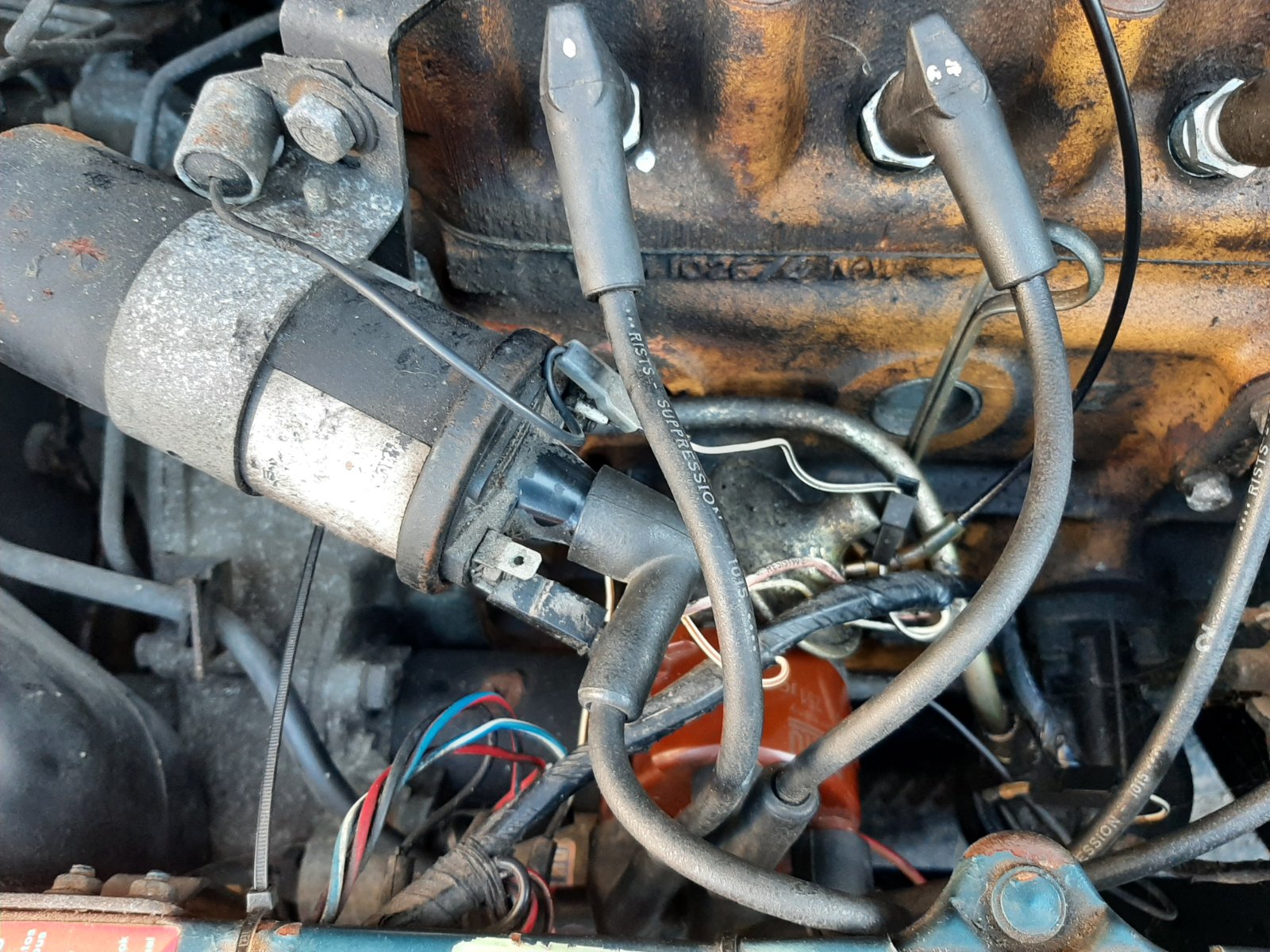

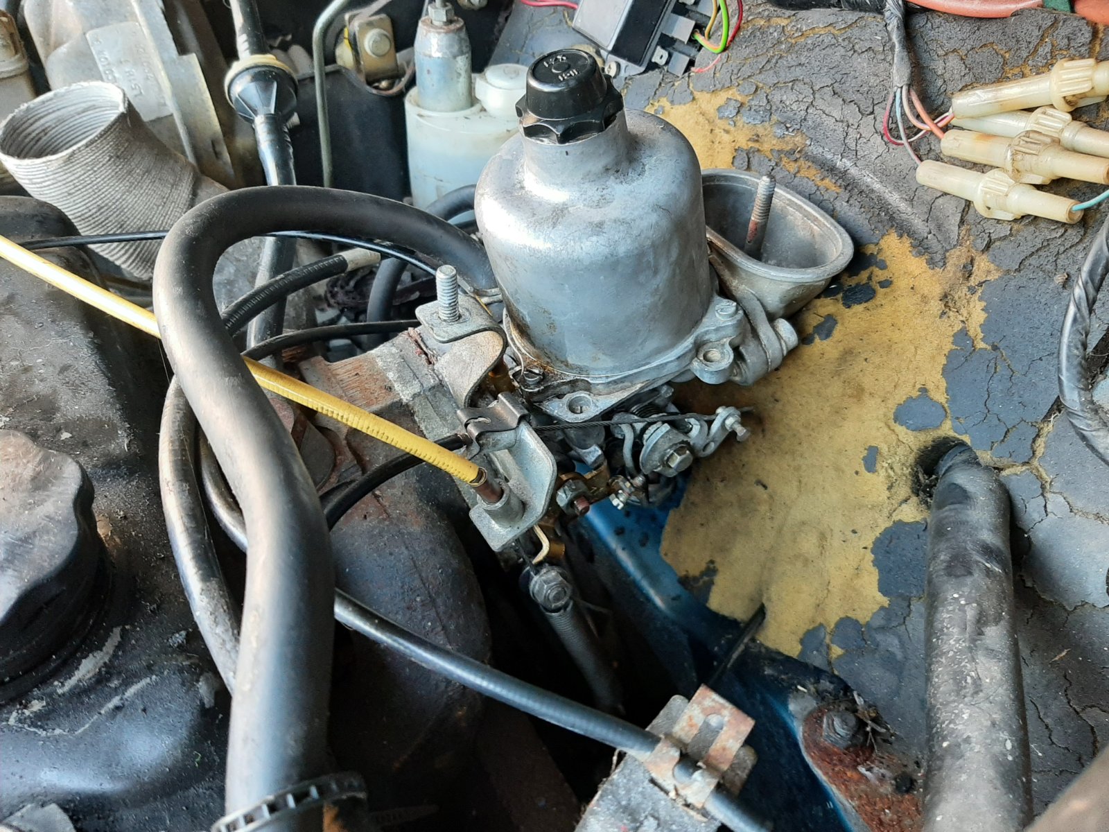

Later today 😉 And hopefully with a report of success. Currently it will barely run. Yesterday I saw the choke control was not working properly due to a gummed up sliding main jet stuck in the choke fully on position. Despite a full clean and rebuild of the carb it's still not happy. Attention today turns to the ignition system. Proper points and a condenser!
I feel very at home working on cars of this ilk and free of technology of all kinds 🙂 This Mini, despite being roughly Bluebell's age, is really from a much earlier era.
Except for their love of rust I still love the and would love to own one - a rust-free one, but my pockets will never be deep enough...
Posts: 55093
x 8395
Re: Citrojim's AX, Saxo, Pixo, Running and Cycling Tales
The Mini is now running sweetly 🙂
The carb overhaul certainly helped - it was mucky and well gummed up..
The real problem was with the ignition. It's proper points and whilst these were OK, almost new in fact, deep suspicion fell upon the coil or condenser. To eliminate the condenser I temporarily wired the radio suppressor capacitor in parallel with it...
That nicely proved the condenser duff...

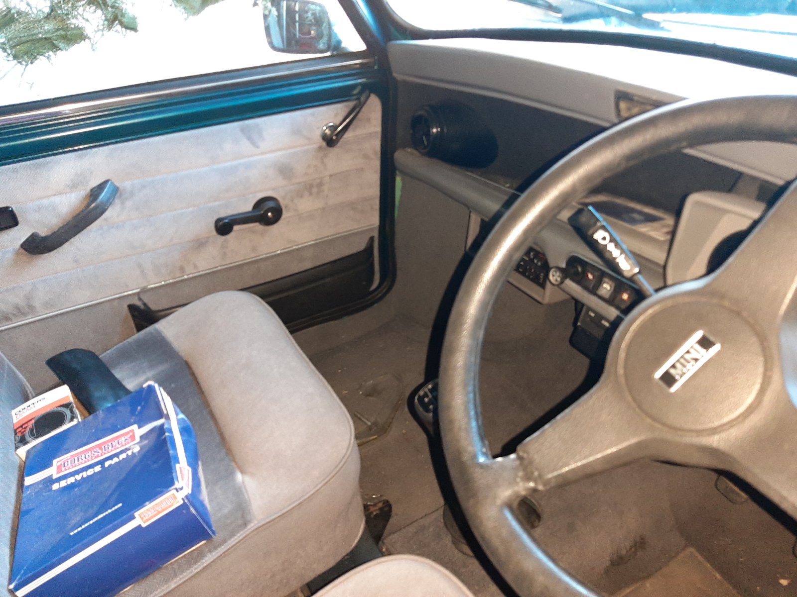

This Mini is a long-term restoration project and whilst it has a great interior...

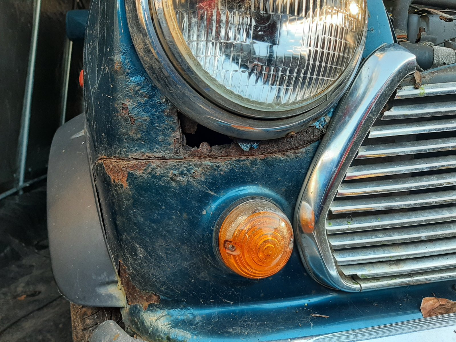

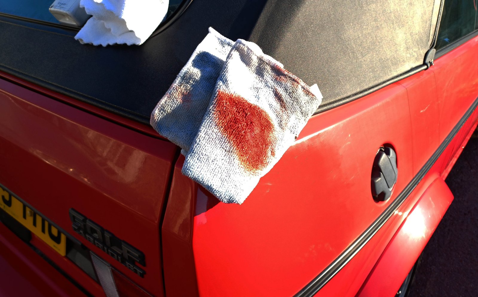

The exterior has a few issues... Such as this...

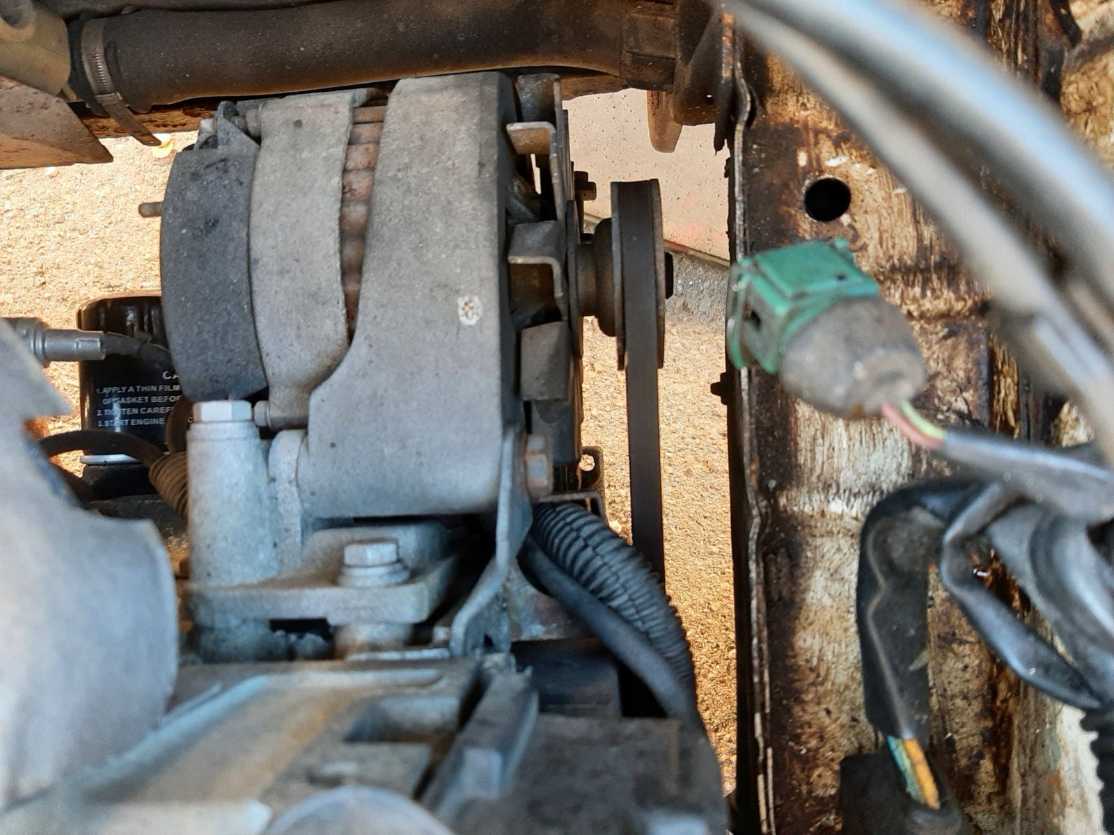

Whilst I had the tools out I tightened Daffodil's alternator belt as it was squealing on full load last night..

And one of Bluebell and friends this morning...

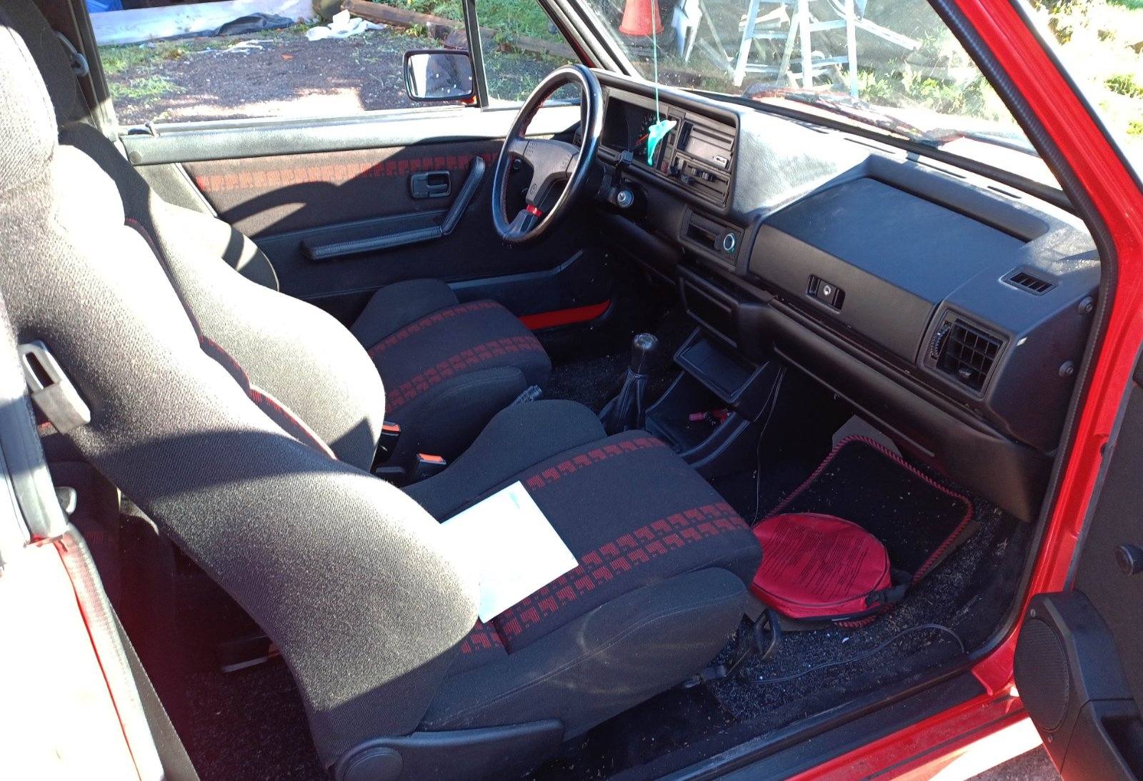

The Golf Cab is a temporary resident in for a winter re-commissioning and clean/polish etc to bring it up to A1+ condition......it has a grand total of 8500 miles on it ! having spent most of its life in long term (climate controlled) storage with starting/checks etc as the owners decided the Far-East was more attractive than the UK.
