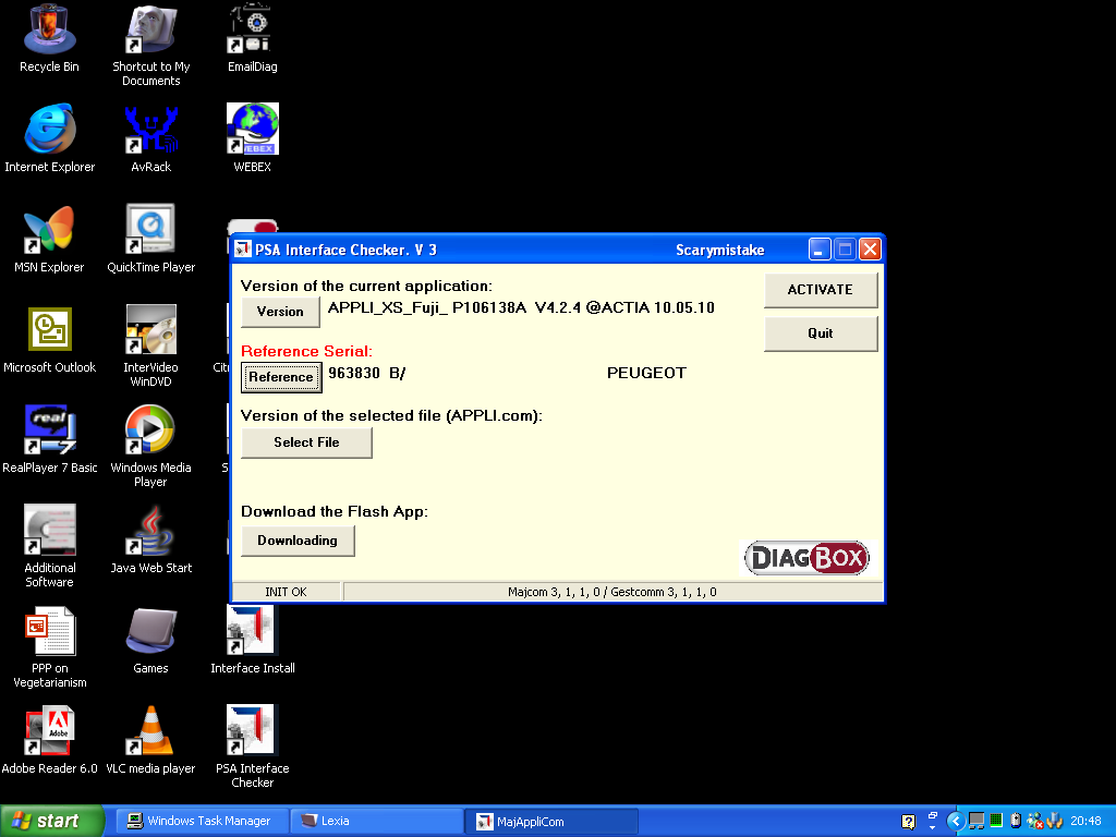

Just to make this a bit more difficult, the Diagbox stuff is installed on an old laptop running XP, when I try to load diagbox without it being connected to the car it always asks for the installation disk to install the driver. (when connected to the car it's fine)
Anyway here is the PSA checker result
- x 6945
Re: Merged Lexia & Diagbox threads
OK, you have the Revision B unit. Some of these XS devices have been blocked by PSA at any version higher than V5.29. This firmware version is ok to V5.29 too, so you should be good to go to V5.29.
