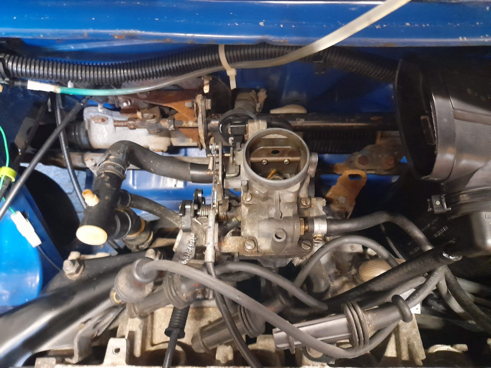

First up, a very simple job... Check the carb accelerator pump is working. A job I forgot to do when I gave the carb a check a few weeks ago...
It is
It is

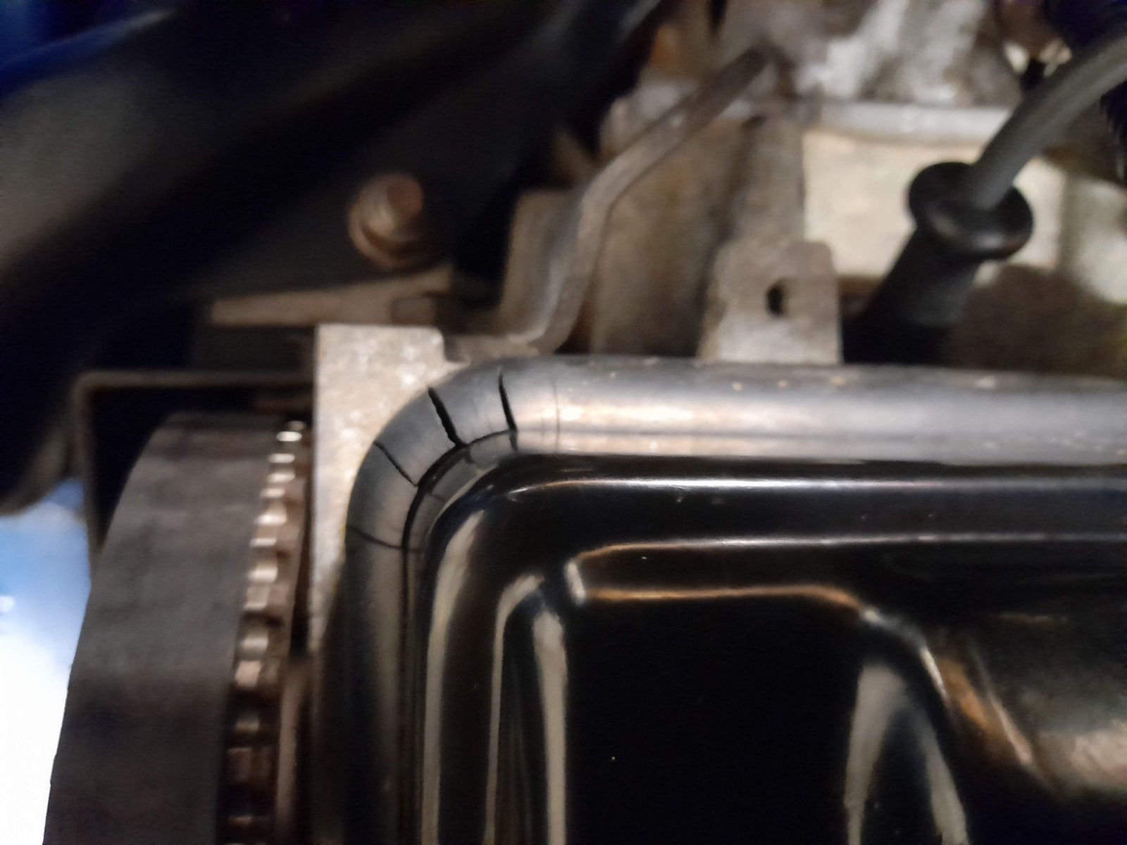

Does the old belt look to be running a little more off the pulley than the witness mark suggest it has run previously?

MattBLancs wrote: 10 Nov 2022, 20:25 Does the old belt look to be running a little more off the pulley than the witness mark suggest it has run previously?
Yes, it was Matt. It was right over to one side of the crank sprocket guide flanges after I temporarily replaced it a few weeks ago and stayed there and never centred itself... This time I was careful to get the belt in the middle of the crank sprocket...
The water pump was better than it looked... The one out of my Saxo looked much worse but yes, definitely up for replacement. Not keen to do it again any time soon!

I think, within reason (I e. Don't try belt only quarter of the way on the pulleys) that belt position is driven by one pulley in the system - normally crankshaft. Having a hard edge in both sides, hence all others running in a position following this guide. Belt running off slightly could be a sign of something pulling the belt out of line after the crank pulley - e.g. taken to extremes to aid the illustration: if water pump or an idler is imagined to be either bent, misaligned, etc then it'll affect belt position of following pulleys.
Or put it another way, a reason to be happy it's now on new belt, pulleys, pump

I'll be checking again before the car fully enters service Matt but having said that, I could find no significant play in the tensioner and water pump bearings although the tensioner was very noisy and rough so under pressure it may have been introducing just enough play to pull the belt off line...
I'll advise when rechecked... At least I have photos of when it was when first installed
