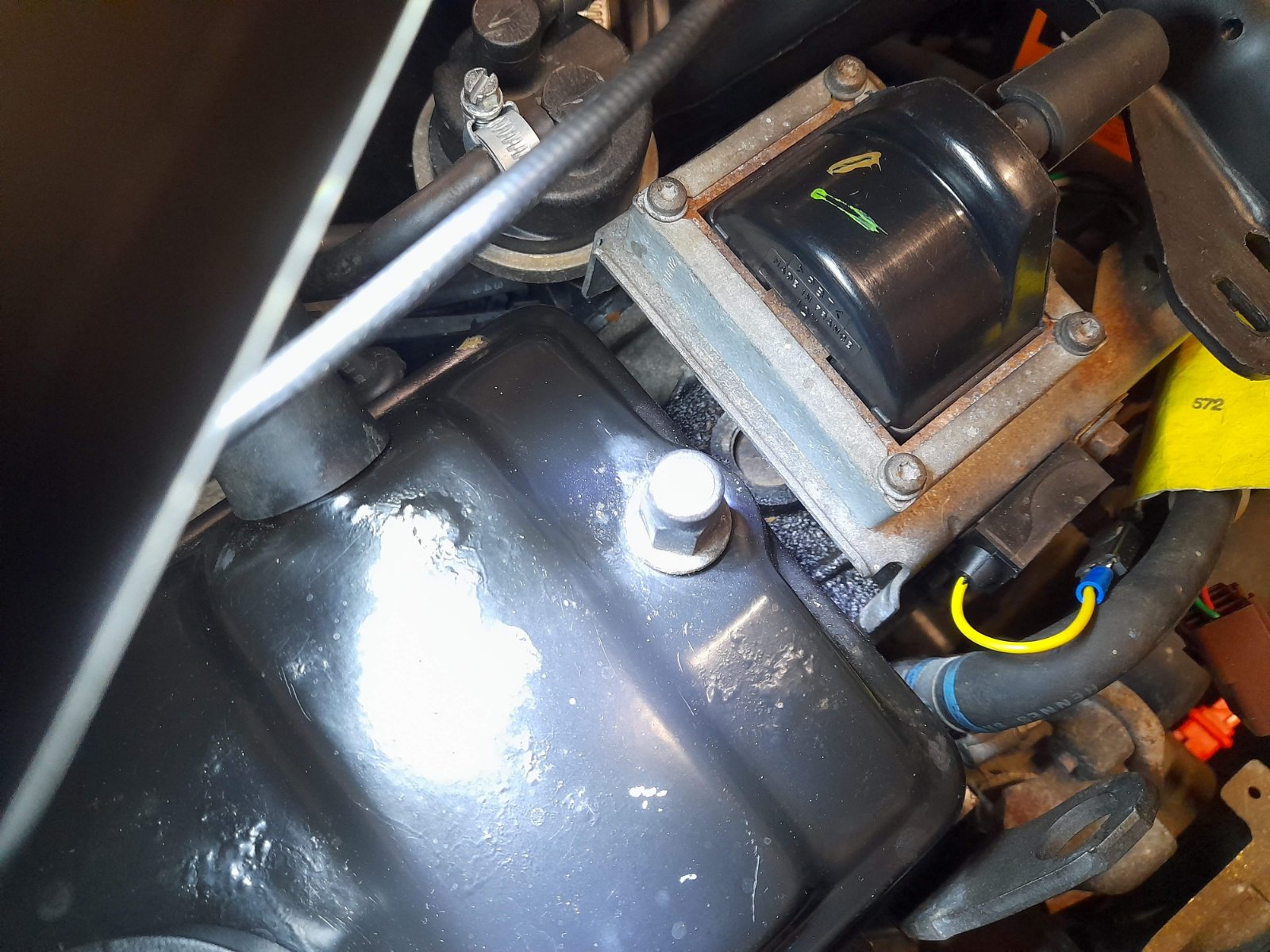

It's also leaking a little on the clutch side and making a mess under the ignition coil...
Oil leaks have no place in my world and get fixed...

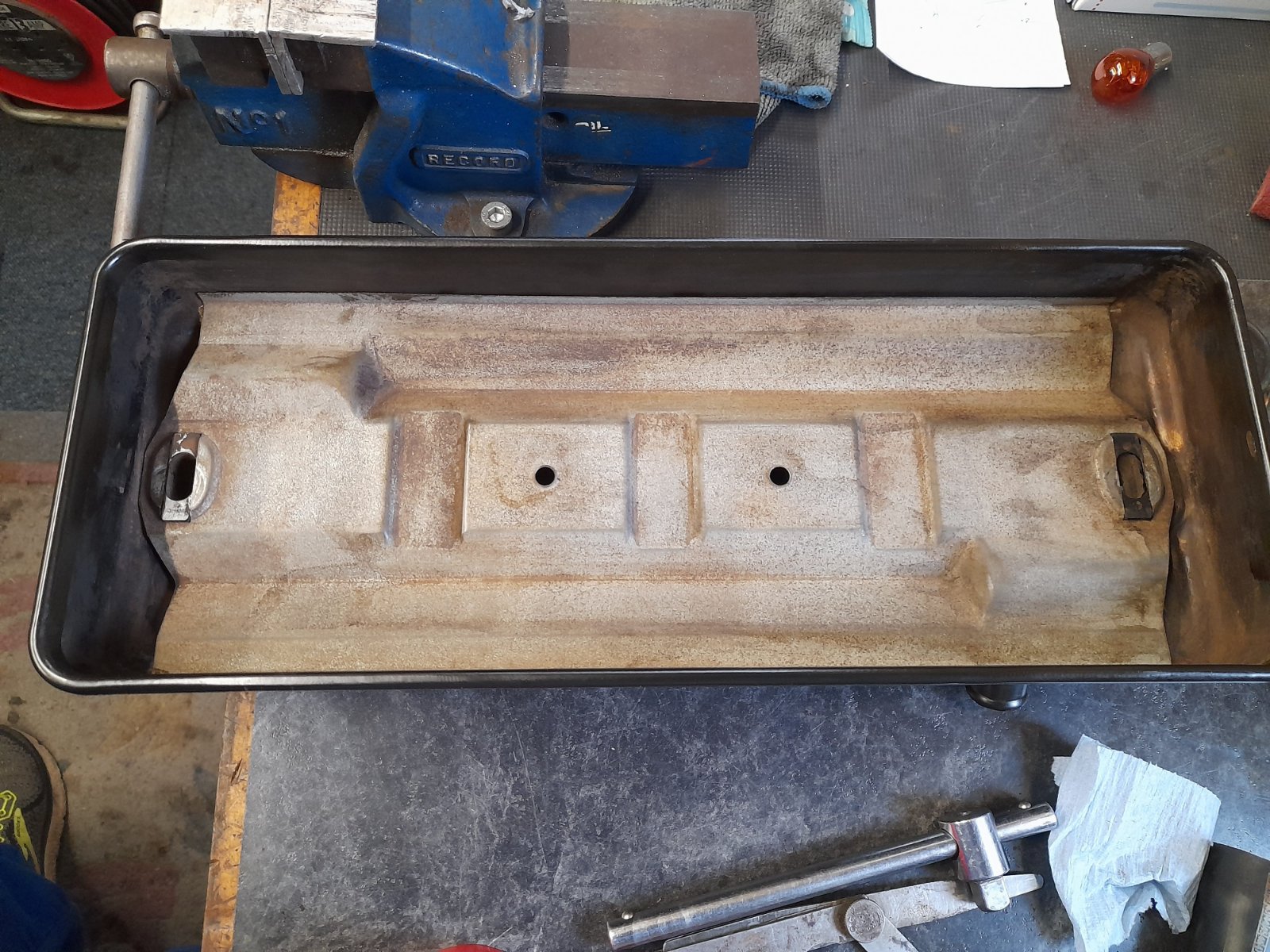

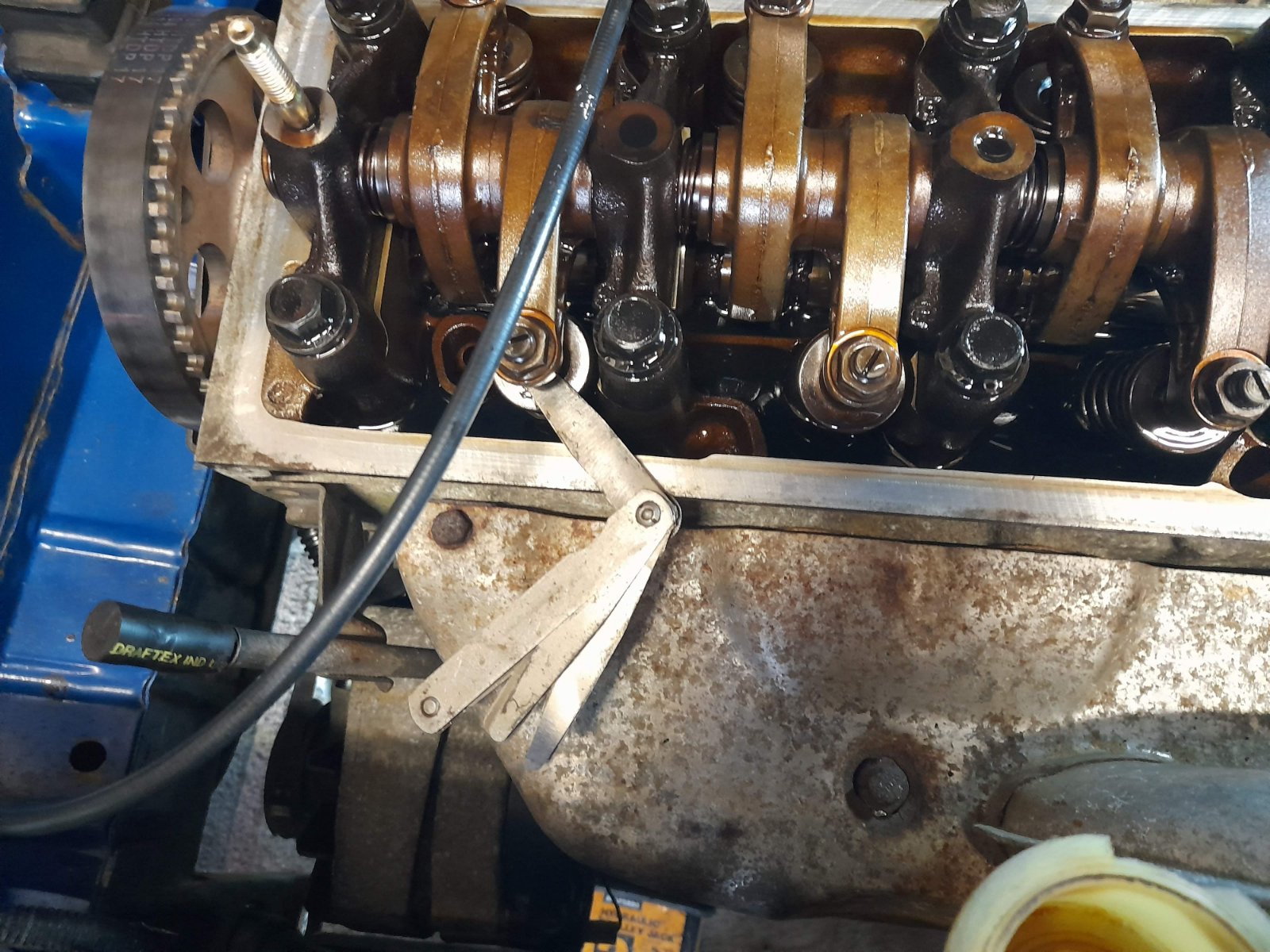

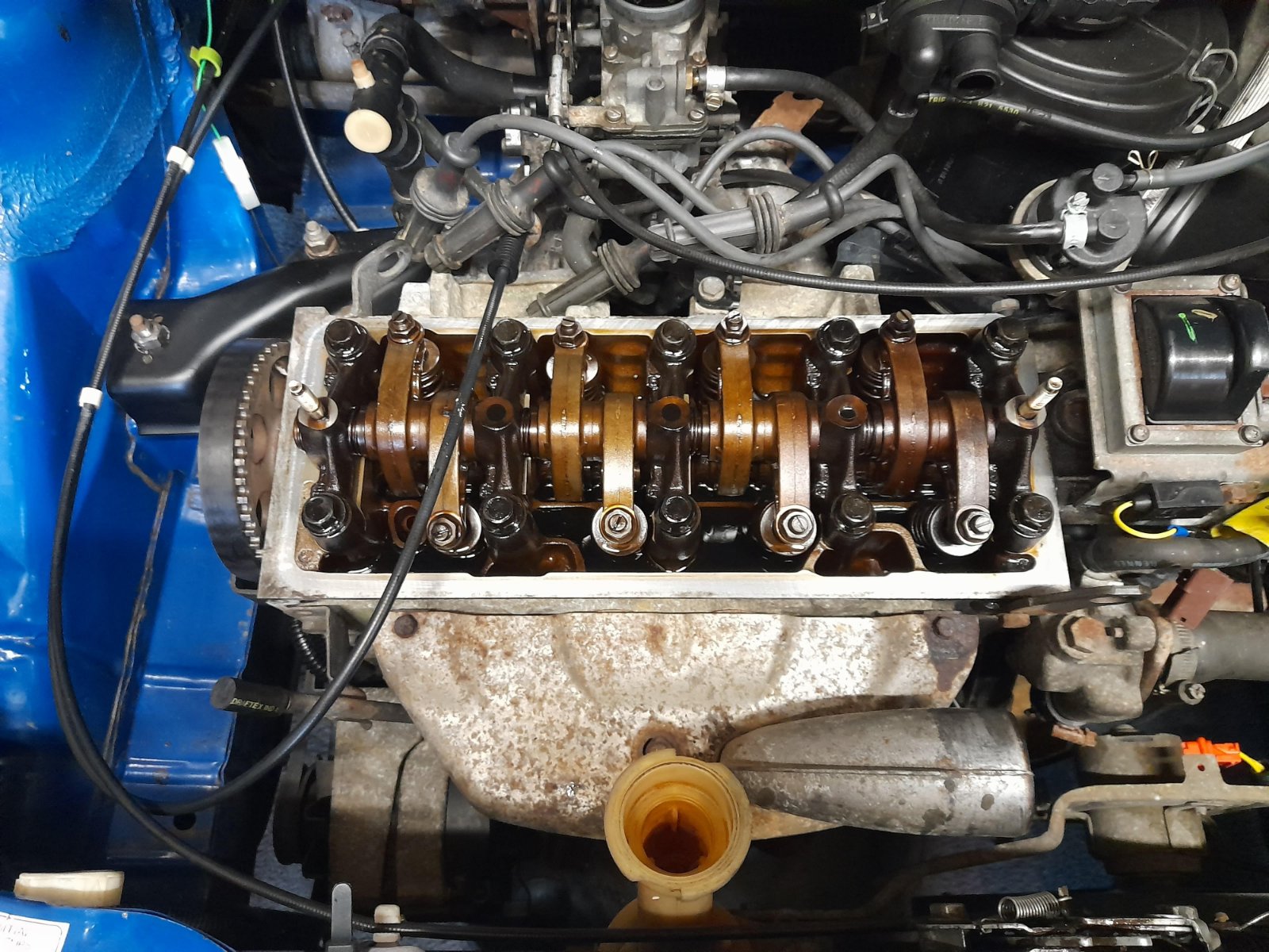

Next, off with the rocker box cover to replace its gasket and check the valve clearances... All nice and clean in there - albeit a bit oily...
The underside of the rocker box and top side of the baffle plate were quite mucky with horrible old sludge so some time was spent giving it a thorough clean...
That's better
Then a check of the valve clearances... For such a small engine it has some epically over-engineered rockers... Can't ever imagine them ever giving problems...
All were found to be good...
New gasket fitted and rocker box cover back on...

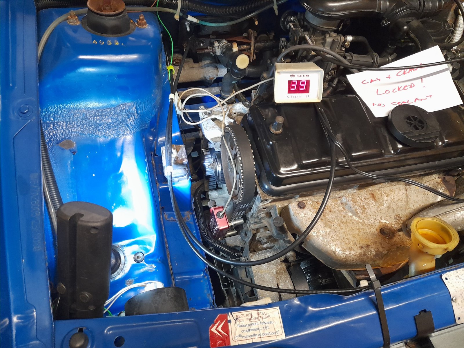

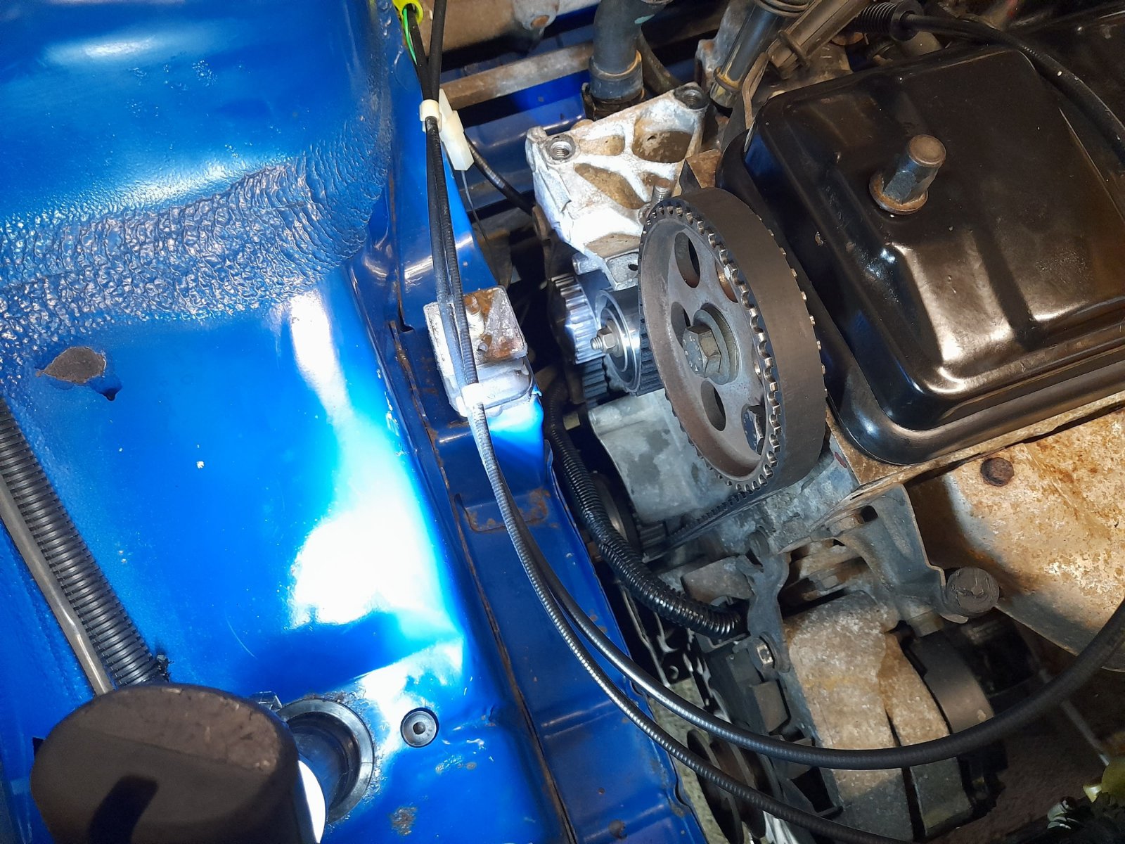

Then cambelt, tensioner and water pump...

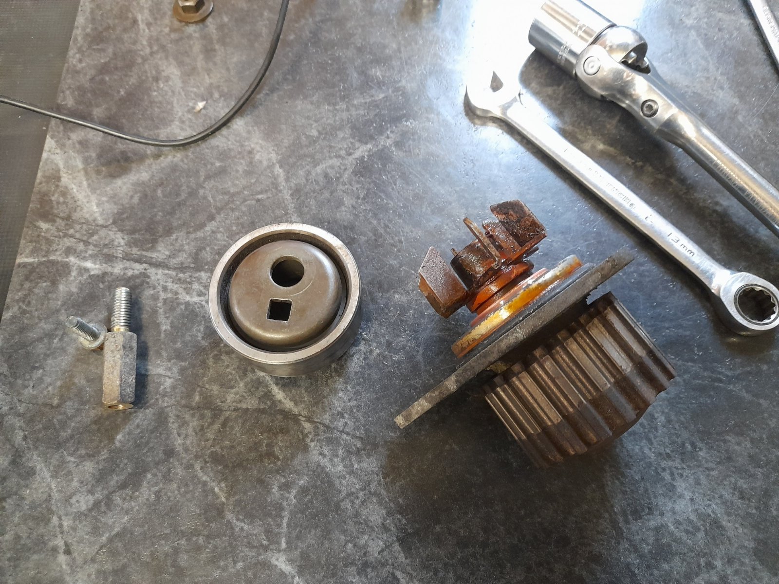

The water pump was found to be in quite good condition but the tensioner was bad - no play but biblically noisy...
New cambelt on and tension set using the SEEM gauge...

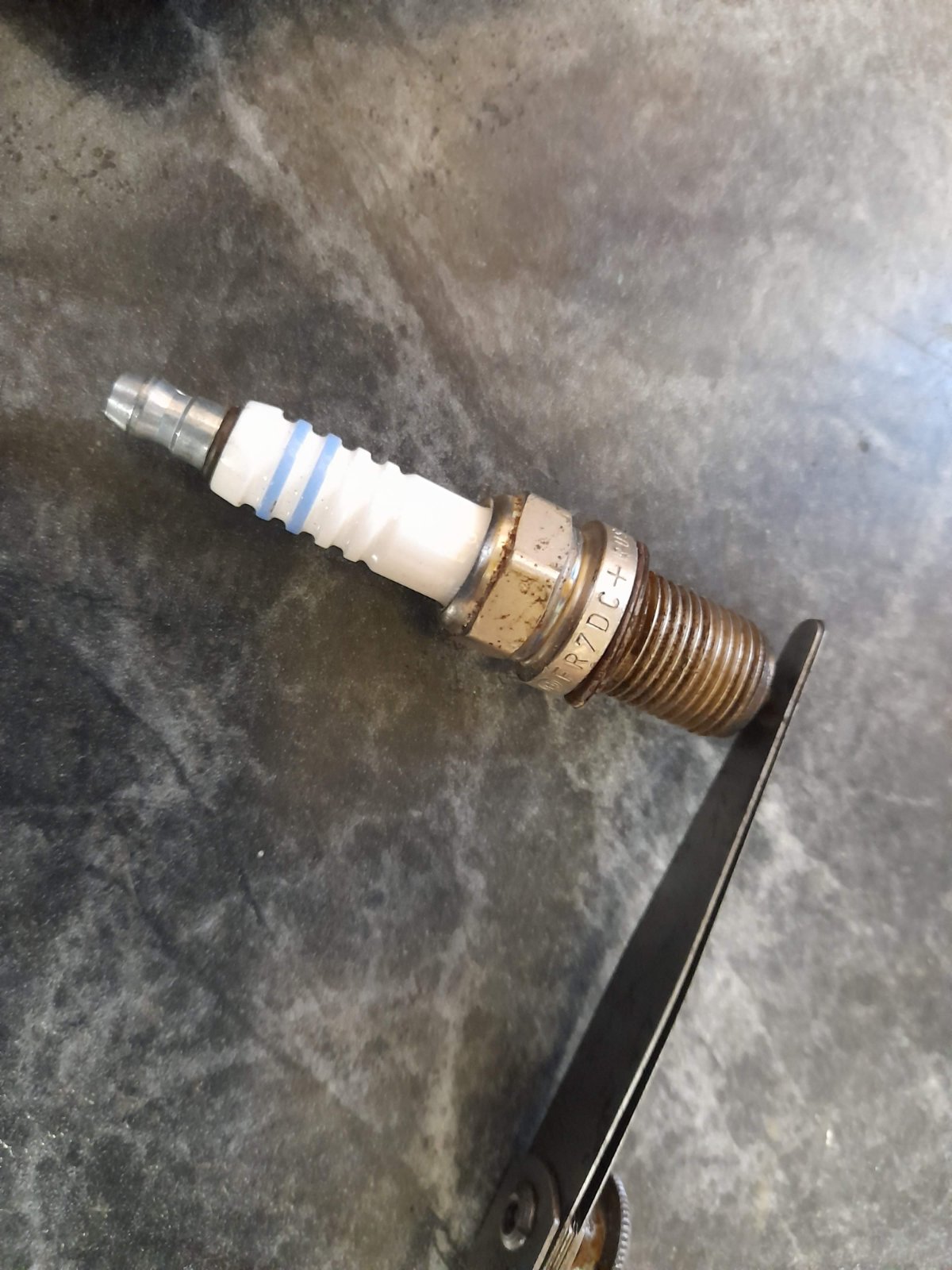

And then a check of the plugs and their gaps... All correct...
That's the first time I've used my feeler gauges in a while! Twice in the same day...
Then refilled with coolant and the system bled... Heater is roasting hot on full and I'm happy to see the cooling fan works properly...
Which is more than can be said for the heater blower... It only works on top speed so I need to check its resistor pack...
Always something to do on these old cars...
The engine sounds a lot, lot sweeter with a nice new and quiet cambelt tensioner
That's better

That water pump definitely looking tired, likely a good preemptive replacement on that front

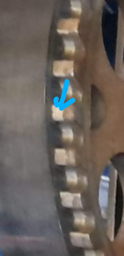

Does the old belt look to be running a little more off the pulley than the witness mark suggest it has run previously?

MattBLancs wrote: 10 Nov 2022, 20:25 Does the old belt look to be running a little more off the pulley than the witness mark suggest it has run previously?
Yes, it was Matt. It was right over to one side of the crank sprocket guide flanges after I temporarily replaced it a few weeks ago and stayed there and never centred itself... This time I was careful to get the belt in the middle of the crank sprocket...
The water pump was better than it looked... The one out of my Saxo looked much worse but yes, definitely up for replacement. Not keen to do it again any time soon!

I think, within reason (I e. Don't try belt only quarter of the way on the pulleys) that belt position is driven by one pulley in the system - normally crankshaft. Having a hard edge in both sides, hence all others running in a position following this guide. Belt running off slightly could be a sign of something pulling the belt out of line after the crank pulley - e.g. taken to extremes to aid the illustration: if water pump or an idler is imagined to be either bent, misaligned, etc then it'll affect belt position of following pulleys.
Or put it another way, a reason to be happy it's now on new belt, pulleys, pump

I'll be checking again before the car fully enters service Matt but having said that, I could find no significant play in the tensioner and water pump bearings although the tensioner was very noisy and rough so under pressure it may have been introducing just enough play to pull the belt off line...
I'll advise when rechecked... At least I have photos of when it was when first installed
