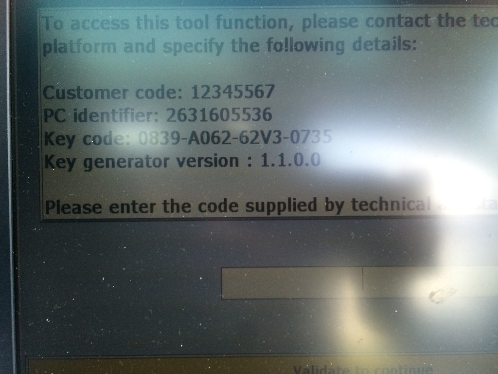

I have been fighting with Diagbox/Lexia/Peugeot Planet all week. I can get my C4 to connect, the vin is correct & it will check every ecu. I haven't been able to find what the fault codes stored are as after it read the log, it said "fault log empty".
However the problem I want to sort out first is it won't let me change anything. On my C4 the directional headlights had been unplugged and need to be enabled to work. I found the screen to change them but got this screen
I tried the code 03114 and it said "warning incorrect code"
Today I connected to my daughter's Peugeot 207 to enable the CD changer and again found the correct place but got the exact same message as above. I tried 12345 and various other numbers, but no good. Anyone know what the "code supplied by technical assistance" should be?
