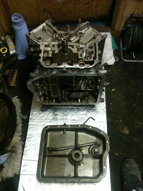

Today was almost a whole day of tinkering, i really need to clean the shed out now as i need a clean clear space because things are getting dangerously close to needing to go back together or painting!

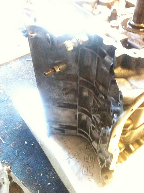

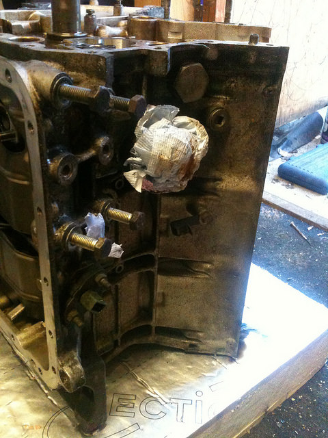

heavy oxidation and oil buildup removed, cooling system scraped out and flushed and that really needed doing, the feed pipe into the rear bank was completely blocked with corrosion and mineral looking deposits
Imagephoto(80) by Deanxm, on Flickr
Imagephoto(82) by Deanxm, on Flickr

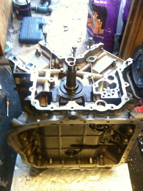

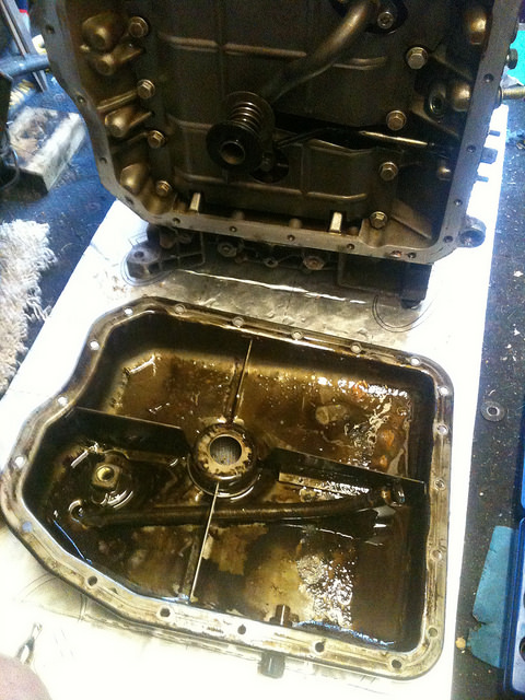

The sump baffle was removed and the crank case cleaned out, the baffle was held in with 1/2" bolts, obviously, with it being designed and made in europe, for european manufacturers and containing nothing but metric fasteners!?!?. Didnt take a photo of that though as i was busy.
Imagephoto(79) by Deanxm, on Flickr
Oil pickup back on with new seals
Imagephoto(81) by Deanxm, on Flickr
All clean and ready to go back together, the sump has been off at some point and re-sealed but there is no gasket and looking at the sump mating surface i thought there should be one but i have been told its gasket goo only
Imagephoto(83) by Deanxm, on Flickr
Coming along anyway.
D

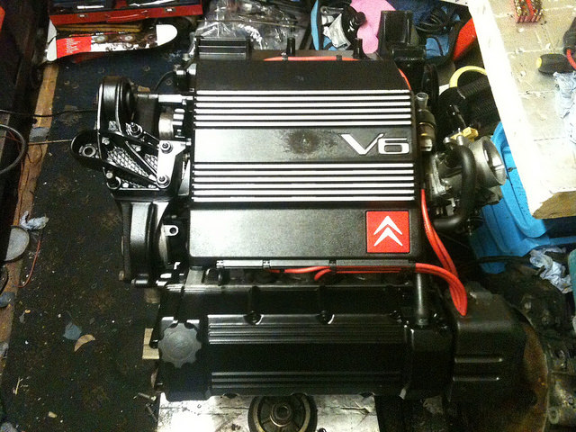

1,2 skip a few, lap the valves, 100!
Imagephoto(96) by Deanxm, on Flickr
OK so there are a few bis to do, front rocker cover to be sealed and bolted on but im waiting for the bolts, needs hose clips on the hoses and i want to pressure test the cooling system to make sure there are no coolant leaks but its as near as damit done.

Interesting it has a baffled sump
