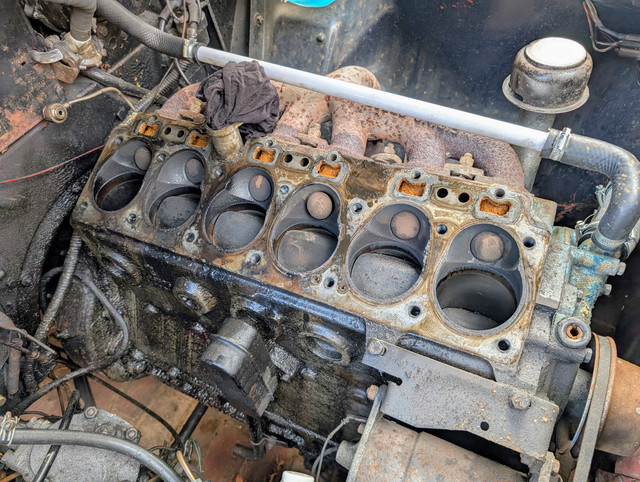

Heard back from Headline MK today. The Rover's head has been pressure tested as good and the valves have been vacuum tested which shows them to be seating perfectly.
They were a bit concerned about some of the pitting around the water ways so I've dropped off a head gasket to help them get their bearings for bits which may or may not be an issue. If any welded repairs are needed before the lightest of light skims they will be made. We're on the same page of "Anything it needs it gets" but equally there's no need to make work where it's unnecessary.

They have carefully checked the head and are happy that none of the pitting in any way affects any of the sealing surfaces, so no welding required. It's passed all the tests thrown at it and just needed the lightest of light skims to clean and true it up.
Just need to collect it and get it refitted. Which at the rate I'm getting to things at the moment will probably be somewhere around summer 2029 it feels like.

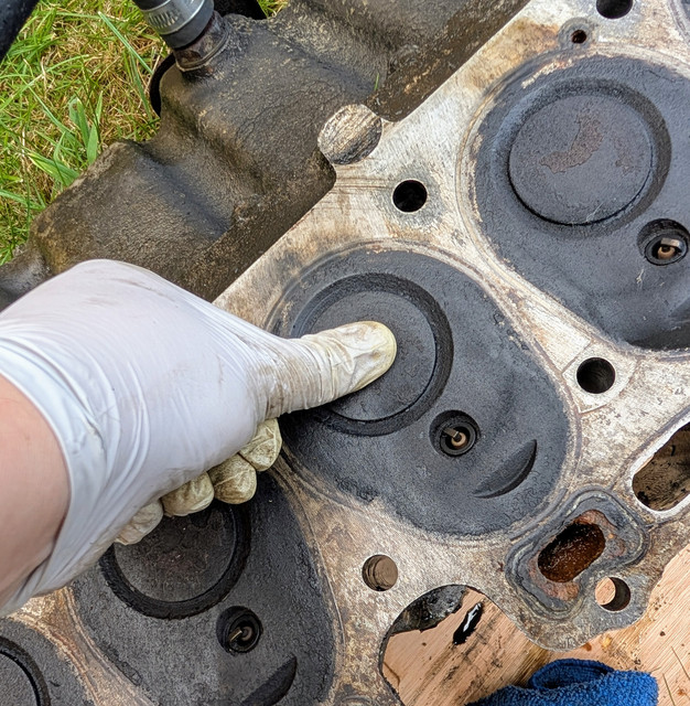

(it's been a long day!) took me a bit for my mind to clunk into place and
Spoiler: show
it's that Inlet Over Exhaust arrangement, t'others are in the block!
That "one valve per cylinder" view was boggling my brain!!

MattBLancs wrote: 11 Mar 2026, 18:39 (it's been a long day!) took me a bit for my mind to clunk into place and
Spoiler: show
:rofl2:
Well in your defence it IS a really odd engine.
There may only be one inlet valve per cylinder, but it ain't half big compared to what we're used to seeing these days.
Which of course was the whole reason for it - being a narrow bore, long stroke engine from the days when designs were looking for ways to beat the RAC Tax horsepower calculation meant that there wasn't much room for the valves in an OHV arrangement. Rover took this far further than pretty much any other company as far as I'm aware. Most IoE designs are heavily compromised with long flame paths from the plug and poorly shaped combustion chambers. Both issues Rover designed out of this engine. Though the gas flow to the exhaust valve still ain't great and as I understand it was basically the biggest limitation on being able to take it further in terms of efficiency. From what I've read though there is a lot more can be got out of these engines though. Rover just really erred on the side of keeping it under stressed in the interests of reliability and refinement. All evidence suggests they did a damned good job of that as compared to most engine designs with their roots in the 30s they are pretty bulletproof old lumps.
Other situation you'd see a similarly odd valve situation would be a Detroit 2-stroke diesel. Though I think they had at least two valves in the head of each cylinder though - just that they're both exhaust valves! Higher performance arrangements used four per cylinder, again all exhaust. Intake being handled via ports in the cylinder wall near the bottom of the stroke.
