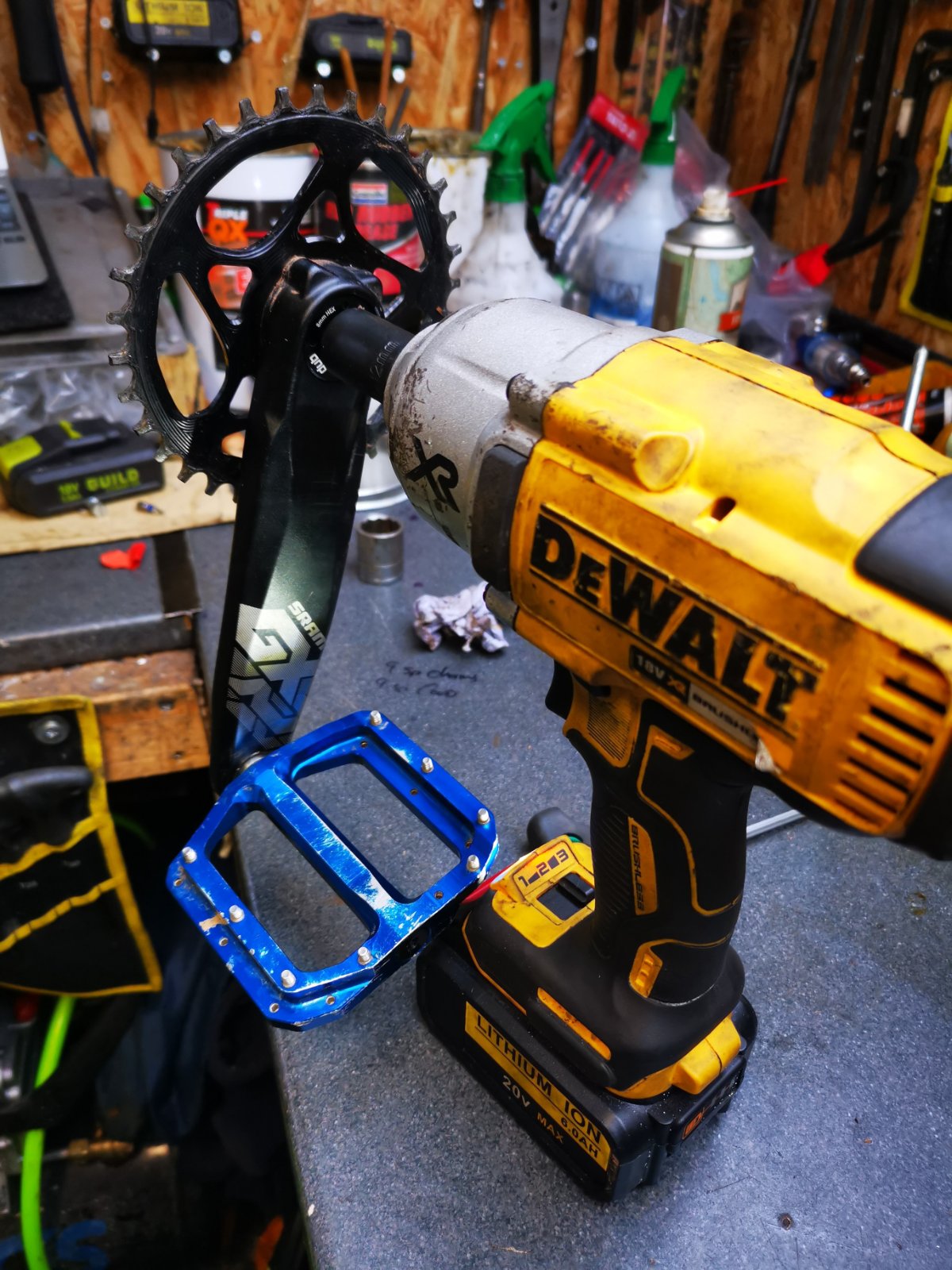

Can't think why it was so tight, no locktite or corrosion and once cracked it came out loose.

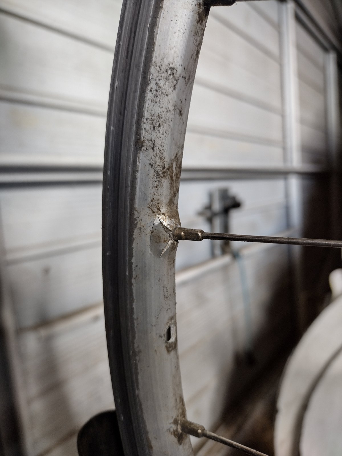

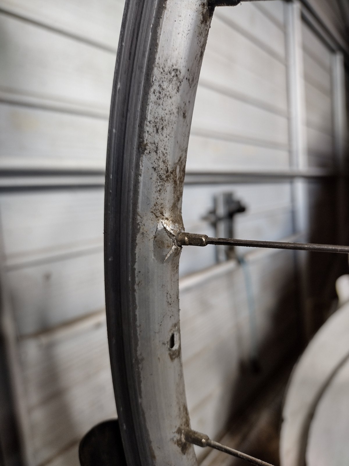

Definite fail today...😮
Oops...

Someone at the factory has been working out :shock:

Snapped a couple of T10 bits and 'Pro quality' shop tools on bleed screws, some are Rediculously tight! Only need a couple NM's on them,
Mind you, Sram crank bolts are the best for tightness! Had a couple that have required the non drive arm in the stand clamp and All of my 1/2" extension bars joined up on the 8mm Allen bit to get it to go, one took me (110kg) fully off the floor on before it Cracked loose, annoyingly almost instantly becomes finger tight! Not many defeat this mind, but some doo...

Timmo wrote: 24 Feb 2022, 15:36 ........... fully off the floor on before it Cracked loose, annoyingly almost instantly becomes finger tight!
Usually down to Loctite or similar having been used in the assembly in my experience! :)

No loctite on these! Been in and out many times! Something about them makes them self tighten to rediculous levels! Pivot bolts on suspension normally warmed up with the hot air gun before undoing, always clean them and a small dab of thread lock on them when rebuilding frames,

Looks pretty extreme!
New wheel fitted, nice and smooth. Only lasted 10k before I got a puncture, the ham fisted mechanic changing over the tyre nipped the tube somewhere (must have stern words with myself!), not sure why it took that time to show up!?!
