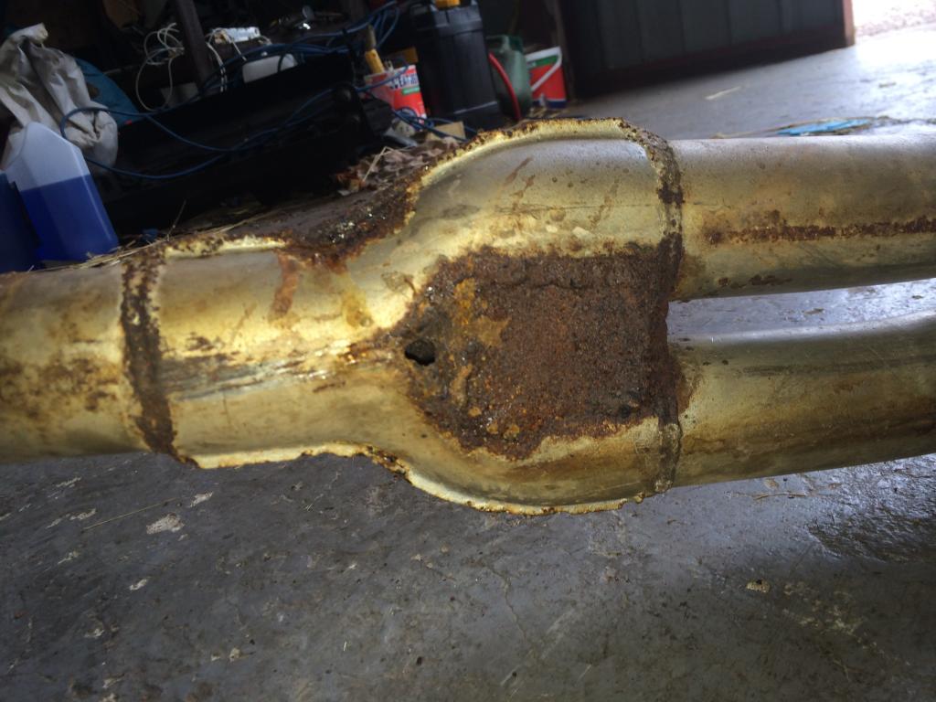

I took the exhaust off the XM tonight so that I can get it patched up in preparation for it's MOT on Monday morning. Here's the little hole that I knew about...
Just behind the patch that I put on it 3 years ago when I first got the car.

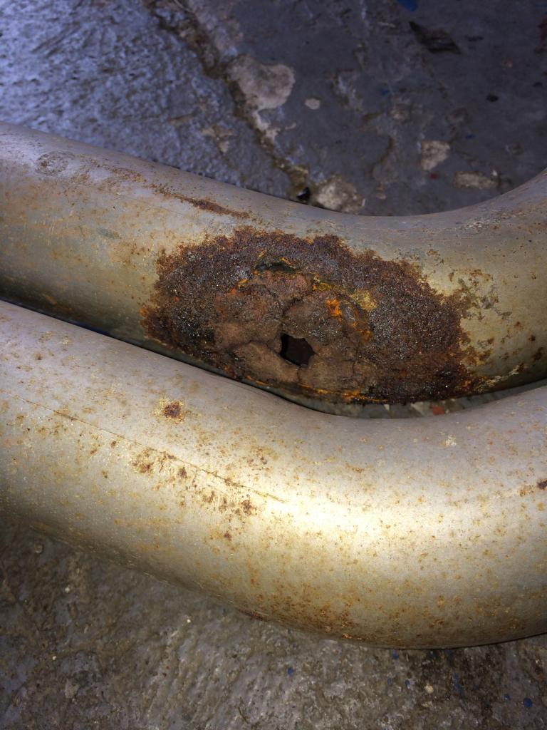

I then had a quick look down the rest of the pipework and found this little bugger...
Hopefully should be able to shape a patch round it easily enough.

Wonder why they didn't use stainless piping and make a new stainless 'Y' when they replaced the silencers David?
Yours has gone on all the known weak spots were moisture collects...
All the best for the fix and good luck with the MOT on Monday :)

Well I'm pleased to announce that after a about an hour in the garage, tidying up around the hole, cutting a little patch and welding it on last night the XM has passed it's MOT without even an advisory.
I've never had to do anything other then change the windscreen washer pump on this car in the 4 years I've had it. Am going to look into having a complete stainless exhaust system made up for it before next years MOT is due though.
Anyway, I'm a happy chappy today :) My 100% first time pass rate for 2014 is still intact. Now to stick some tax on it and give the ole girl a little use over the summer.

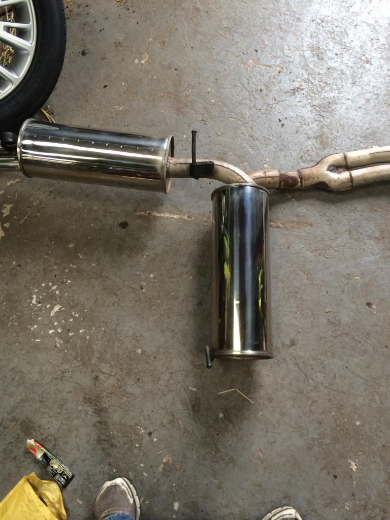

I've been considering one for a while. Do you think that the sound would be the same as with the original Citroen one?
1985 2cv
2000 Xantia V6
DHallworth
Posts: 2437
Joined: 20 Nov 2005, 17:05
x 162
Re: David Hallworth's Blog aka All Things V6!
Unread post by DHallworth »
I've asked for it to be as near to OEM as possible.
Apparently there's a chance it might make a slightly different tone due to the characteristics of stainless steel versus mild steel.
You can however ask them for it to be quietened down using different materials in the boxes.
I was quoted £540 including VAT from C&C Exhausts in Hillington today. Citroen want £545 for the centre section and £291 for the back box!
No brainer for guessing which one I'll be going for!
David.
